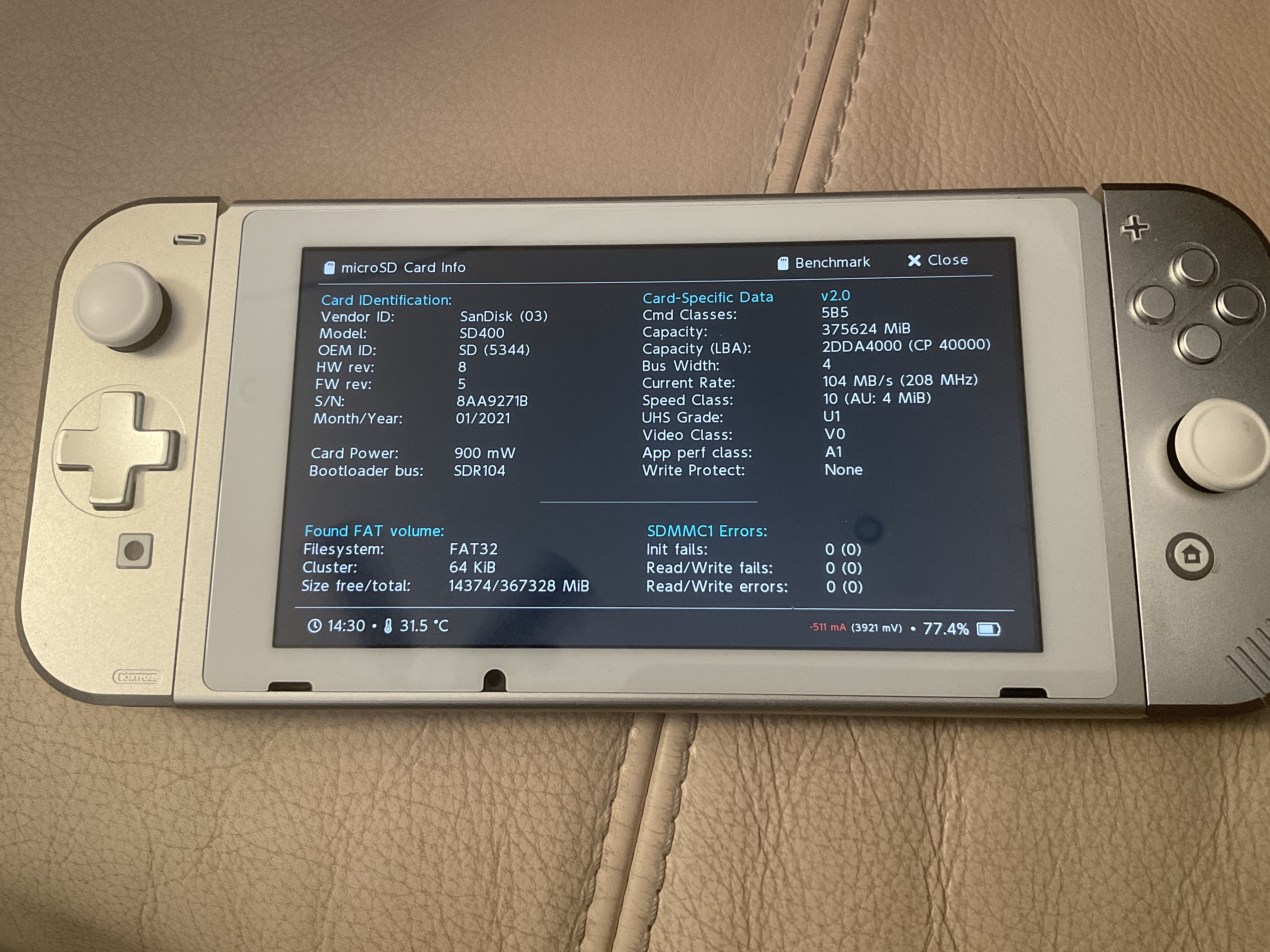

Which SDCard reader did you buy? Just curious.
How are you formatting your SDCard? FAT32 or exfat?
That SDCard reader appears to be good.
FAT32 is perfect.

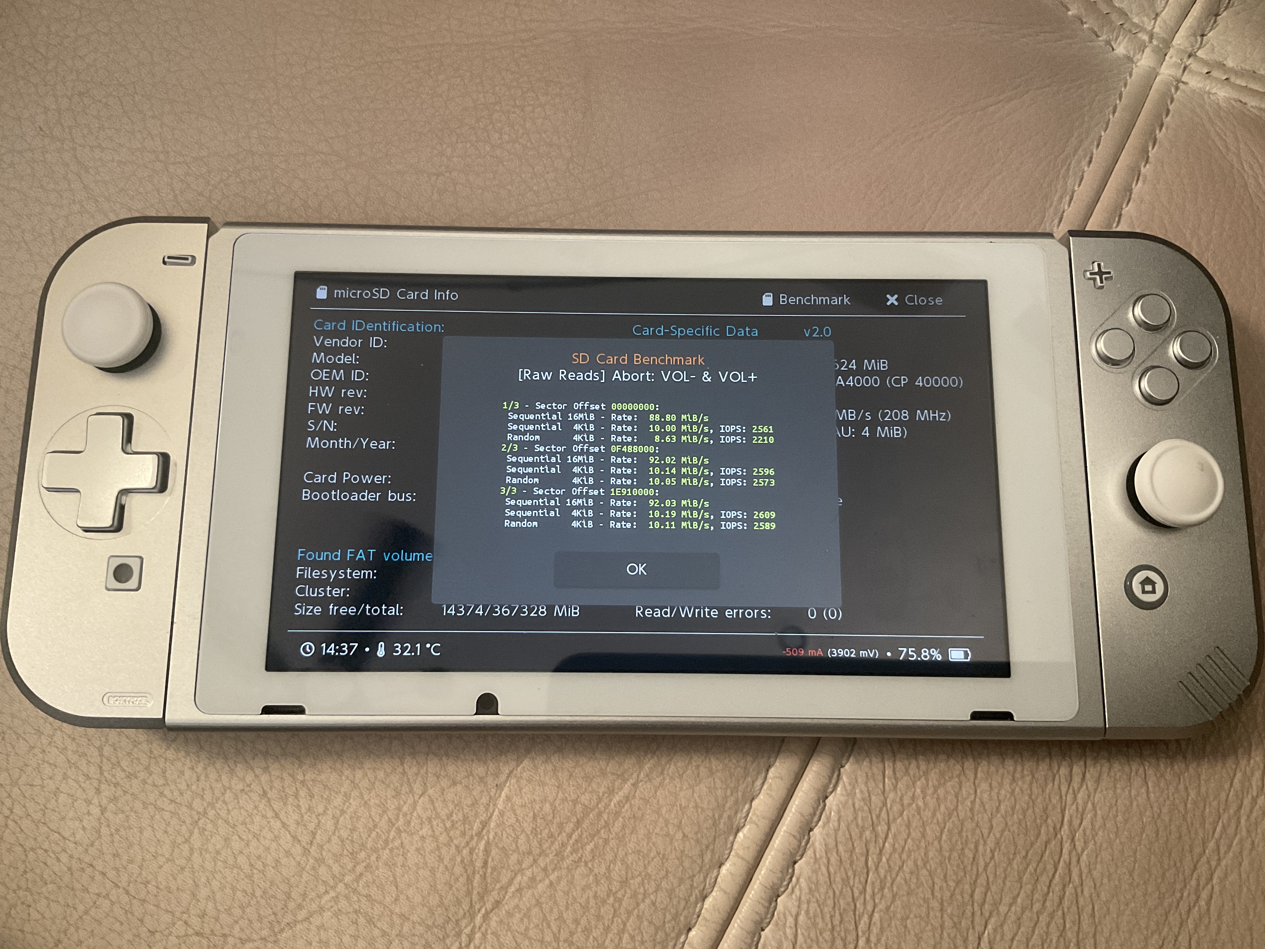

Please go to Hakate -> Console Info -> micro SD
Allow it to finish acquiring FAT volume information and then take a screenshot:
Then do a Benchmark and take another screenshot:
I typically get 90/10/10 MiB/s (+/- 10%)
Thanks for reply, here the screenshots
