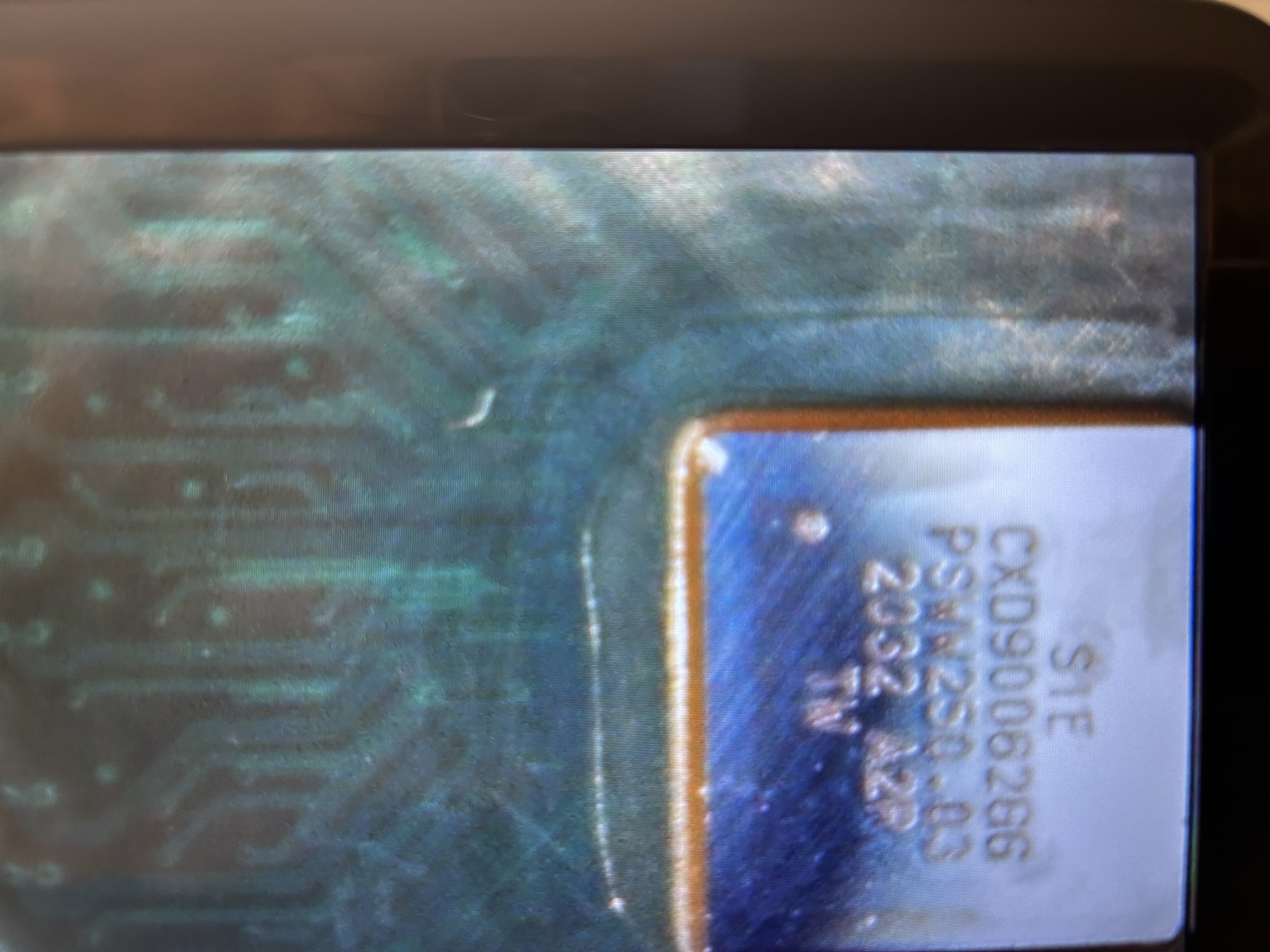

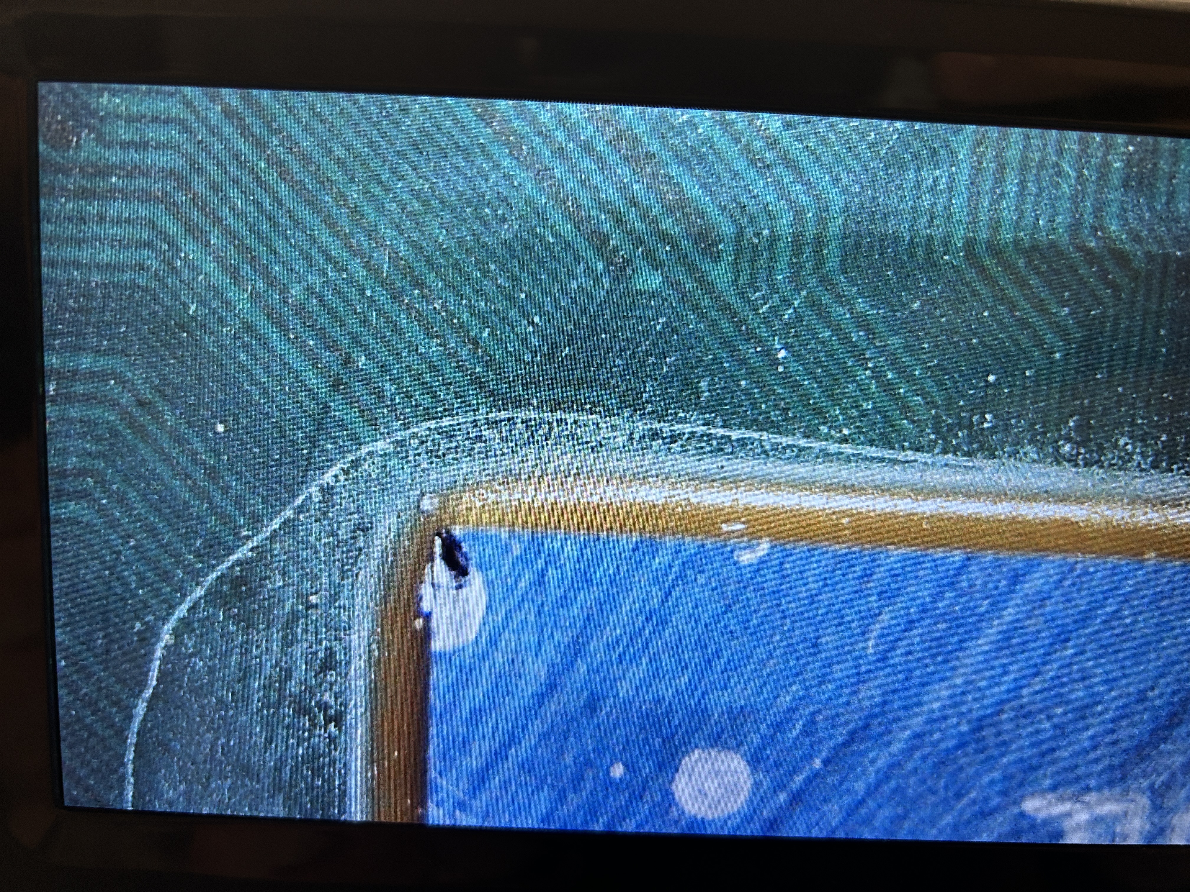

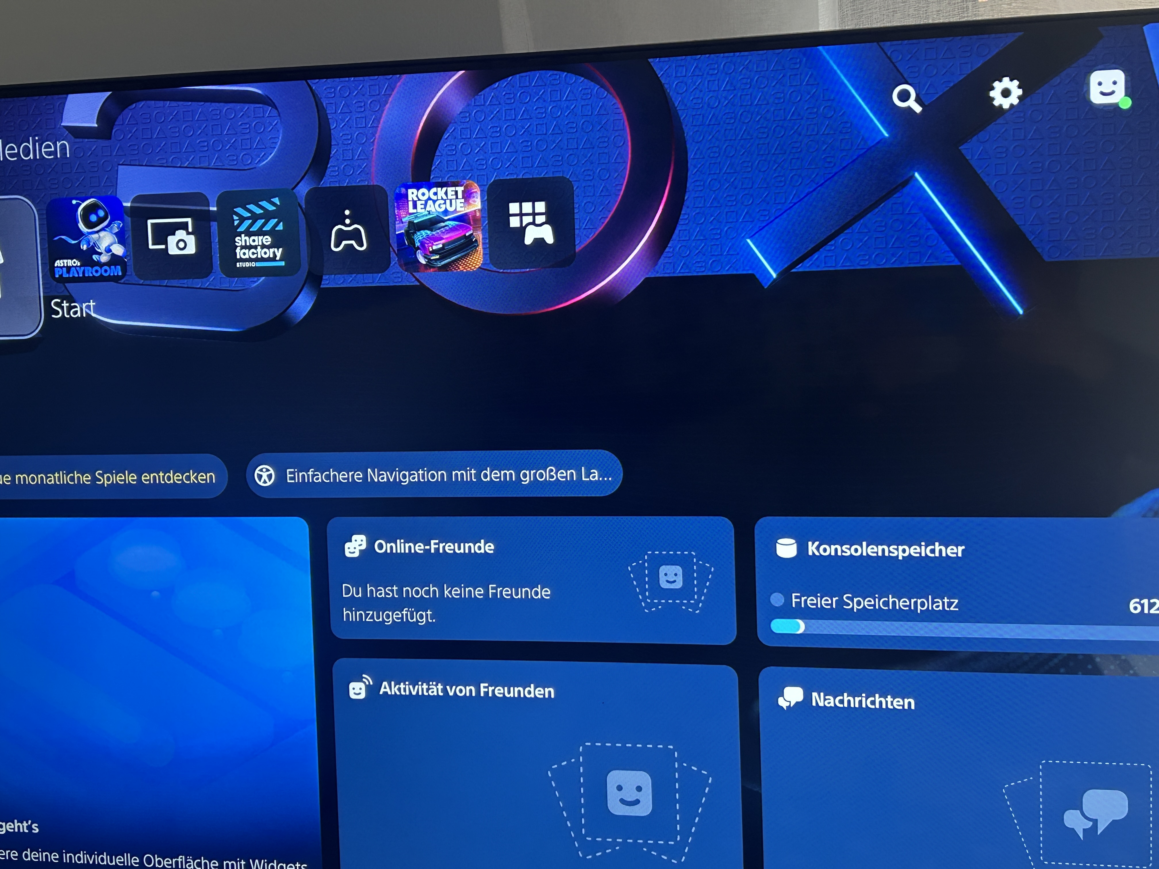

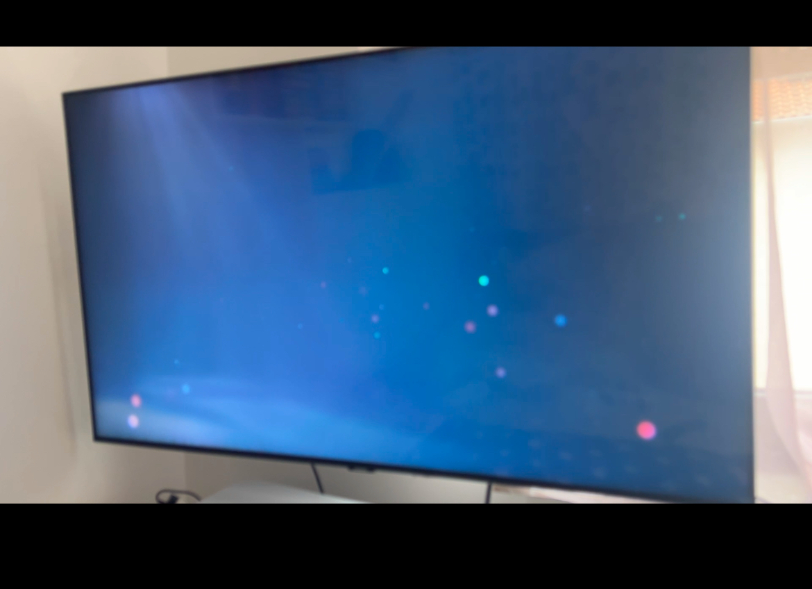

The ps5 needs between 30 seconds and 2 minutes to start up. (Freeze+Reboot)From sleep mode it starts immediately. Anyone know what could be wrong. no problem when playing
Uart Code: C0020303

The fact that you are getting random crashes and long bootup times it sounds like there may be an issue with the system's SSD.

Then it is most likely the SSD. Safe mode is run off the system nand.
completely new or reballing?
You're right. both errors there.
Tomorrow I will delete the errors and report back. are you also thinking about the SSD-IC?
Games crash! CE-108255-1
can this spread problems?
