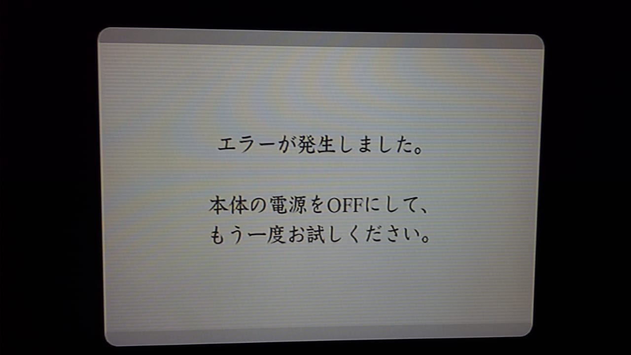

I tried countless times, all to no avail!
There was an error!
Turn off the power to the main unit.
Try again later.
It always gives this error ...
The last time I tried this error also appeared to me.
It is not a disk error, as I installed it on Dolphin using the CD / DVD player.
I think I don't have the modchip but DARKCORP, as a result it reads slower discs and with less energy needed.
I think that was it!
There was an error!
Try again later.
I am sorry to read from your unsuccessful Attempt...:(
Do I understand it correct,you do not have a Modchip ?
As you already suspect,without I do not think it works.
I am very sorry for you....:(
