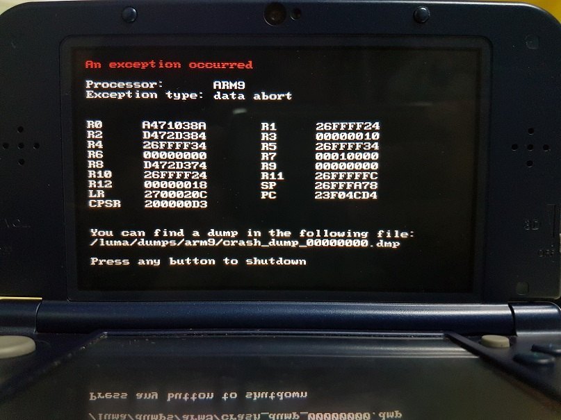

I don't know whats wrong.. sysNAND still works but emuNAND after downgrading to Dev FW show this
N3ds/Luma3DS/sysNAND FW11/EUR console/region changed emuNAND to US/
anyway this was in a secondary SD card, I'll keep it for some time if there is a solution
I just tried to install the dev firmware onto my emunand, following the instructions very carefully. When sysupdater finished I rebooted to the same error, however I also got the error when trying to boot to sysnand. Im on n3ds XL a9lh and my sysnand is 11.0. Im restoring my backup with a hardmod and Ill try again but if anyone knows why it went wrong... My nands were unlinked so I dont know why my sysnand was touched.
Anyone who installed it on New 3DS WITH succes? Tried it with latest version of Luma3DS, seems still not to work.
