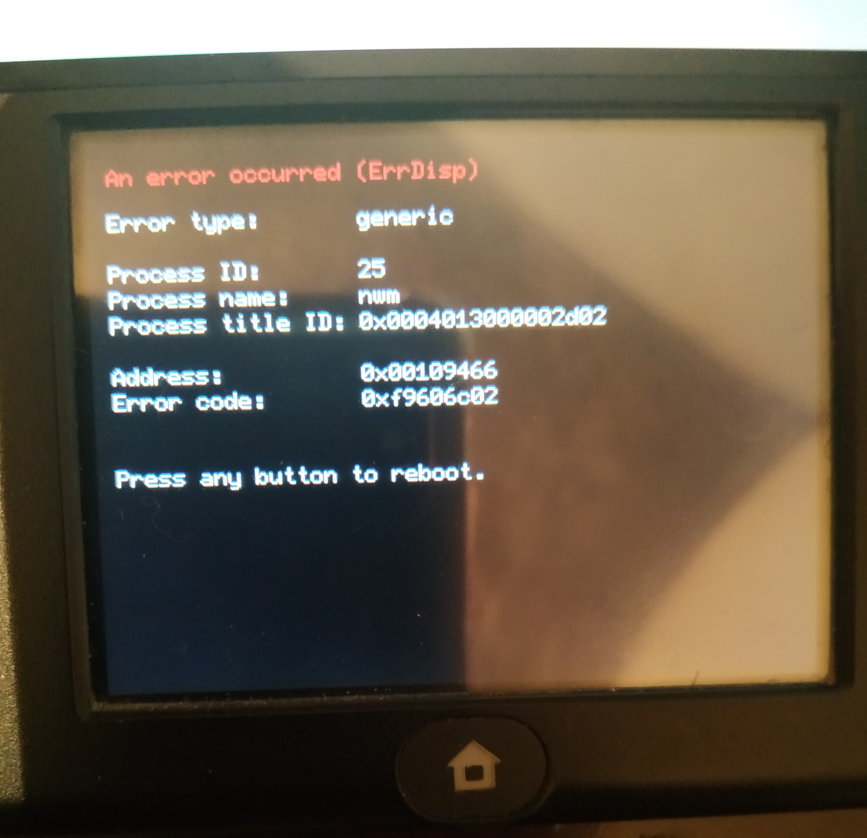

like, everytime i try to open a game or homebrew i always get this error. idk what to do.
ok here are specifications.
i have a: old 2ds, i'm running 11.6, luma's is updated to 9.0,
an error occurred (errdisp)
error type: generic
process id: 25
process name:nwm
process title id: 0x0004013000002d02
adress: 0x00109466
error code: 0xf9606c02
press any button to reboot

well okay, i tried switching off the wifi and i'm still getting the same error.

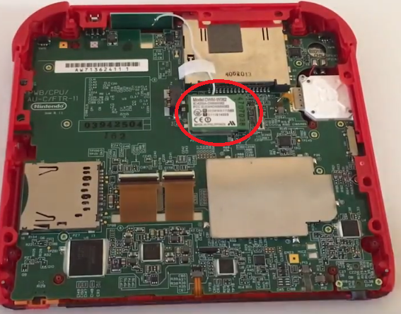

Hello!! I have an old Nintendo 2ds, and I had the same problem ...

I solved this problem as follows: I disassembled the 2DS, and realized that the WIFI circuit was a card that could be removed. I removed the plate and cleaned the contacts using isopropyl alcohol and a brush. I brushed the brush slowly on both contacts. After mounting 2ds I was able to turn on the WIFI normally. I hope I helped someone who has this problem, because I rewritten NAND, formatted 2ds and it did not resolve, which indicated that it was a problem in some component and not in the system, since I had tried the solutions to a problem in the system.

I have the exact same problem with my 2ds
Error type: generic
Process ID: 25
Process name: nvm
Process title ID: 0x0004013000002d02
Address: 0x00109466
Error code: 0xf9606c02
Press any button to reboot.
I can can only go on it for 10 seconds before it says the error I sent all the apps are working i just can't go on it for more than 10 seconds
I turned the WiFi off and it hasn’t crashed. Is there a way I can reset the WiFi module so that the crashing doesn’t happen?
