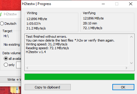

Also, i think you need to check the sd card for errors with h2testw as it might be faulty. Backup your data somewhere safe (on your pc), empty the sdcard, then run h2testw with the "read and verify" setting. It should tell you if it is faulty.
Ok I'm gonna try that

done, yeah probably its the Sd card reader at this point i tried everything, i`m going to buy a new one but they are hard to find, theres only for the New nintendo xl
