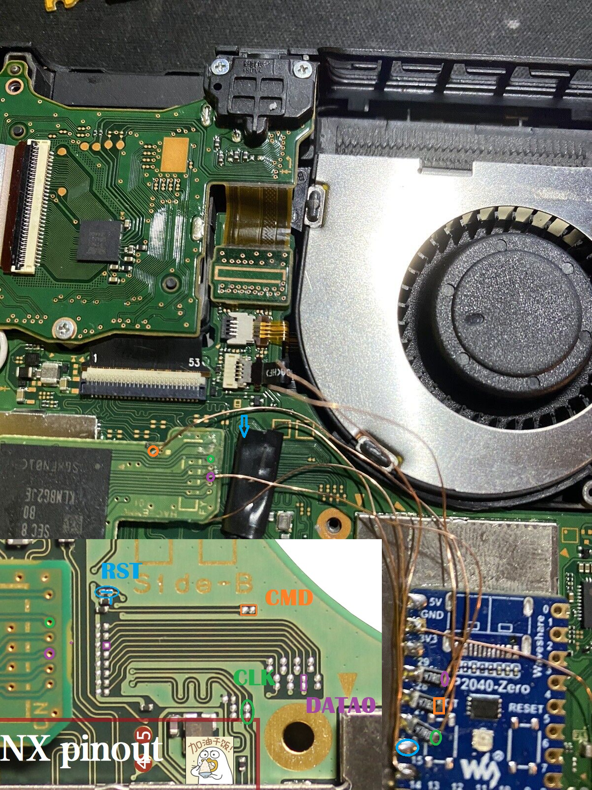

i got a modded switch from ebay a few months ago and it came with a bad fan and battery, it constantly overheated and dead extremely fast so i bought a battery and fan it replace them. when i replaced the fan and battery everything went smooth till i went to turn my switch back on and realized that it started in stock form. so i opened it back up and noticed two of the wires for the chip had broken off of the board on the switch. i tried contacting the original seller about it and got no reply. i can get a soldering iron and know how to use it but i dont know or can find any info on google or anywhere i've asked on help on how to fix it . id greatly appreciate any help pointing me in the right direction on where the wires need to be soldered. the two wires in question are the two in the picture that are out of focus

the data0 and CMD ones are connected the CLK is definitely one not too sure of the other but it was soldered close to the CLK
