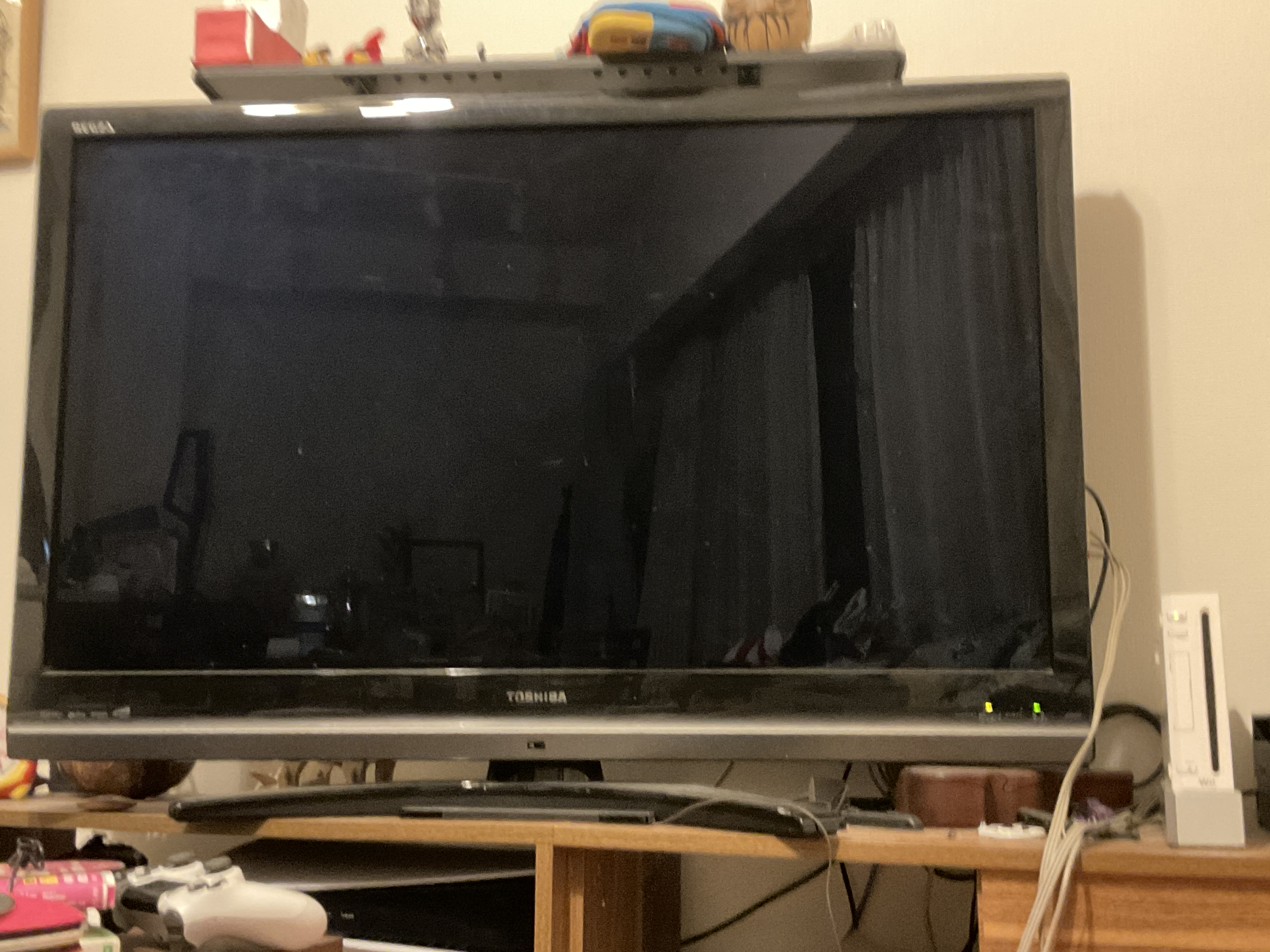

PLEASE HELP! I bricked my Wii! I tried to install the startup disc menu and it broke! I had priiloader installed, but it deleted it itself! (IT CANT BOOT TO PRIILOADER) so please help! I’m it’s near my birthday and I can’t show them gameplay! Pls help! I have absolutely no idea how to change the green boards! Help me!
(It boots up to a black screen) (the installed boot 1 prevents a boot 2 install)
(I did not use a pc….)
I cannot use bluebomb…..

The only method I can think of for repairing this is restoring a NAND image with a hardware flasher.
Installing another version of System Menu removes Priiloader. In addition to that the IOS for the pre-launch version that required this disc (which you probably do not have) is most likely stubbed → The "Insert Startup Disc" screen won't show.

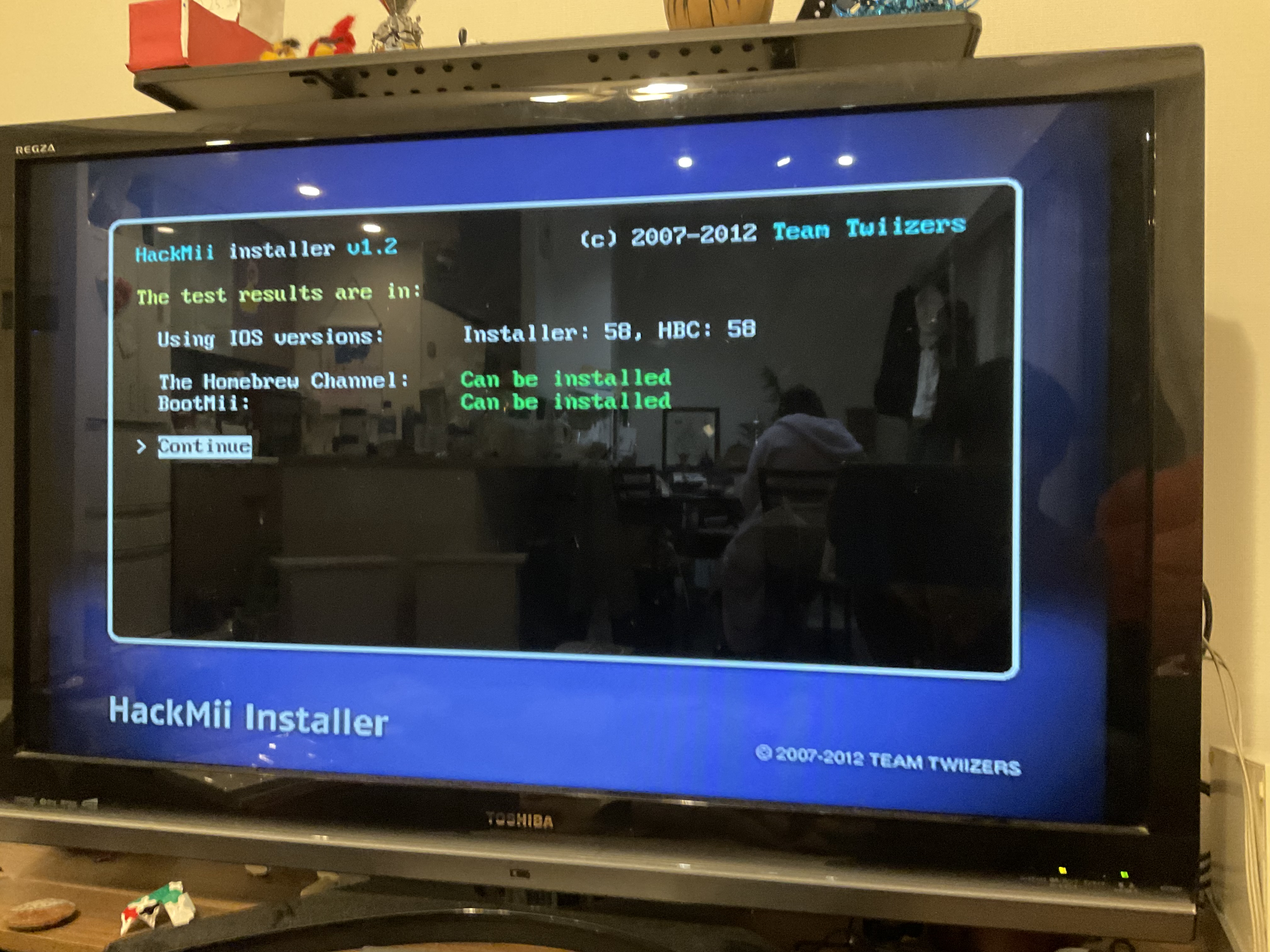

if you install the menu wad file!the priiloader maybe del,so you can use bootmii sd card file to try if the bootmii work!
This is a video I made several years back. It'll answer your question about SaveMiiFrii.
This one is part of the process of flashing the NAND with hardware.
Reactions: ISO-Man
I do not have bootmii as boot2. I already explained in the main post. (I said "the installed boot 1 prevents a boot 2 install")
