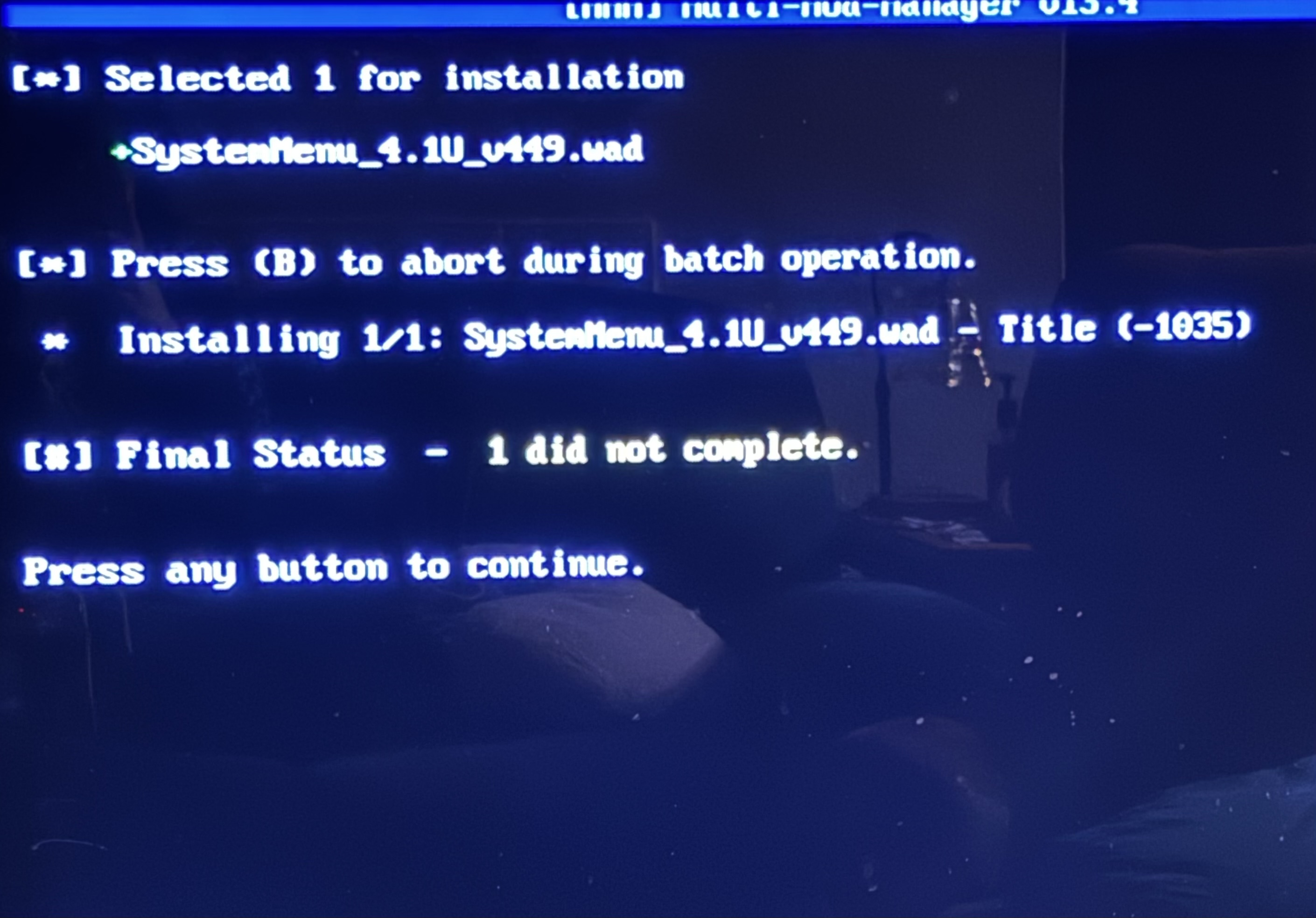

Hi, I’m new to using this site, and new to modding in general, so please tell me if I’m doing anything incorrectly.. I’ll start off by saying that I’ve bought this second hand and I’m pretty sure it was modded before I bought it because priiloader is already in the Wii and boots up when I press and hold reset. Anyways, I was following the guide and just going thru the motions to update the hacks and add them back on the Wii, but I got stuck on installing the priiloader because it gives me the “invalid/not vanilla” message. So I did a syscheck thru modmii and followed the guide it gave me, I installed the wads it told me to and tried to install priiloader again and it’s still giving me the same message. I have no idea what to do and I’m nervous about doing anything wrong. I was thinking about repeating the wads step again but I just don’t want to brick my Wii… the wii is 4.1U, idk if this matters or not. Please let me know if this step can be skipped or not to finish modding my Wii. I genuinely don’t know what to do and I don’t want to mess anything up. Thank you

It downloaded fine using modmii I assume, but you got some kind of error on the console. When did u get this error? During installation of the wad using yawmme? Have u tried again?

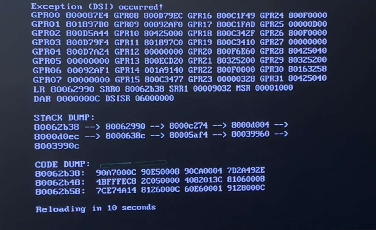

yes, ive tried again rn and it told me when it asks if i want to retain priiloader, that it couldn’t back it up, so i turned off the Wii and tried the process again. (This is the first time that’s happened all the other times i was able to retain and it just showed me the message) I was able to retain priiloader this time but it still gave me the same message I showed in the picture
I think then your only option is to try installing without retaining priiloader, then afterwards reinstall/update priiloader.
Assuming the wii doesn't have bootmii boot2, if it were me I'd use mmm to install this wad instead of yawmme just in case. While I hope yawmme wouldn't crash when u opt not to retain priiloader, I'm not sure what's causing the crash and so you might not want to risk it.
So grab multi mod manager (mmm) from Modmii's download page 2 and use that to install the system menu then reinstall the latest priiloader. Note that mmm does not support wiimote plus remotes, so hopefully u have an older wiimote, or a gamecube controller or something (I don't recall if it supports keyboards)
quick question sorry, to install the system menu, I go to wad manager? Or manage system menu? And then to install the latest priiloader I do it thru the homebrew menu? Or do I also do it thru mmm? (Manage priiloader) I’m so sorry for all the questions I really just want to make sure I’m doing it correctly, thank you
In mmm's wad manager just install the system menu wad we were talking about, then return to the homebrew channel, and launch the priiloader installer and install it. Once u start, best not to exit homebrew or turn off the console until u install priiloader again (as it will be removed once u install a new system menu with mmm), just to be as safe as possible
You may need to first load a different ios in mmm, like 249. Iirc it's near the bottom of the main menu list. After reloading to a cios you should be able to install it
