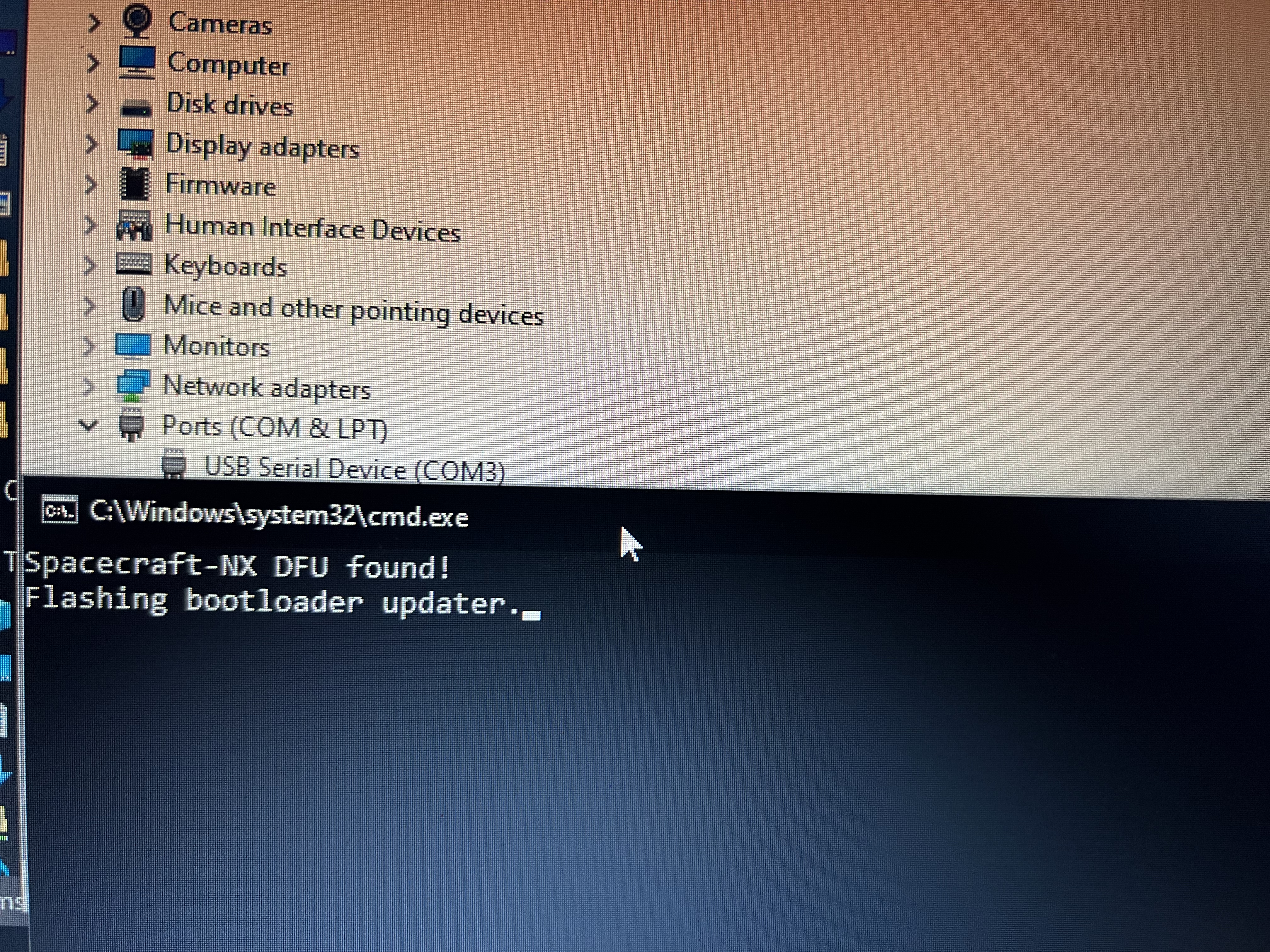

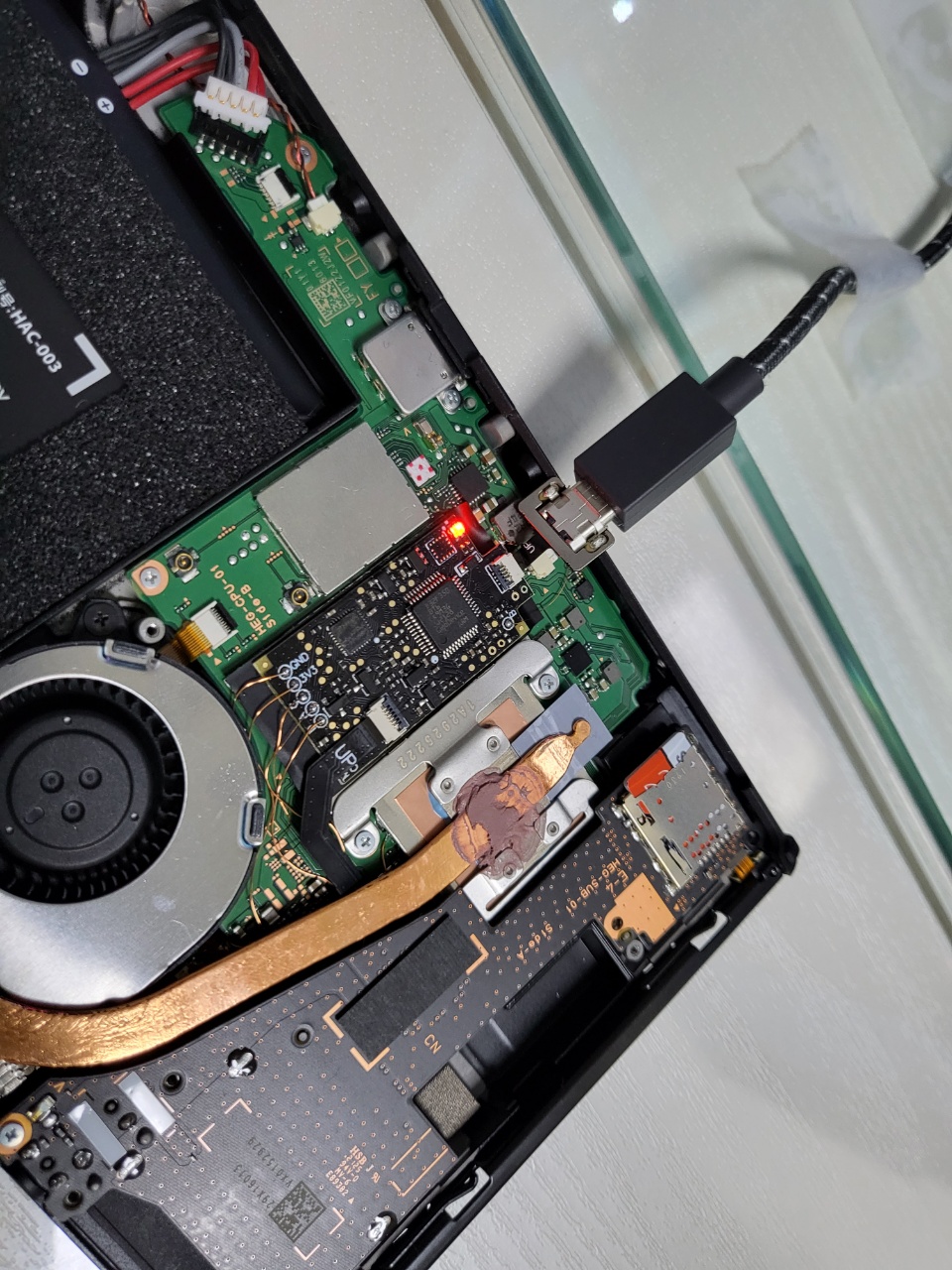

I always turn on the RED LED, but how can I turn on the YELLOW LED?The same results for cable inspection and my other PC.... (Of course, flash is impossible.) Soldering is OK, and booting also fine.

Apparently, there are some that do this and need SWD to flash them.
