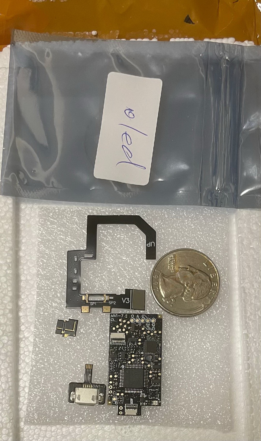

Yay! Got my v3 chip in the mail today, along with 99.9% IPA. Now I need the rest of the stuff to arrive… like the 0.1mm enameled wire and thermal paste and solder mask and stuff. So I can’t dig into the installation yet. This sucker is so tiny! Glad I asked the seller to get me the instruction page, because what you see here, is what you get. No instructions, or even a receipt in the box. No links to firmware or software. Confirmed it comes with the USB dongle though...

Wait… crap. So I ordered the wrong wire? Should work anyway. I Hope. But I guess I didn’t need solder mask. I need a grinding pen still, so I have to wait for that.
if you think that is tiny, wait until you have to scratch the console motherboard to expose point D and solder a wire on it. or another wire on the resistor right beside it ;)
the video shows another wire option. there's no right or wrong, this one has silicon instead of enamel. you can use any of them, as long as you know how to use them.
solder mask is not necessarily needed, but you can use it to fix a wire or protect a soldering point.
and you don't need a grinding pen. I scratched my pcb with a needle. carefully and slowly. it took 1 minute or 2.
