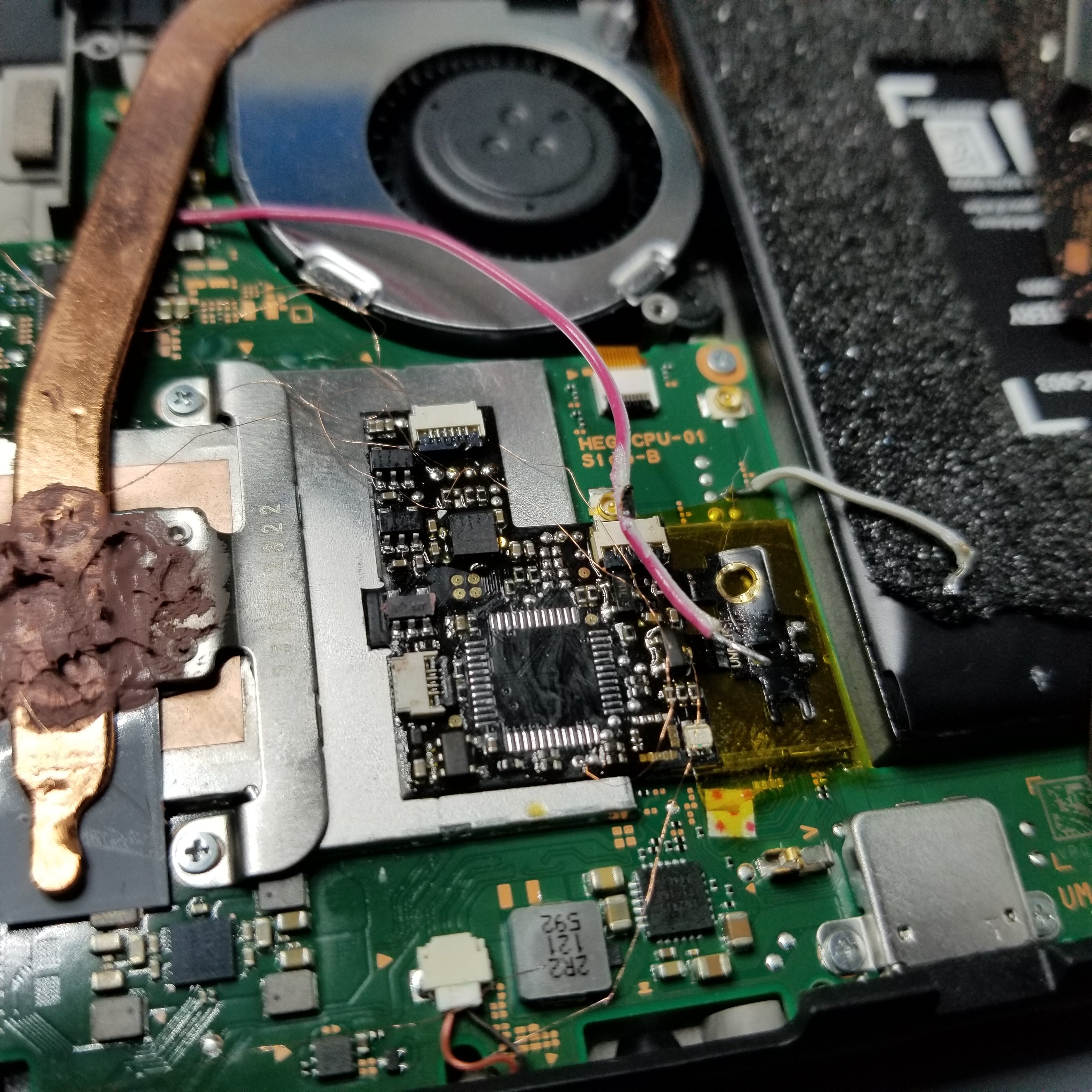

If it means anything to anyone, I took the GD32f350 off the new OLED chip and put it on the HWFLY lite clone....Nothing!
I get a light blue flash, then it boots stock. Guess it's time to swap em back!

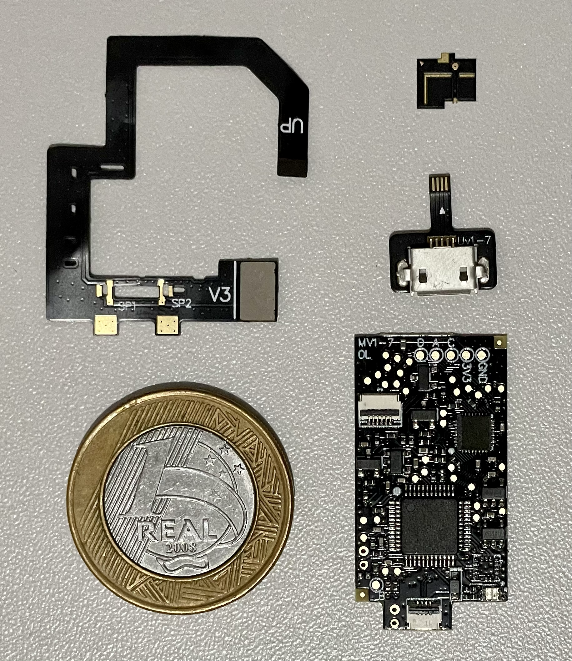

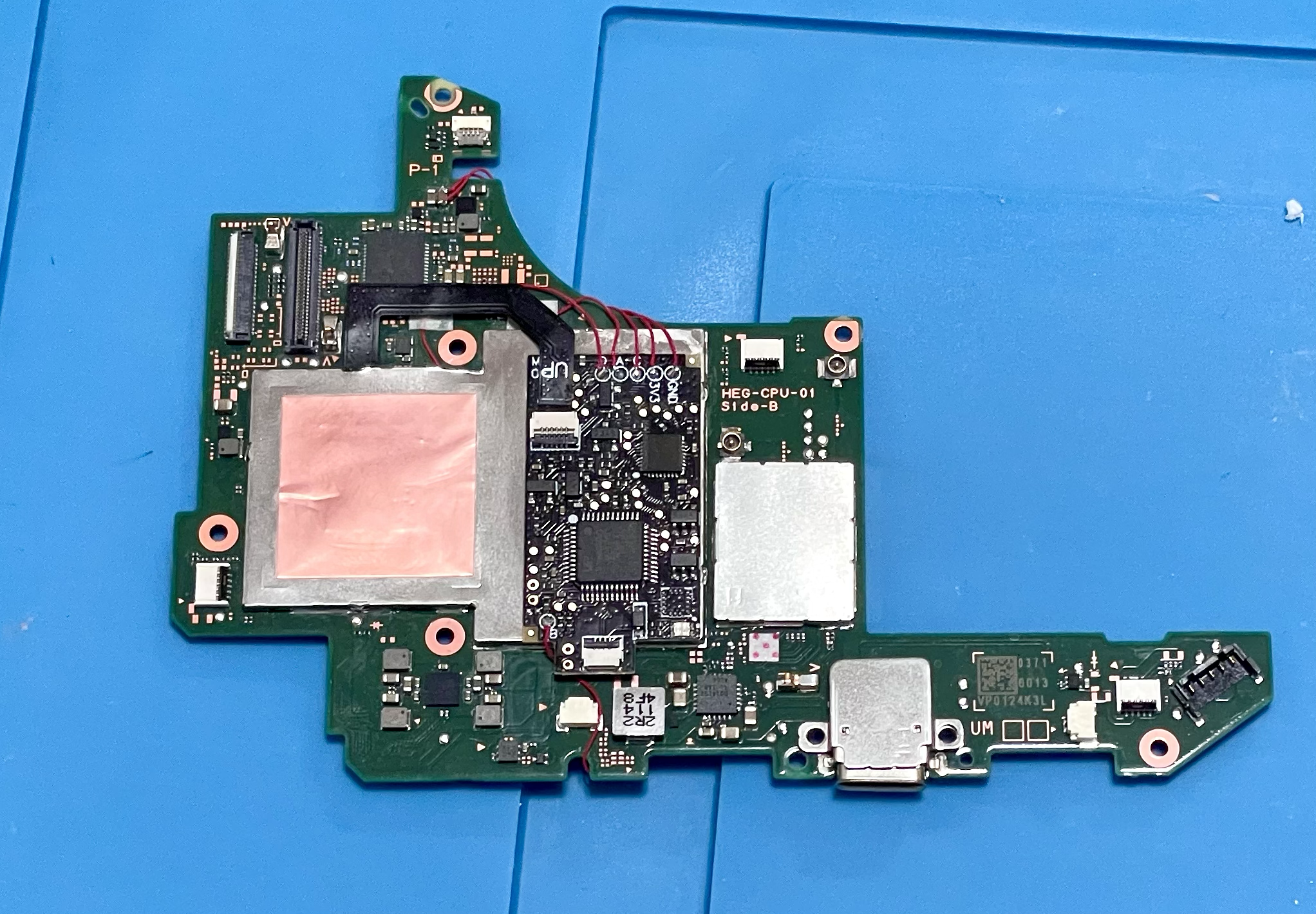

confirming that the OLED modchip with USB that I ordered on Jan 1st on Aliexpress came with spacecraft 0.2 from factory

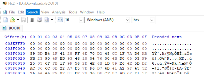

I have this new OLED specific chip installed and can confirm it has Spacecraft 2.0 on it. No USB debug port on this chip for 'easily' flashing firmware.

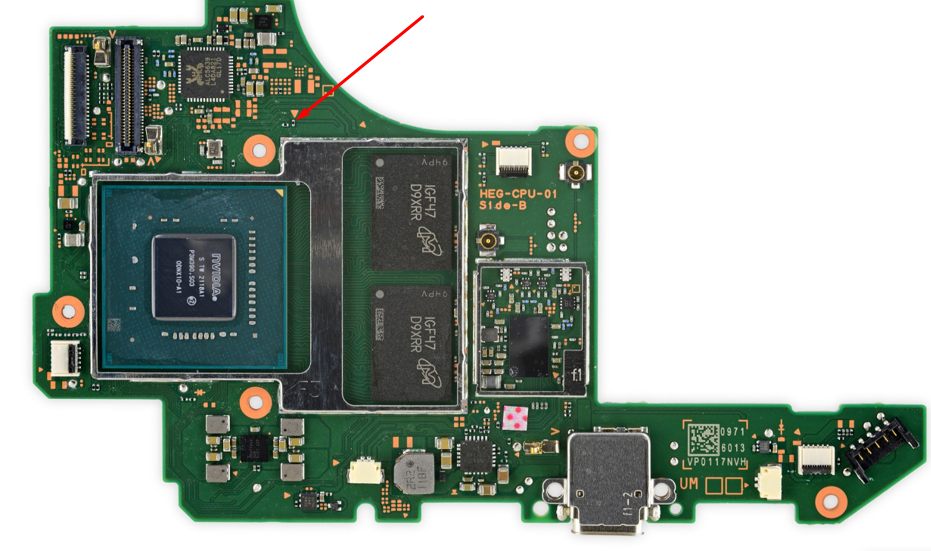

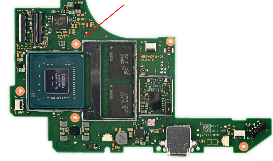

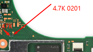

it's a resistor afaik it is 300ohm but please don't take my word for it, that points to the cmd and it's easy to messup causing your oled to purple screen
Thanks dowpuld you be able to post a link to where I can buy it. Also do you know if that chip had anything to do with the emmc. Since the got broken I’m getting and emmc error. And I can’t boot systems I’m stuck in hekate. I can’t even use emummc
