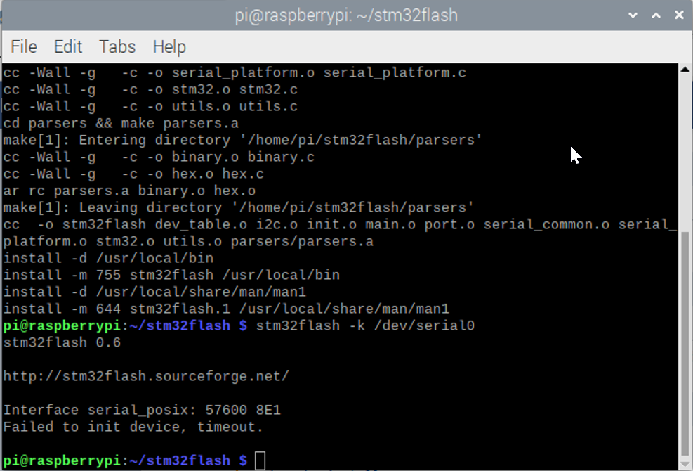

      git clone https://github.com/Pheeeeenom/stm32flash.git
      cd stm32flash
      sudo make install
  4. Now you will flash the modchip.
    Note: This will remove read protection, and the modchip will wipe itself (that is what we want).
    1. In the terminal, type the following command, and press enter:
      Bash:
      stm32flash -k /dev/serial0
    2. Now to flash Spacecraft-NX Version 0.2.0, type the following, and press enter:
      Bash:
      stm32flash -v -w ./FULL_CHIP_STOCK.bin /dev/serial0

I'm trying to flash the hwfly lite with RPI and it didn't work.
SWD connection using the GD-programmer / the ST-Link didnt work either. Yes I've lifted pin 44
FYI, as soon as we connect the chip to the RPI, the LED starts blinking purple, red, and off.
Correct!
I forgot mentioning this chip behavior but I have the same here as well!
