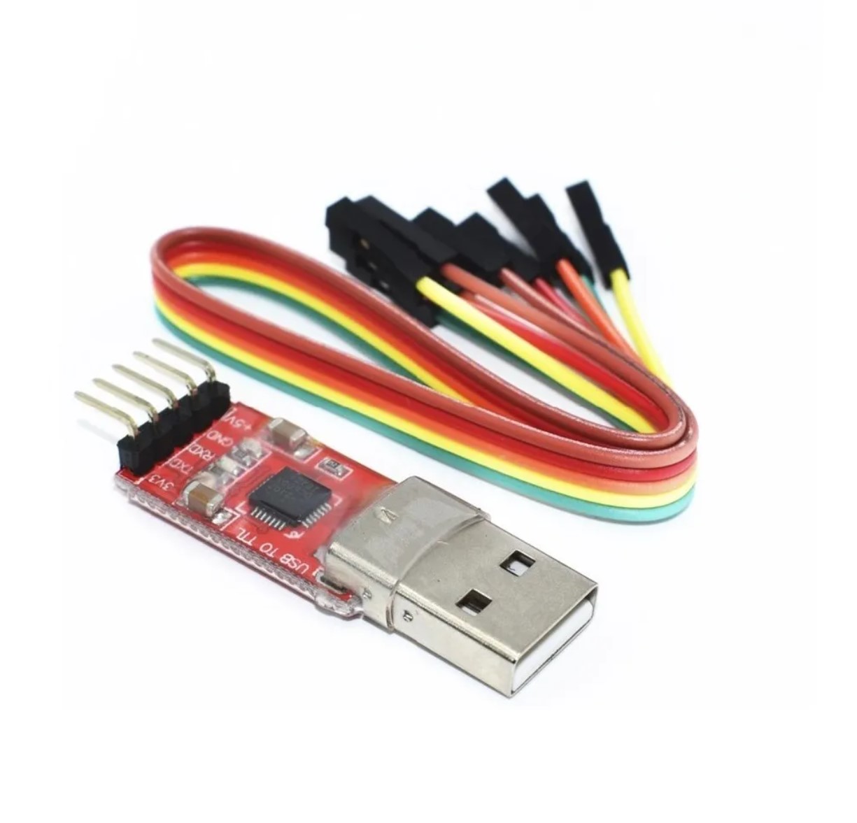

Hi @Mena , thanks for your help. Can i use a CP2102 USB to UART TTL485 232 Module Serial Converter Adapter?
