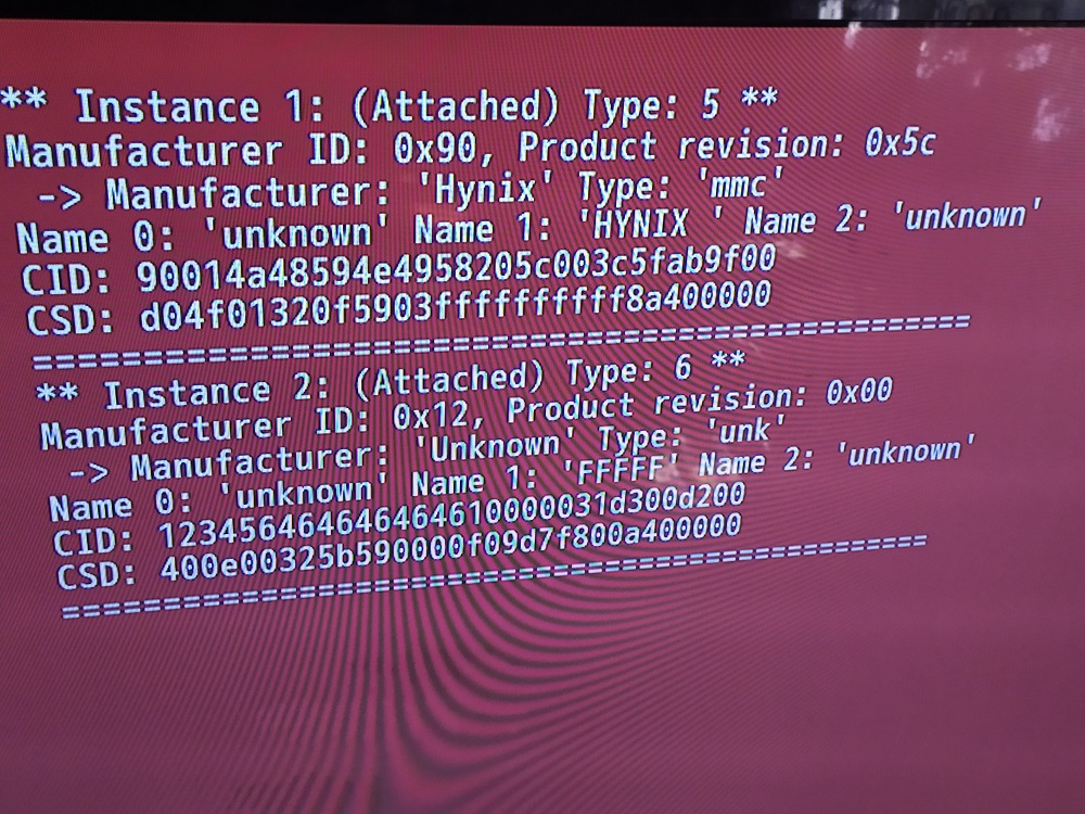

If you're interested in mdinfo results, my 32GB Wii U has a Hynix chip. Still works just fine, though.
Certainly.
September 2012 This is right in the suspected timeframe. Could you create a NAND Backup and check it with wfs-extract?

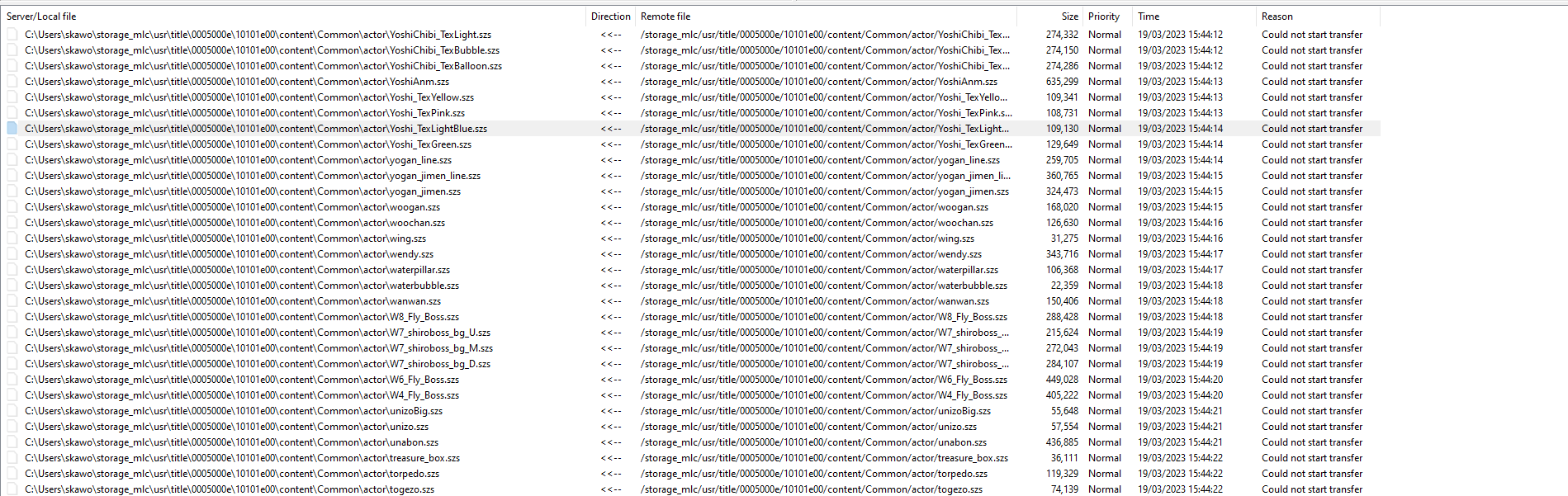

I am attempting to download just the slc and mlc at the moment. So far, no transfer errors.
Edit: SLC completed fine.
Edit2: I checked the SLC logs, and the only mentions of MEDIA ERROR are for the SD card. There are no corruption errors.
The MLC dumped, and the only errors were related to dumping files from what appears to be New Super Mario Bros. U update data.
/title/0005000e/10101e00
If I launch NSMBU, though, everything works fine, so that's bizzare. There is also no way that the update data actually contains all of these files, as, uh, it's only 79MB. The actor folder on its own should be 132MB...
EDIT: After further investigation and extracting this update locally on my computer, it seems that the files that fail to transfer are just packs of zeroes (unchanged?) in the update; all the files that do not fail from this folder have actual content in them. Maybe that's why it fails? But if so, then FTPiiU's not the perfect tool to be checking this with, as this seems like a false negative.
If the above is the case, which I suspect it is, then the MLC dumped fine. I will check this again when the SD card arrives.
