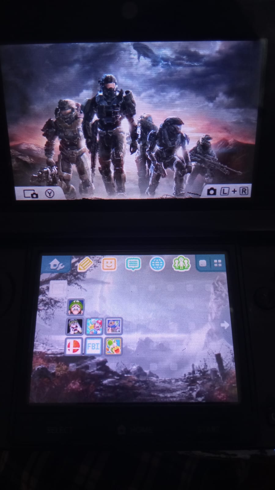

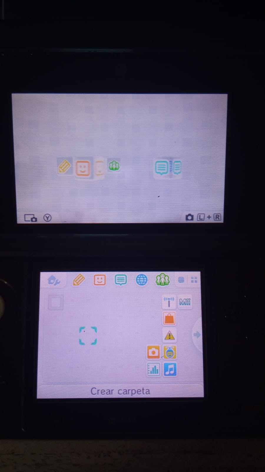

Hello there, i have this issue around 2 days, my 3ds has the home menu completly broken, some apps and UI (like hour or battery) doesn't show, touch things like internet, game notes and start any app freezes the console, so I don't have access to system settings. My only ways to interact with the console are the Luma menu and godmode9 menu. Tried CTRtransfer with the 11.14.0-46U firmware version, but no results. It happens with and without the SD inserted. So probably is a sysNAND issue, I'm running out of ideas so I hope someone can help me

You could try to attempt a safe mode update or do a CTRTransfer using the guide on 3ds.hacks.guide with 11.15, as that's the only one officially supported. Report back if those fail.
