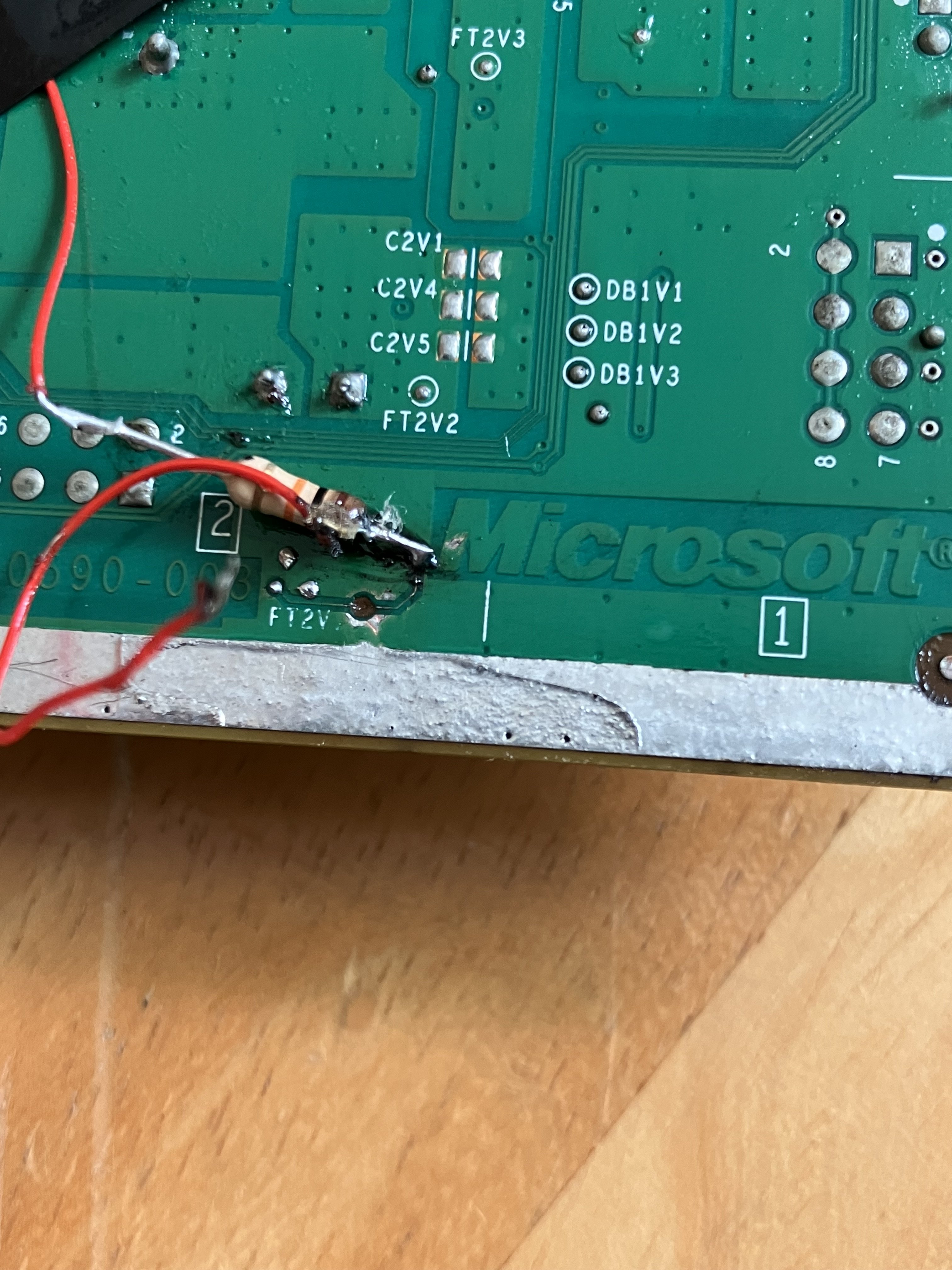

I can’t get the thing to dump. It says nothing is detected. I’ll send a pic of what I think might be the problem.
There’s no continuity across a certain via of the board. And this via is one of the solder points for the RGH3
Here’s the via that seems to be ripped. Anyone got any ideas of where I should scrape to get an alternate solder point? I tried bridging it with a wire but it got ripped off in transit (solder station is in university)
Is the via just above the F in FT2V a good spot to solder? (I think that may have been my previous solder point. Idk anymore)
Does FT2V2 link to FT2V (I don’t have a multimeter on me right now but I can check in school I guess)
Anyway, checked the continuity. That's not a good alternative.
Fortunately, I was able to solder back to the spot; the pad wasn't ripped.
