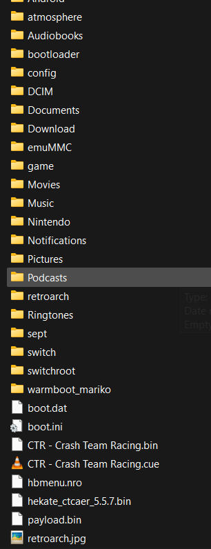

Also, I attach the files in my microsd, if it can help

It's an old version of Atmosphere.
The 'sept' folder isn't there anymore in the latest release.
I see hekate 5.5.7 and that was released around june 8th 2021.
So my best guess would be Atmosphere 0.19.4 or Atmosphere 0.19.5
Since you mention seeing led's behind the vent hole, you probably have a build-in payload injector (trinketM0).
This injects the Atmosphere primary payload so CFW can start.
In order to run the latest update of Atmosphere, you also need to update that payload in the trinket.
There are some topics here in this forum that can help you with that.
After that is done, all that needs to be done is putting the latest Atmosphere files on your SD card and you should be good to go.
And don't forget the latest sigpatches if you want to do anything other than homebrewing. *harhar*

That MicroSD card has been used in an Android phone, you have a bunch of extra folders you probably don't need.

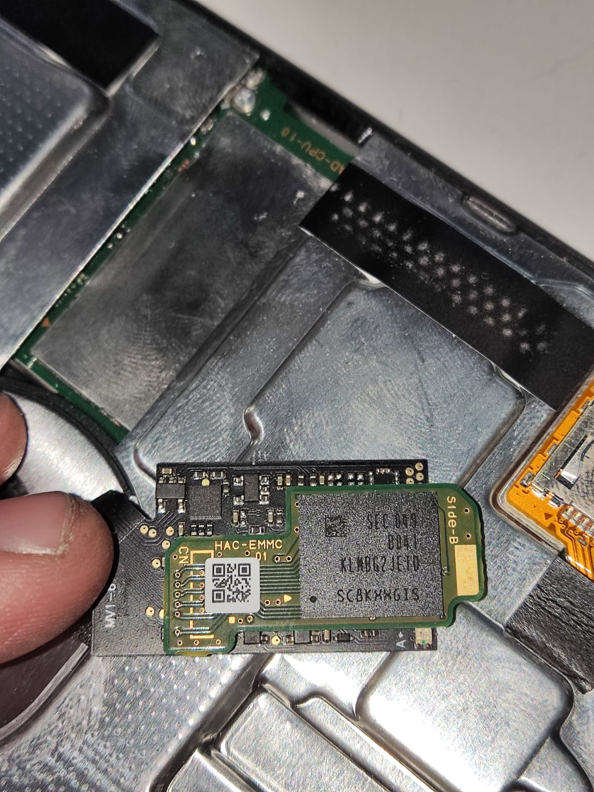

This is the modchip i believe
Ah yeah, I took a look at other video, and yeah it's the mmc
What about the black mini board under the mmc?
The original unaltered switch have nothing like that
After googling it, seems like it's hwfly modchip
can anyone confirm it?

Yeah, it's SXCore mod
