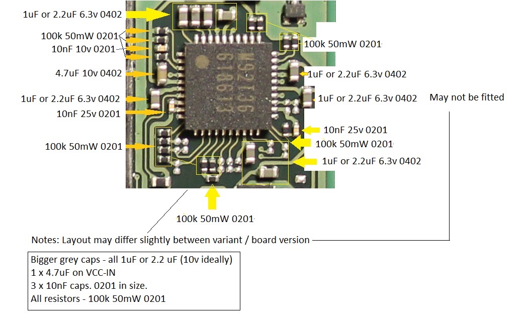

Hi repair guys ! I'm a big noob so... do you know what is this component by the SWITCH LITE M92T36 and its specifications ?
I think its a 0402 capacitor but i can't be sure (sorry for the flux mess, btw any tips for cleaning a whole lot of flux mess ?)

Does this help?
There’s a lot of component pics where this pic came from::
https://www.tronicsfixforum.com/t/nintendo-switch-lite-missing-capacitors-and-resistors/5290

Yeah i saw this pic a while ago and i "concluded" that it could be a 0402 4.7uF capacitor because its the only Brown on the pic with this size but i can't really be sure because its not the same layout on the switch lite...
And now that i look at it again i'm thinking that thit could be the "1.uF or 2.2uF" on the right of your pic because of his position and link relative to the pins while turning the photo to see the text on the correct orientation, so i really dont know... please help if tou can

That’s supposed to be a Switch Lite according to the thread, I guess there are a few different board revisions out there. You might could ask on tronixfix itself.
