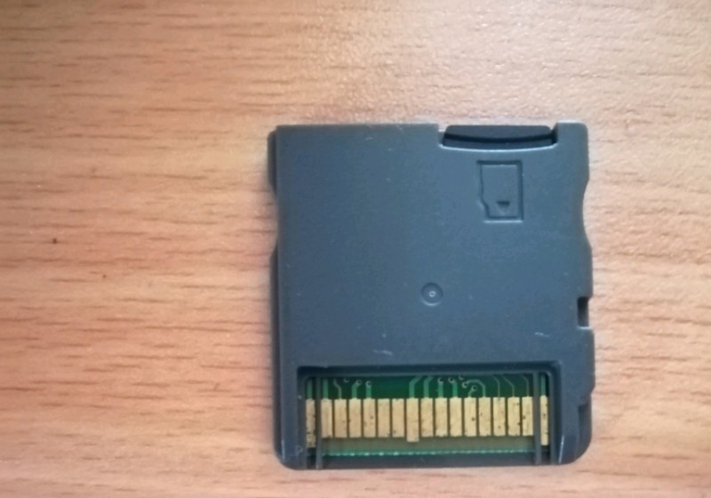

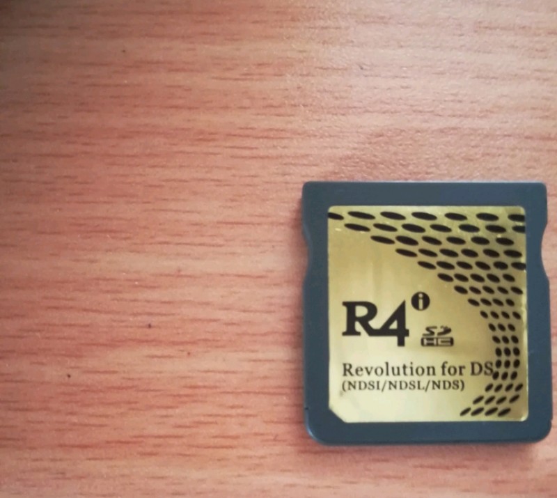

Hi guys i recently decided to play some games on my ds lite after finishing kirby canvas curse i decided to go to zelda games but unfortunately ended with white screen or black screen when i trying to load the games one time i get passed the white screen but get stuck in the menu i downloaded the game from different site with different regions but no luck yet, i tried to update my r4 firmware but it doesn't work on any other firmware, tried installing woodr4 and ysmenu but doesn't work either its r4i sdhc card with gold skin and it's original firmware was 1.35 and the moonshell version is 1.71, whenever i tried to update it i ended up in black loading screen any help would be appreciated

I figured out it's origin, it's from r4-pro.com site the site is down now if anyone have the latest firmware greatly appreciated (mine is v1.4)

1.4 is the last version for your flashcart if it is r4-pro.com. If you want to play the zelda games really bad, your probably going to need to buy a different flashcart.

Each R4 flashcart uses it's own encryption, you have to encrypt the YSMENU it to the flashcart encryption used.
You will need to find the R4crypt tool in the download section to encrypt your copy of YSMENU to make it work on your flashcart.
This is as close to instructions on how to do it: https://gbatemp.net/threads/guide-to-make-ysmenu-work-on-the-r4.97615/page-18#post-1880968
Reply back after you get all the files you need and attempt it.
If you fail at getting YSMENU to work on your flashcart, then it will be as I said the first time, your remaining option will be to get a new flashcart.
