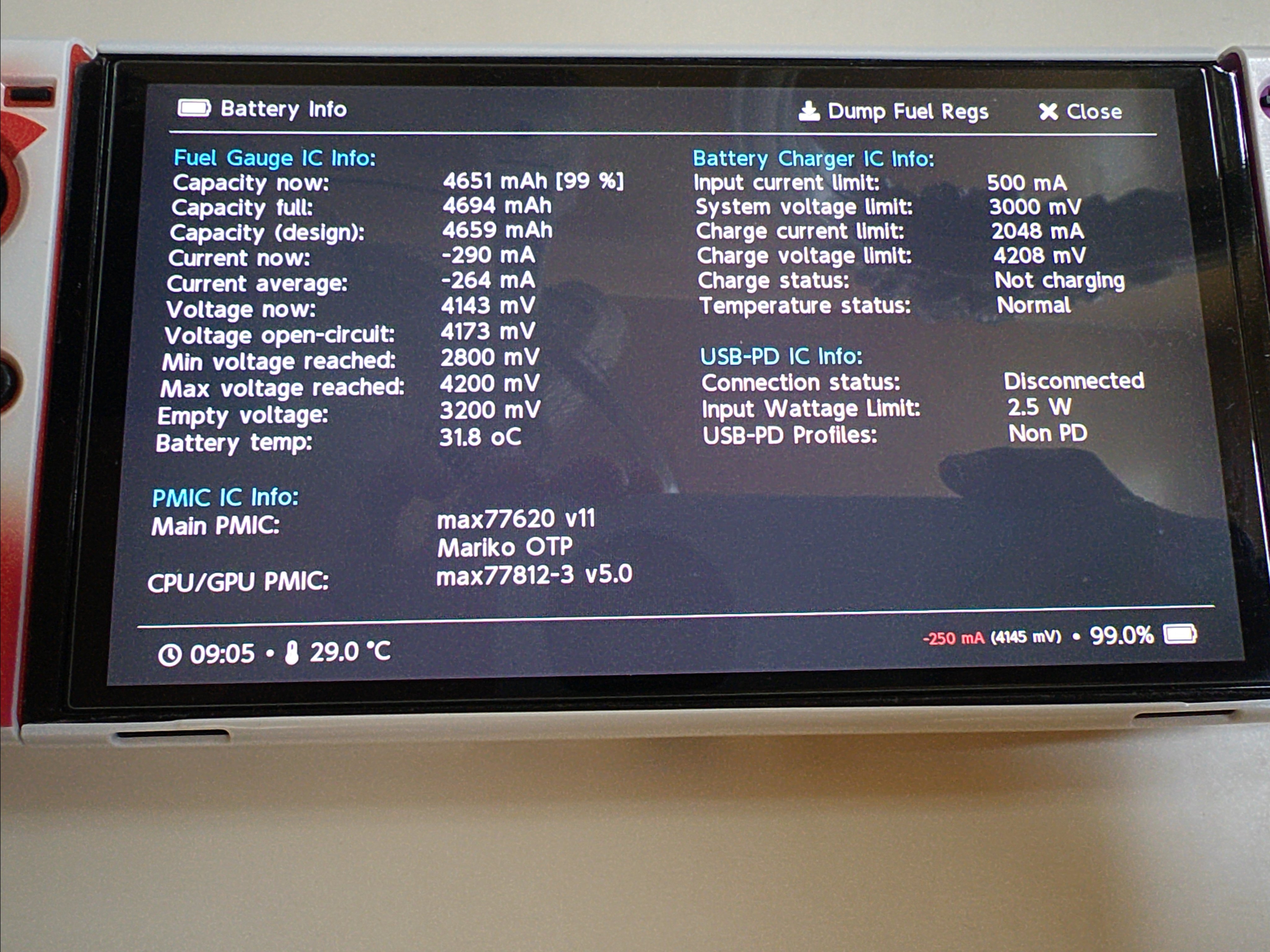

This my only press x with Desync Fix nx for reset battery ic cal at first time without finish 2 cycle charge yet. And Both cfw and hekate battery now are show same capacity designed. Like this I need doing more 2 time full cycle charge right? Save it and go restore after that.
Check the capacity full value in hekate.
I have check capacity design my device show 4659mah, it has problem right? I have see lot comment and post, are see 4667mah,
after full charge now it can play until 2% still not turn off game. Before just 16% it auto turn off.
It is expected around that 4667 number 4659 ain't a big different, actually battery says 4310 mah on it.
