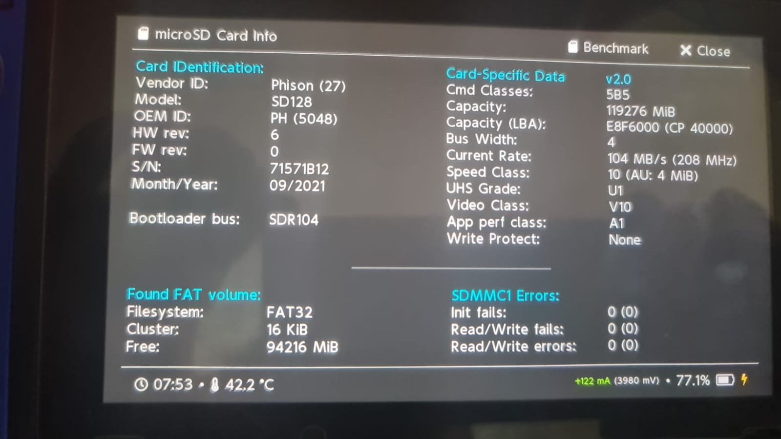

Ok, you need to boot hekate and get to the sd card info screen and take a pic of that. post it here.

SD screen

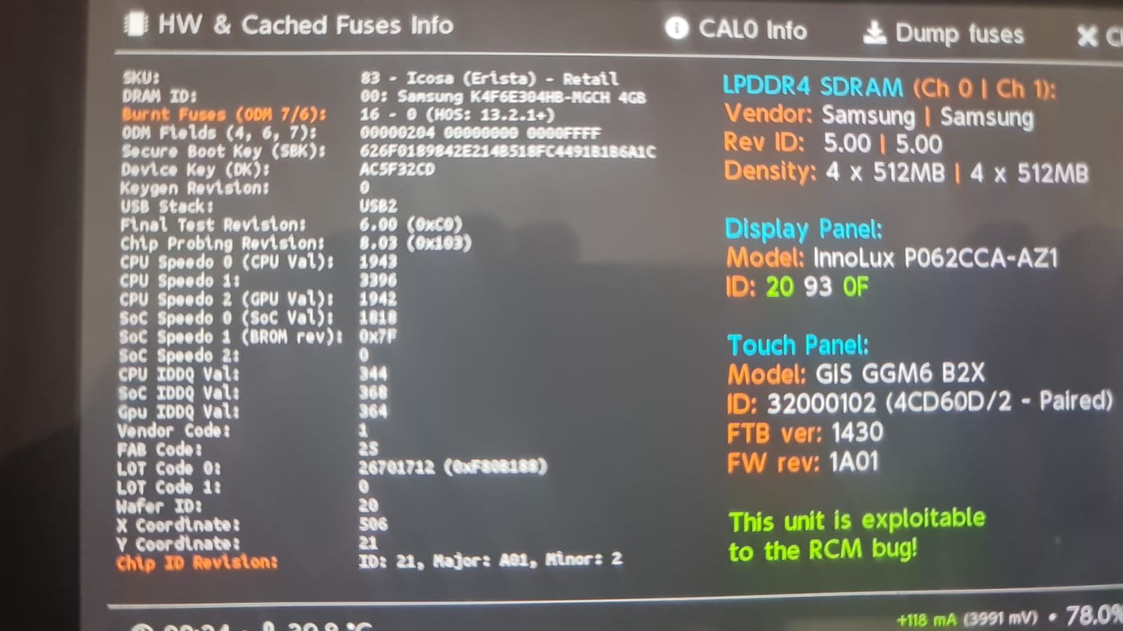

Also checking on the info from hekate noticed that it says Burnt fuses 0DM 7/6, Idk what that is so just upload it as info that might be helpful.hw fuse.jpeg

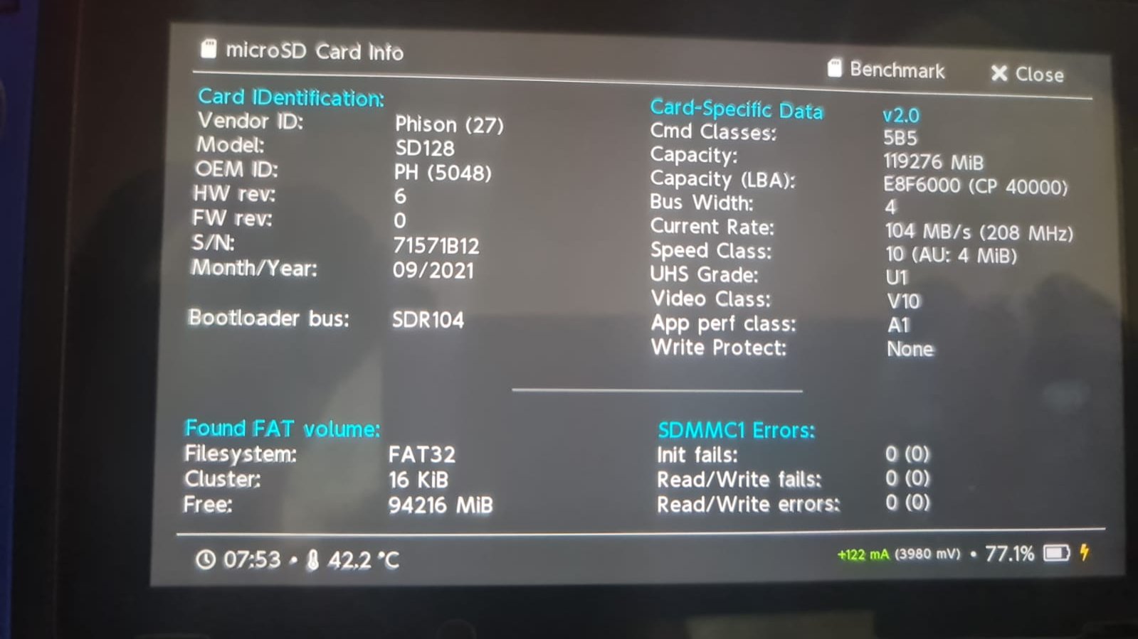

SD screen

Well, the good news is that your card and socket both look ok. Except that hekate wouldn't use a 16KB cluster. To be sure, you might want to format it with hekate, as it will make it 64KB clusters with no bugs. It's done through the partitioning menu, just leave it all for HOS unless your plan is to make an emummc. IF the contents of your card take up less than 1GB, it will restore everything for you. If there is more on that card, then you'll have to manually back it up and restore it.
This isn't going to fix your issue, though. At least I don't think it will... The fact that you say loading through hekate works, but fusee doesn't is very strange. Did you at one point restore boot0 and/or boot1 from one console to the other? That would be bad...
EDIT: And by the way, after formatting, I would try another full backup, to include boot0/boot1... basically back up everything. You should not accept any error of any kind on these backups. If you do, your sd card could still be bad, even though it's not fake. In that case, you'll want to run h2testw on the card, and select "use all available space". It's time for me to sleep, but my Google foo tells me this is an sd card error, one way or another...
