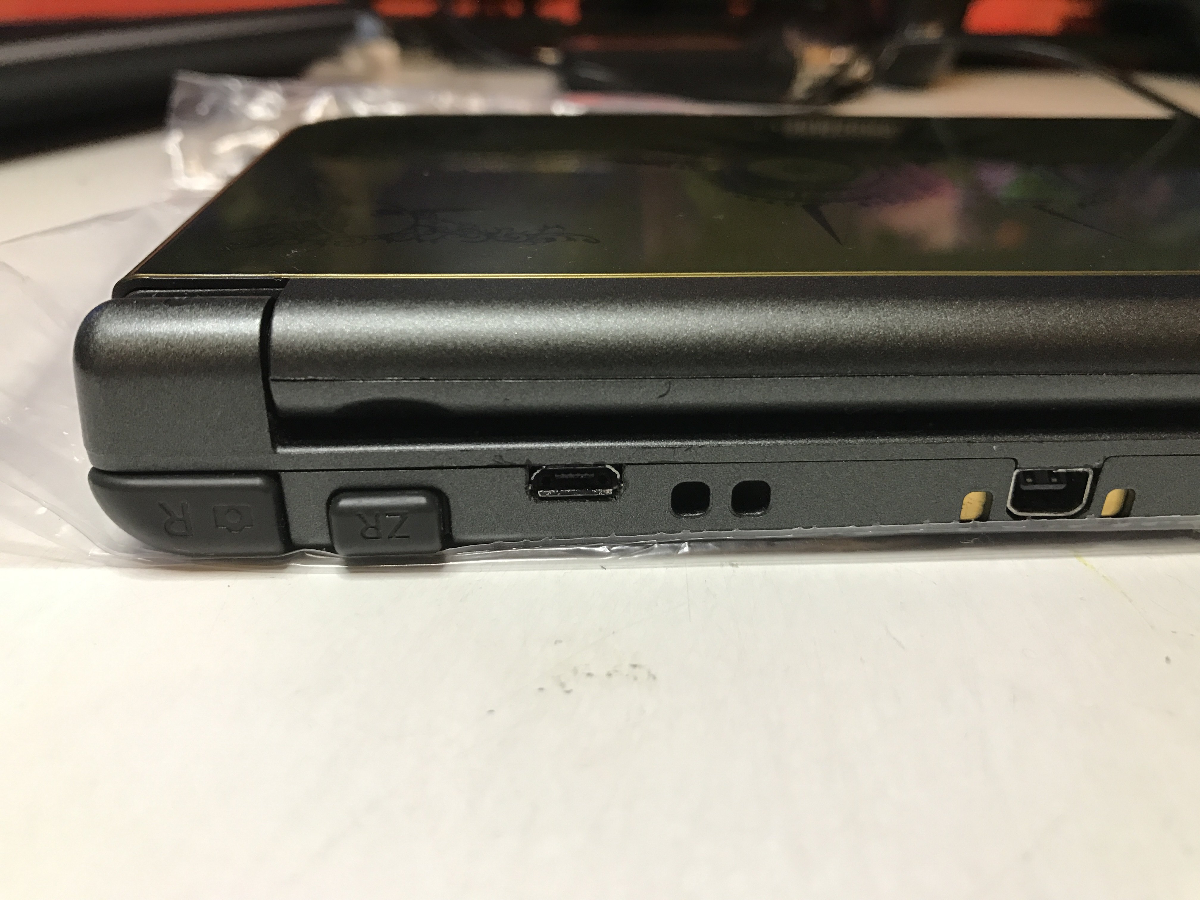

that is not what i'm asking, sorry, this is my n3ds xl:
as you can see i have the micro usb port, that's not the thing,
he has a usb cable that goes from his usb hard mod to his usb on his pc, this would normally not be possible because you need a franken sd + a sd reader to connect a hard mod to your pc because of 5v killing your nand, yet this french guy has a cable that goes from hard mod to his pc without killing his 3ds and working fine, so i wanted to know how he did it and asked if anyone here knows :P

Guessing he took the brains out of a USB Micro SD reader and direct wired up the pins that would normally contact.
I'm like 99% sure that's what's hidden under the heat-shrink

Looks like he heat wrapped a tiny SD carder into the USB cable itself. Pretty cool actually.
So to OP, the guy still has the SD card reader it's built into the cable itself. You'll fry your 3DS if you connect your NAND to the computer USB port bareback.

Look how thin the heat shrink is, no reader is that thin? I think he has a risistor under there that cuts the 5v usb to the voltage the sd reader would also have

Most likely solution is the internals of a SD/USB adapter have been installed in the console along with a CMOS analog switch circuit that creates a connection between the 3DS points and the adapter only when 5 volts is detected coming from the micro USB connector, otherwise the console would constantly boot to a blue screen.
its most likely that the micro sd card reader was put in the 3ds itself to make it an AIO hard mod. there was a thread here a while ago of a guy showing off this exact mod for the card reader.
