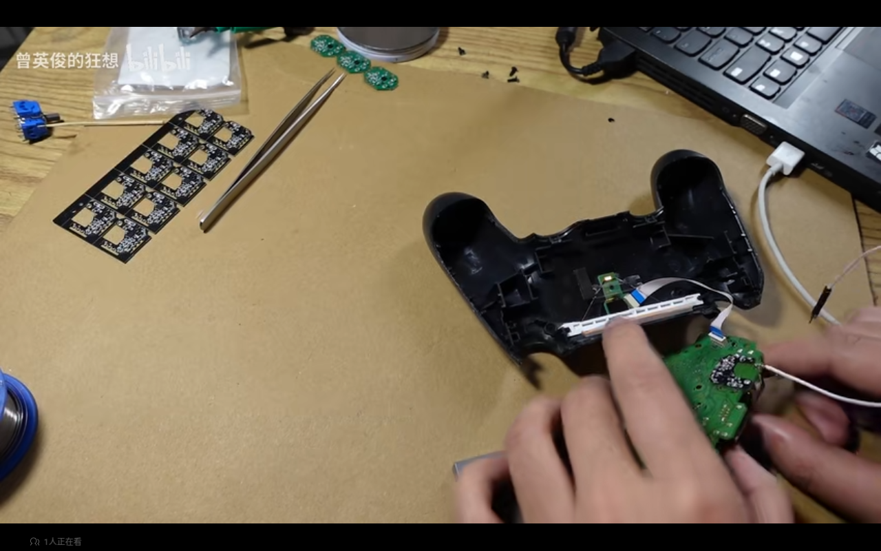

I guess we need to wait until Marius Heier releases his product on Tindie then.
Reactions: NeoHoth

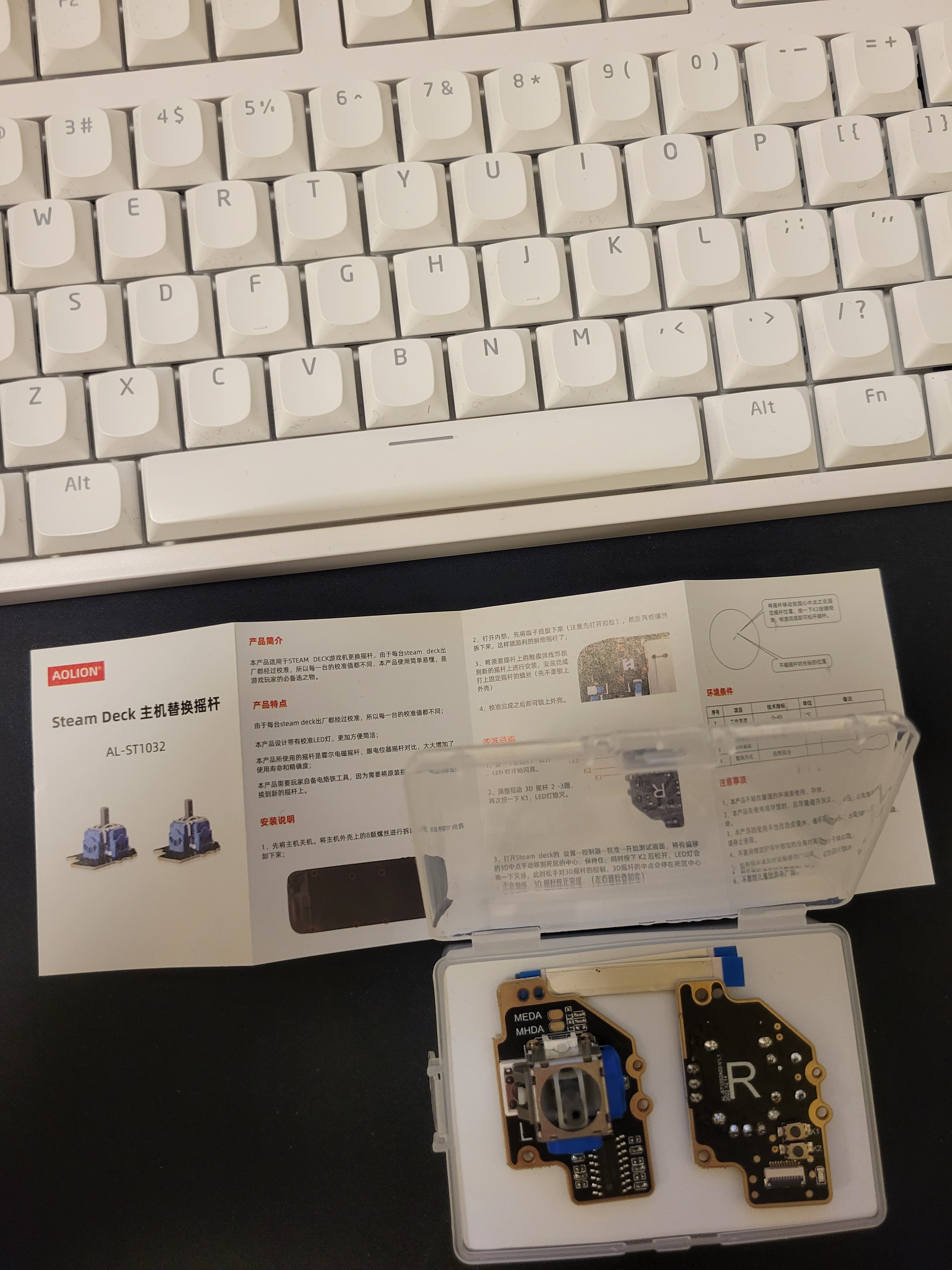

So these PCB's are what help with these K-Silver rockers being calibrated on any controller? In that case, I may have to get another spare pair of the Steam Deck modules again. As for the PCB's I wonder when they'll be released.
If only we could get the K-Silver rockers instead of just purchasing a lot of these modules.
Yep, they seem to work in the same way as the daughterboards of Steam Deck's K-Silver Joysticks. So, basically, it seems to be possible to hook K-Silver's daughterboard up as I suggested earlier.
We'll have to follow his bilibili channel for further updates. It may only be available in China. Hope it would be accessible through a local agent in China to start selling these boards in Etsy.

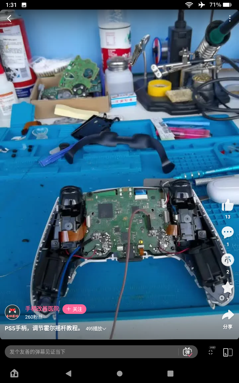

For PS5 just buy the dualsense edge.
Yes but I want to try out the new hall effects plus calibration board that I see on bilibili that can be installed on ps4 \ ps5 and Xbox controllers but not available on eBay ,Amazon or Ali express . I understand that Marius - H has almost completed his hall sense effect that process faster .
It is not worth the hassle for PS5, For PS4 or Xbox maybe, just a hassle to take it apart and solder like daughter board on to the main board and do all that work.
Reactions: Kaylibchristopher
