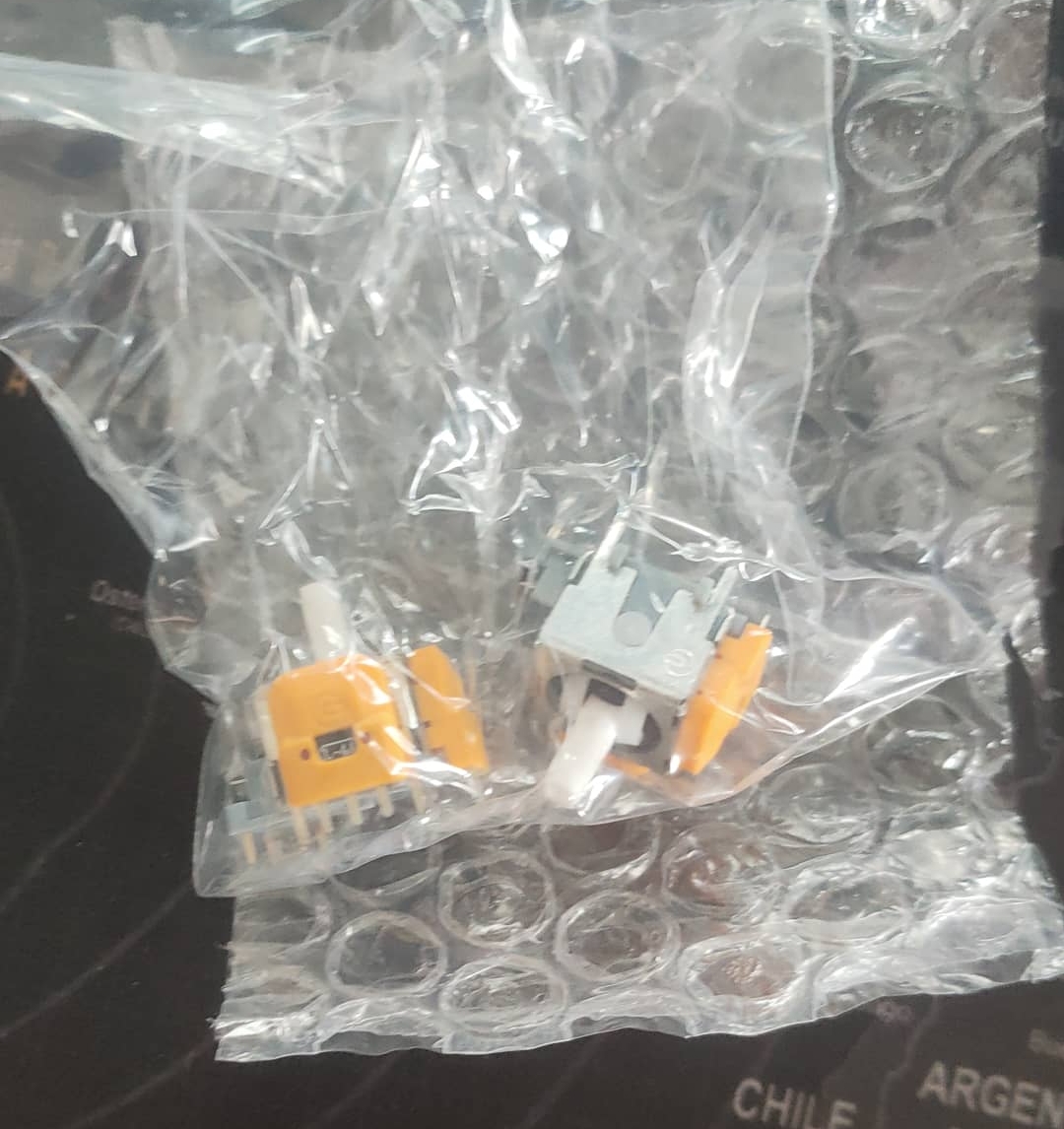

Hi everyone! I can fully confirm that the cheap hall effect modules for the switch pro controller you find on AliExpress are working. The sticks worked right after soldering but if you calibrate them using the Switch Calibration Tool, they will be dead center and you will be able to turn the dead-zone all the way to zero. I have documented my full journey here . The specific modules I installed had an orange color and read "L-4J" printed on the PCB.
So I finally got around to installing those orange sticks. They do work well.
After calibrating them on the Switch, I used Joy-Con Toolkit to read the raw values of user calibration for each stick, and then write them back as the factory calibration. So resetting to defaults will always get the controller back to a known well calibrated state.
