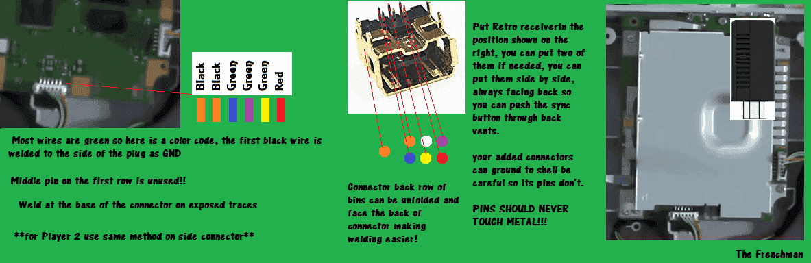

While waiting for Hakchi2 for SNES I solved the problem of the annoying face cover... I know its locking pins will break someday so!
I inserted my 8bitdo retro receiver inside a clone of controller port 1 which is inside the console itself.
Pretty easy to do if you have a retro receiver for NES/SNES classic
see attach pictures!!

Great mod. I've heard the 8bit do pad doesn't feel as good or accurate as the real deal especially with diagnols. True?
It works great, it's a bit more responsive so you might have issues with that if you are clumsy but seriously it's as good as the real thing.
Yeah, I can confirm this. It's as good as the real thing. And I love the mod. I'll ask a friend if he's able to this. Thanks alot for the pictures!
The hardes part was figuring the order of the pins... I had inverted wires 3 and 4 because on the connector you wouldn't expect them to be in that order.
Very easy to do when you have tons of broken Wii remotes at work! Hahaha!
Interesting indeed but you need to take it apart if you need to rebind the controller which would put me off - also not sure if you could fit 2 inside for multiplayer sessions
I indicated in the tutorial image how to place them so you have access to the pair button, you could theorically place 3 inside it side by side... you only need two obviously. I only put one because I relarely use play multiplayer and also both face connectors will still work.
