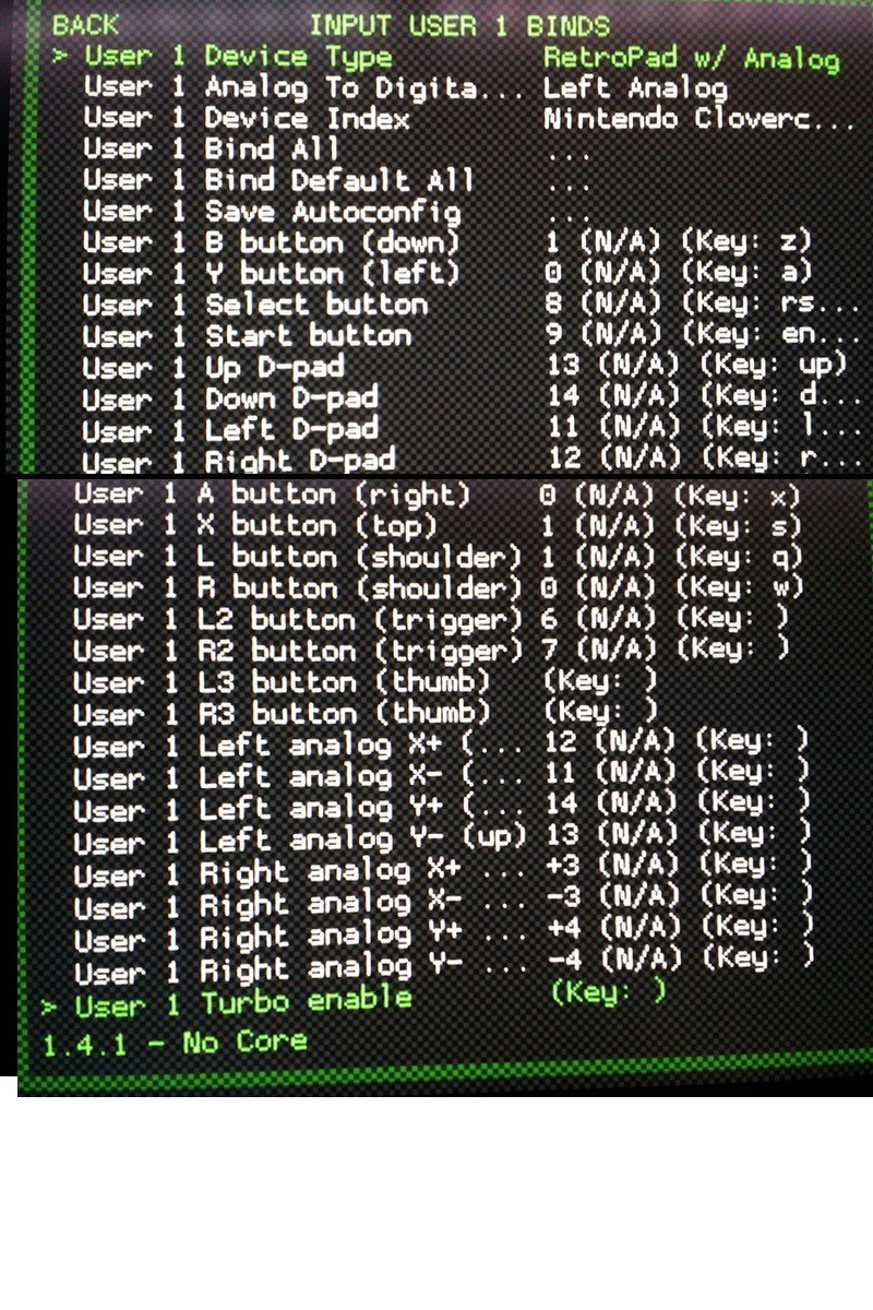

well i'm still unable to remap my Nes30 pro, even after a clean install from original dump and a system reset (my saves ): ..), so here is my debug file
only the nes30 pro was plugged on the nes classic retroreciever
Clovercon: initializing controller 0 on bus 1, gpio 195
Clovercon info: added device for controller 1
Clovercon: initializing controller 1 on bus 2, gpio 194
Clovercon: probing classic controller
Clovercon info: probed controller 1
Clovercon: Clovercon setup
poll: 84 86 86 86 00 00 FF FF 00 00 00 00 00 00 00 00 00 00 00 00 00
con_info_data before setup: 00 00 A4 20 01 01
con_info_data after setup: 00 00 A4 20 03 01
Clovercon info: opened controller 1, controller in OK state
con_info_data before setup: 00 00 A4 20 03 01
the first before/after results are different, maybe that's the problem?

Yes, i know, i saw your posts, and i keep posting that it doesn't work.
here what my mapping looks like
and what i've done
Before mapping
After mapping

You have to use the 1.05 beta 0 firmware for the receiver the beta 3 firmware sets x and y to turbo and wont let you reset them right.
:gun::shit:
i'm gonna eat my hairs!!!!! i was preparing candles, some incense sticks and a newborn for a sacrifice for the glory of satan
Then i saw your post and wanted to prove that it doesn't work too, because i did exactly the same thing last week and it doesn't worked. But hey, this time it worked :grog:
:wacko: I'm becoming insane
I can finally use L2 R2 for savestates :gba:
But i'm still unable to map L3 R3, they are not recognized, but hey it's a better situation than before
now i have to do the same with my 2nd controller to see if it wasn't just a lucky try
so RR is on 1.05beta0
and the nes30 pro is on v2.0
