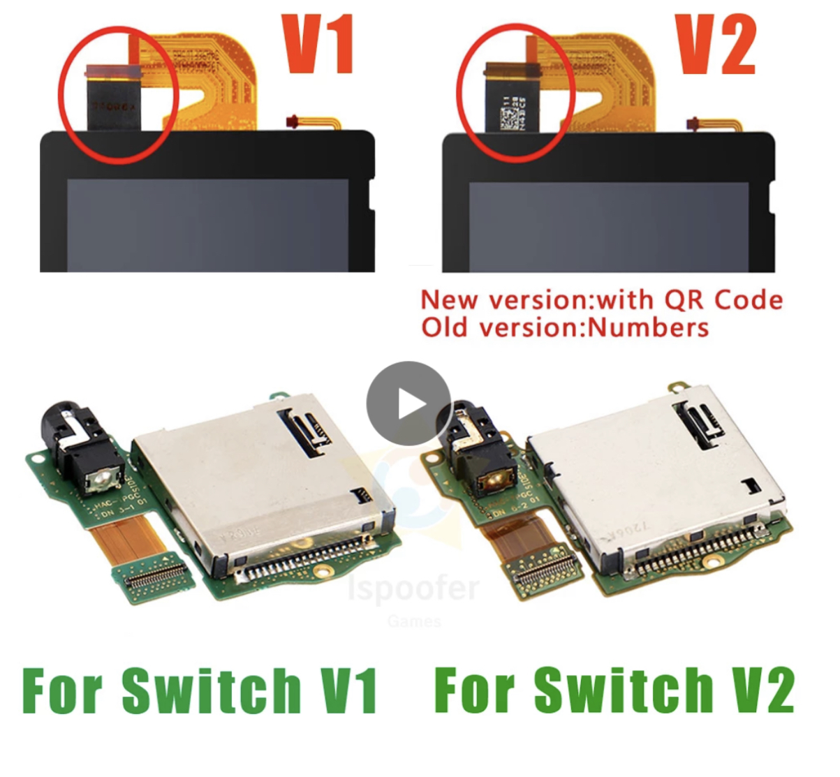

Is it possible to use a v2 switch screen on a v1 switch? I have a bricked v2 switch and a working v1 switch and I want to swap out the screen if it's possible. Thanks in advance!
The connectors are completely different. Check here:
https://www.aliexpress.us/item/3256802841267734.html
The Game Card has to match as well.
Not even a close fit…

It's only the digitizer/touch screen differences. They have mix uses in v2 or v1 with those 2 types touch screen. Quite misleading from Vender side from beginning and misinfo flooded everywhere saying v2 or v1 touch screen incompatible but turned out even Big N mixed them up sometime and reprogrammed the FT9J chip to match the assembled result.

@binkinator is correct, there are multiple version lcd and gamecart, you have to get matching version to work.
I’ve tried 4 different games card readers and they all worked for both v1 and v2 digitizers
Got them from v1 and v2 switchs
It is because you used hekate, it doesn't count if you use Hekate to recalibrate.
Thread 'Digitizer replacement issues' https://gbatemp.net/threads/digitizer-replacement-issues.556468/
Thread 'Touch screen stopped working after replacing the digitizer' https://gbatemp.net/threads/touch-screen-stopped-working-after-replacing-the-digitizer.616793/
Sorry forgot to say that I only had to use hekate on one of the card readers also after fixing through hekate it still worked on ofw
