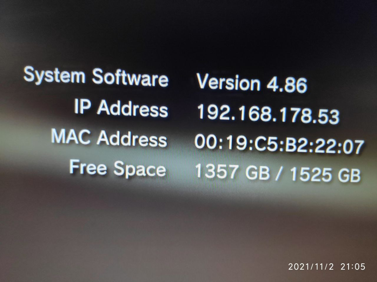

If you have a 2TB storage (HDD/cheap SSD) you want to use with a PS3, you can 'convert' it to 1.5TB which will work without problems with a PS3.

"I can confirm that it works PERFECTLY on the service boot menu, it works if you ask it to restore the system, works just like a smaller drive.
You're losing 1/4th of the SSD size? Yeah. But this works reliable, works AS IT SHOULD."

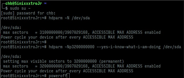

"In a nutshell, what I did was:
  1. connect it directly to the SATA cable/ports on a PC (laptop or desktop)
  2. elevate yourself to root (using sudo su -)
  3. run hdparm with the parameters shown on the picture below
  4. power off your computer
  5. remove the drive, place it on your PS3, format it and have fun"

Worked great for me! I’d recommended adding list drives before since I had to use /sdh instead of /sda. Thank you for the tutorial now I have a 1.5TB SSD internal
