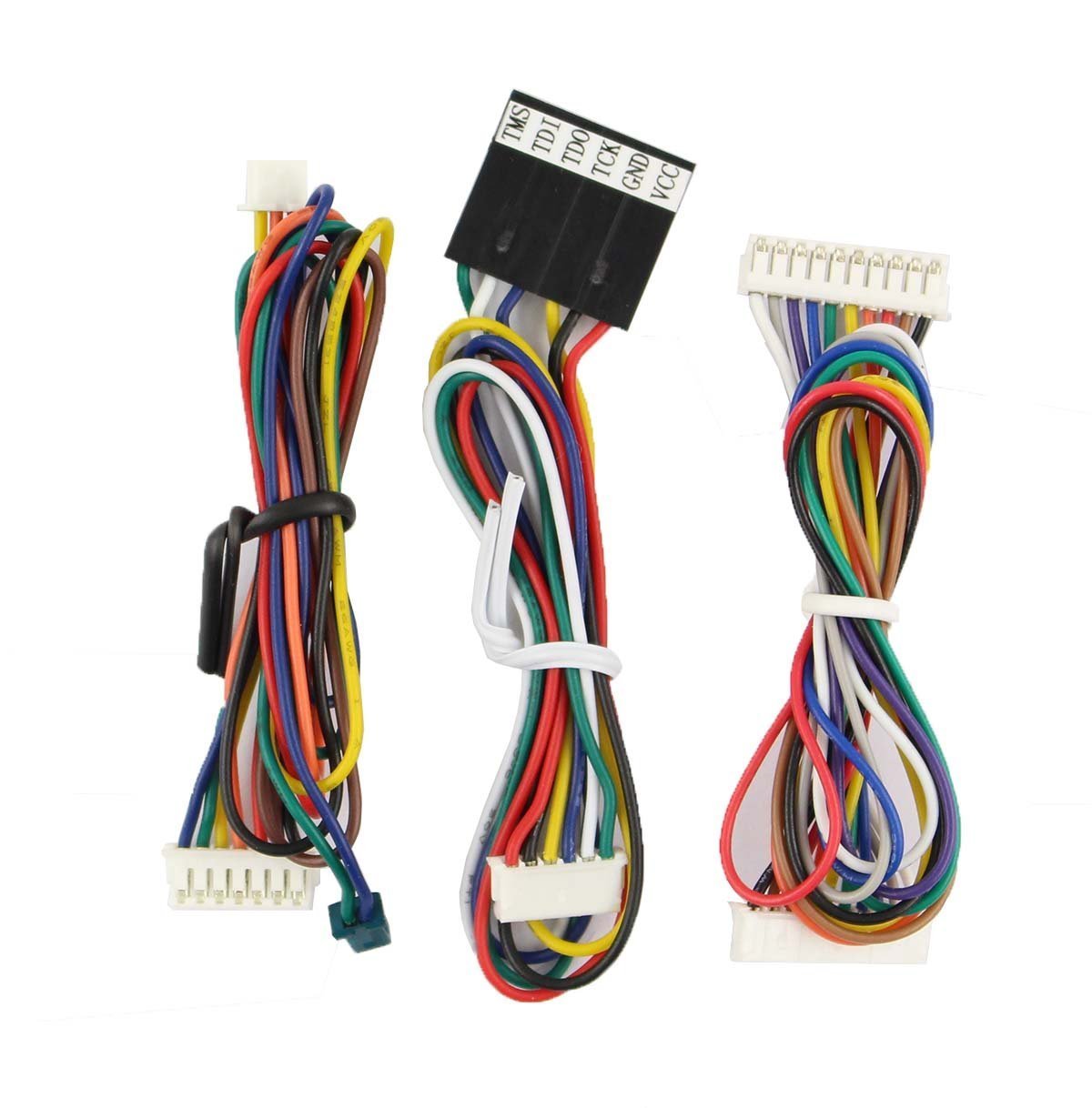

OK just to verify with that programmer i dont need the diodes or resisters they are built onto the programmer correct? just chop the 3 ends that dont plug into the programmer and solder those directly to the board and i'm good to go.. and you leave the programmer inside the xbox after your done so it still has the diodes and everything connected where it should be..
and the cable is the left one our of the 3 correct?
(https://images-na.ssl-images-amazon.com/images/I/71dwI+VM22L._SL1218_.jpg)
The diodes for JTAG aren’t the ones on the LPT programming wires. You’ll still have to get some diodes and stuff for the procedure if you don’t get that Xecuter JTAG kit I linked. It’s a QSB but it might be worth the risk since you don’t have to put all of the JTAG connections together.
Ok now I gotcha..so that jr programmer doesn’t have everything I need I still need either the qsb or the diode and resister
Have to wait a bit longer then to get that stuff the jr programmer showed up today
