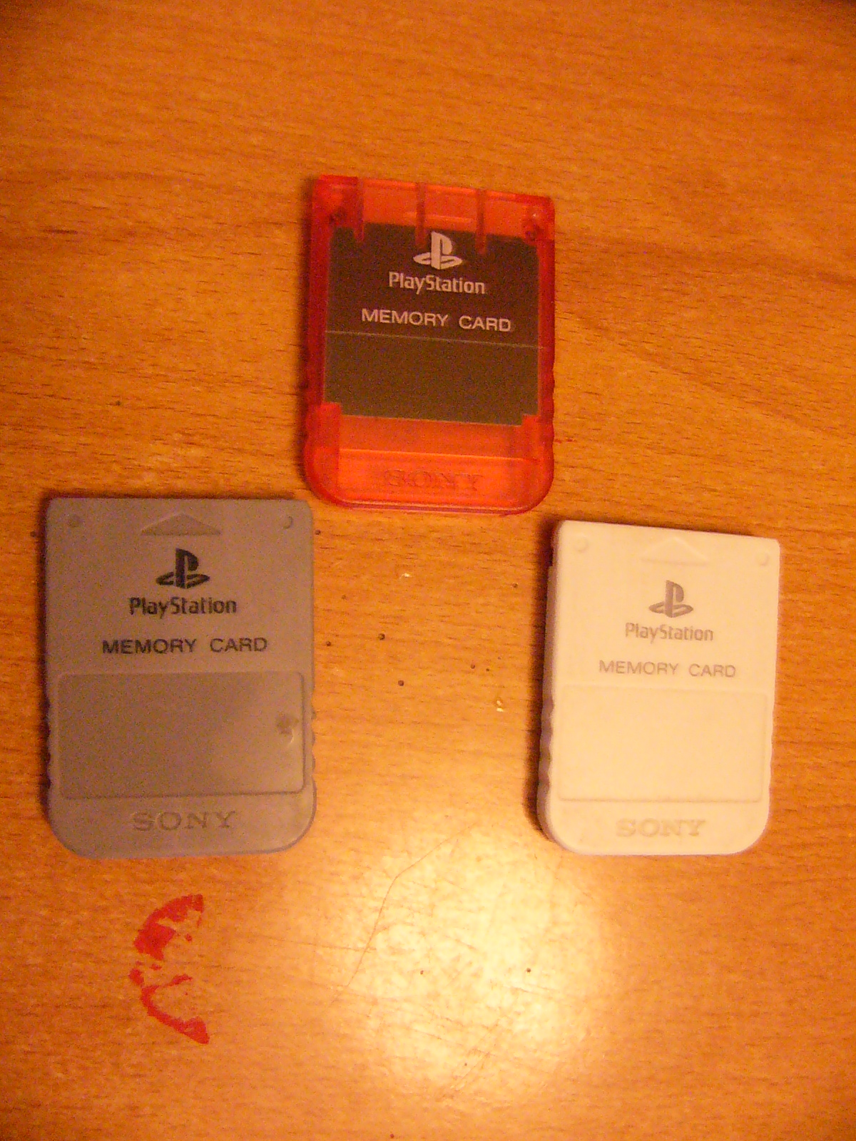

These are the original SCPH-1020 PSX Memory Cards:

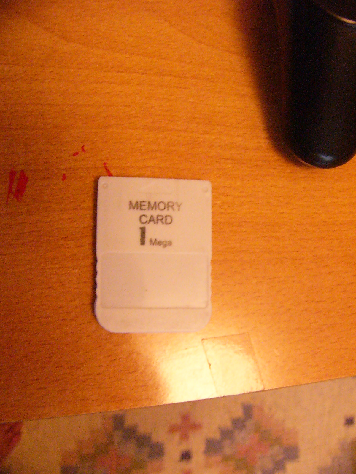

And this is an "clone" one with also 1 MB:
From my personal experience the Clone has the Ability to "disappear" without a warning.....
That's pretty annoying when the game hangs up too ...:(
I do not longer use it and also no greater ones.
