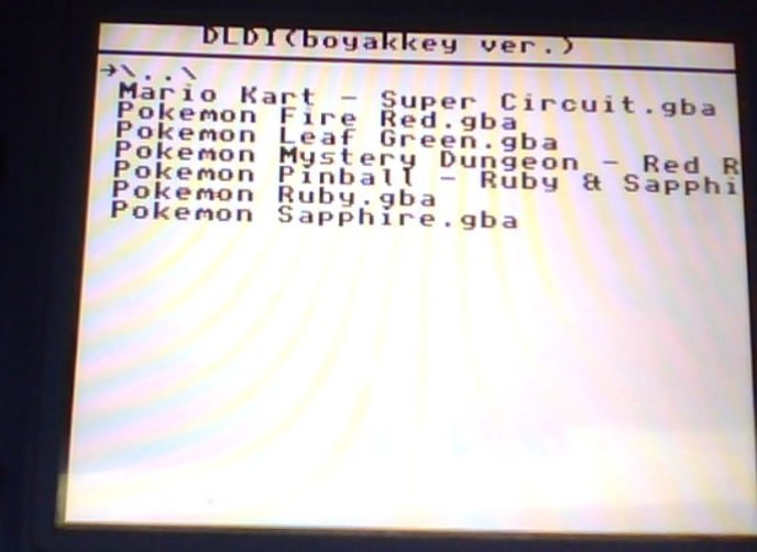

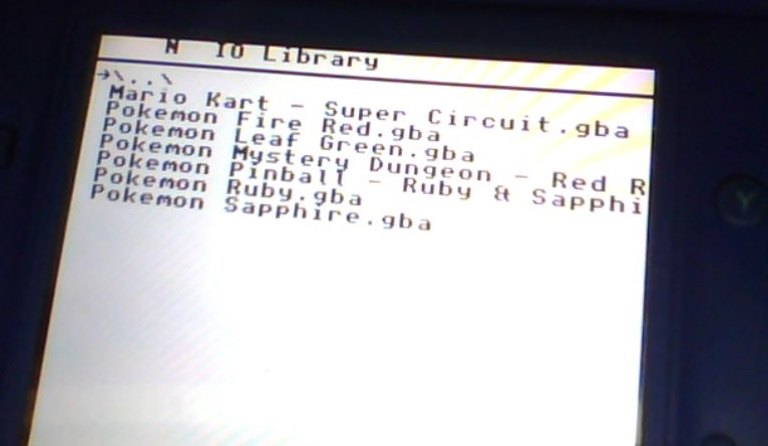

I was having a very similar problem; all the files would appear properly, but for some reason the roms wouldn't load, it got stuck in load or copy. I ended up using ysmenu and the first big difference i noticed was that a different message appeared on top of the bottom screen when i started the app. You should probably give it a try.
Edit: Visual of what happens with...
a) regular boot
b) YSMenu boot
a) regular boot
b) YSMenu boot
Oh, yeah, that text is the name of the dldi driver. So that means a different way of accessing the sd was used. Did that one work? If so might be interesting to compare.
The one that works is the one used YSMenu (the one that shows DLDI), the other one at first stopped when loading, and after a couple attemps it got to copying, later today I will let it run and see if it is just a matter of time.
a) regular boot
b) YSMenu boot
To me that seems like the ysmenu does auto-dldi patching (so you can see the dldi string properly) by standard DLDI interface, where the other does not? Is any other NDS homebrew (like SnemulDS and NesDS for instance) running fine in regular boot?
NesDS uses libfat, but SnemulDS uses https://bitbucket.org/Coto88/gccnewlibnano_to_fsfat (gccnewlibnano_to_fsfat driver), to use SD access.
Make sure to use to use latest homebrew from: https://bitbucket.org/Coto88/ (master branch, in /release folder)
That way, if both homebrews work fine, then that's up to GBARunner2 itself. On the other hand, if at least one of these two homebrews fail, then the kernel does not use auto-dldi patching, or the DLDI patching is non standard. That said, I think YSMenu should work for both cases.
