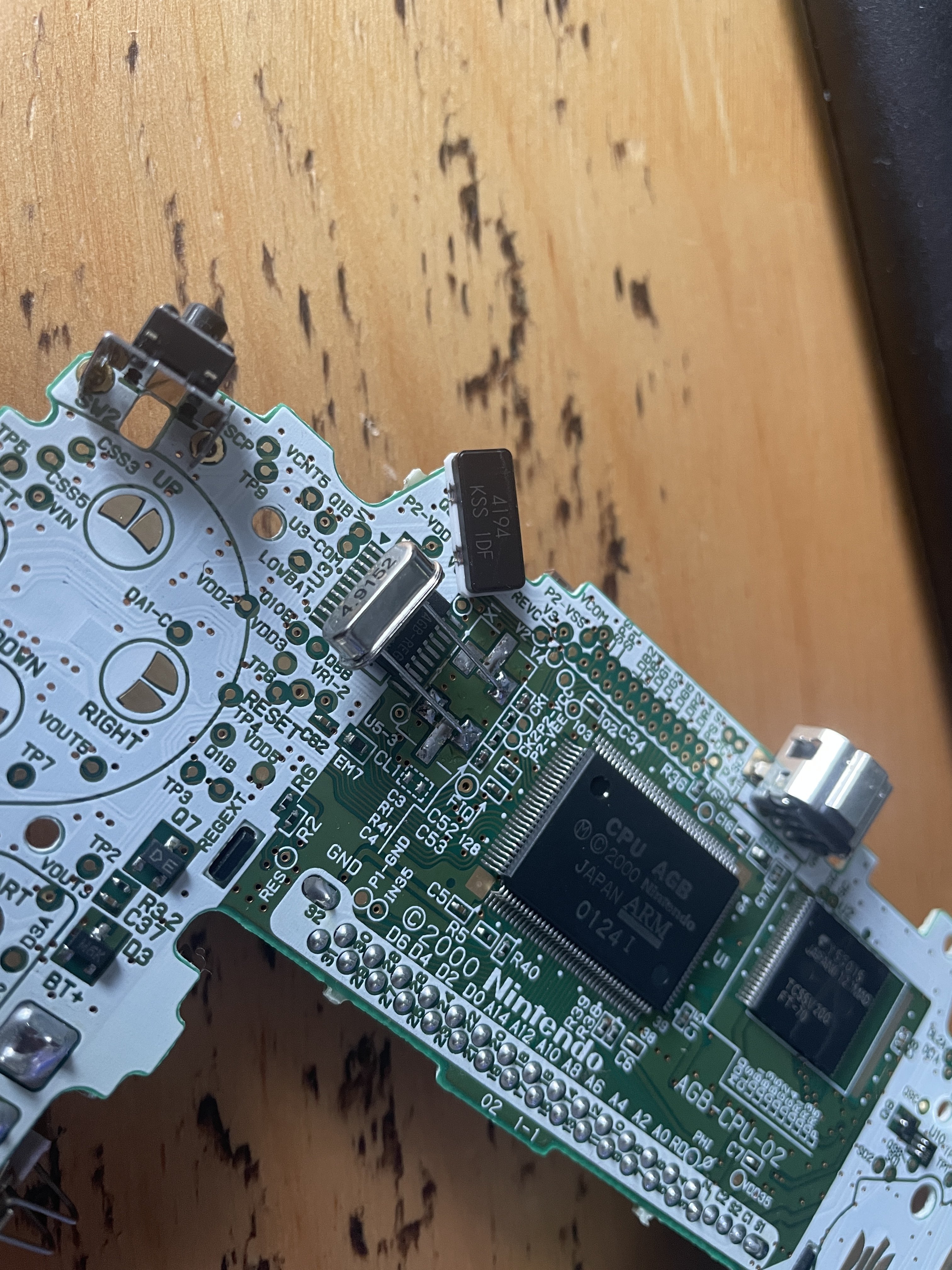

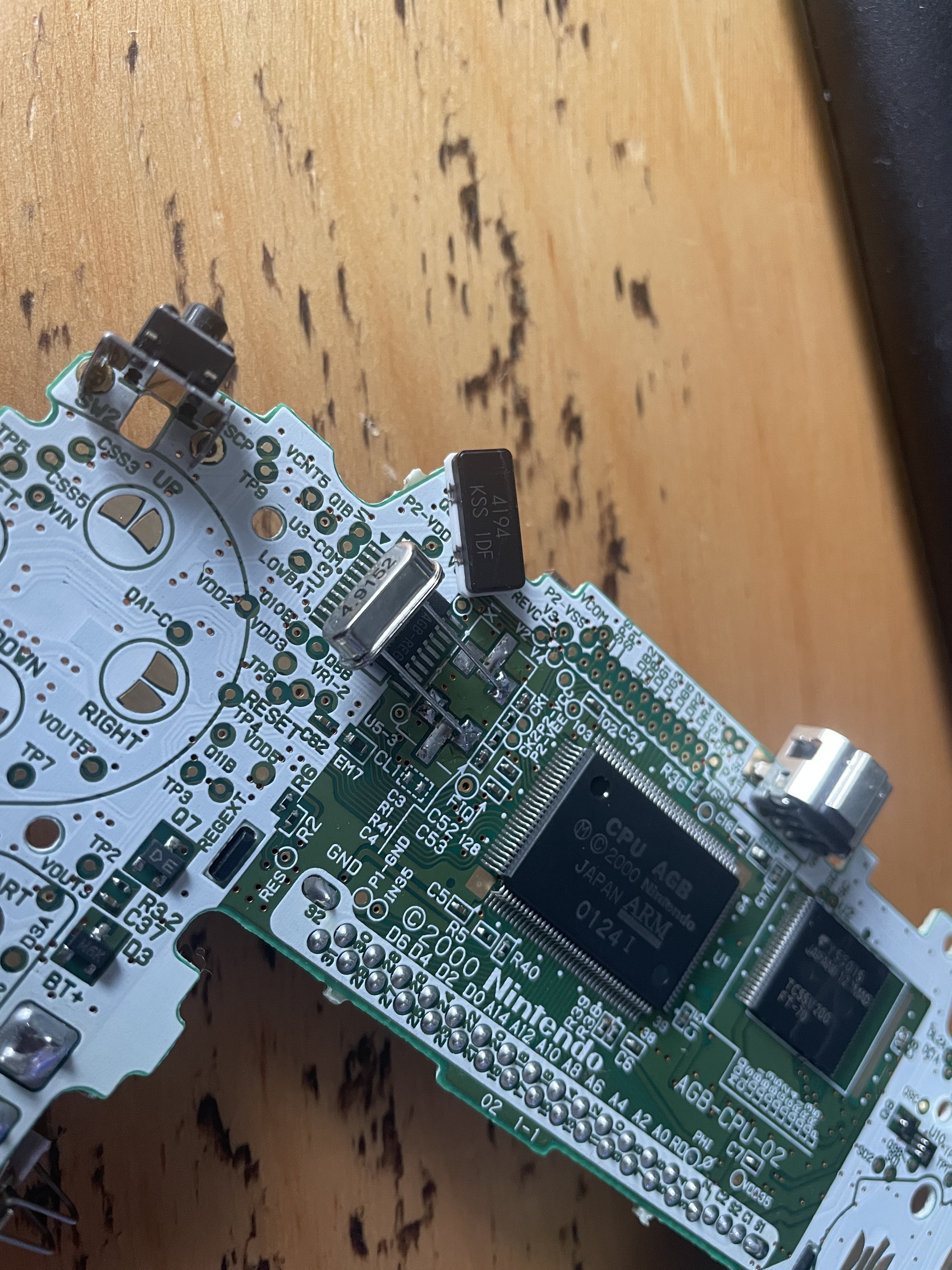

Ah well I’ve managed to desolder the crystal. It is surface mounted. Wasn’t that hard actually, just stuck the iron on one side of the crystal, and after a few seconds all four pads got loose. No damage. Happy days. Now it’s off, might as well fit a new one, even if it turns out to not be the problem. Process of elimination. Just need to order one and it’s 4.194 MHz indeed.

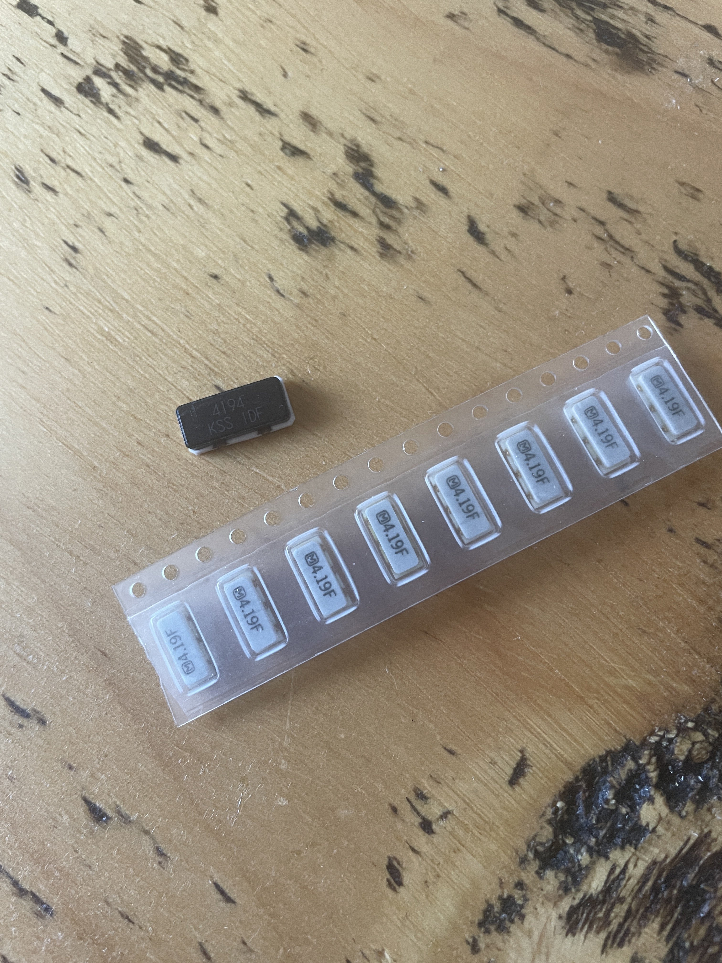

Update: It appears that it was the crystal indeed. Could only find a crystal rated at 4.9152Mhz locally, figured i'd get one at the price it cost for diagnosis purposes. Game runs faster as expected from the higher clock, but no slow downs anymore and sound is back to the expected quality.
Now need to source a suitable 4.194Mhz crystal. Actually after much browsing last night, I think it is a ceramic resonator rather than quartz crystal oscillator. Also the height is critical, the original crystal is only 2.5mm tall and the screen sits right above it. I don't think there is much room for taller crystals (anything taller than 4mm i think won't fit, not even sure if 4mm would fit). Any leads on where to source such a slim surface mounted crystal would be appreciated. All the ones I could find are from wholesale shops with high minimum quantities or high shipping costs. Might be that I'll have to get one of the through holes crystals and relocate it somewhere else in the GBA shell, but I'd rather keep it as close to the original if possible.
For info, below a picture of the original 4.194Mhz crystal and the higher clocked one installed for testing purposes.

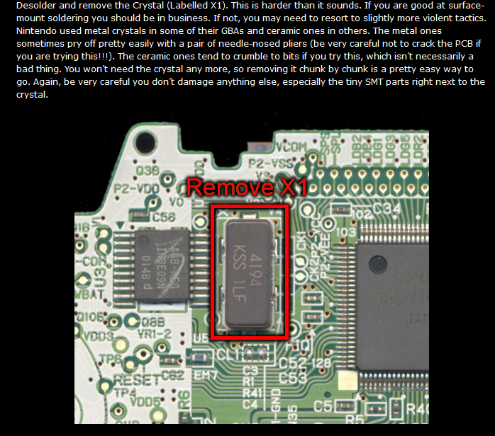

Sidenote on this part... one of the best ways (ironically) ro prevent damage to the board when retiring old surface mounted parts, is by literally destroy them.
Grab the part with whatever pliers you're comfortable holding, and gently (but firmly) twist the part to each side.
