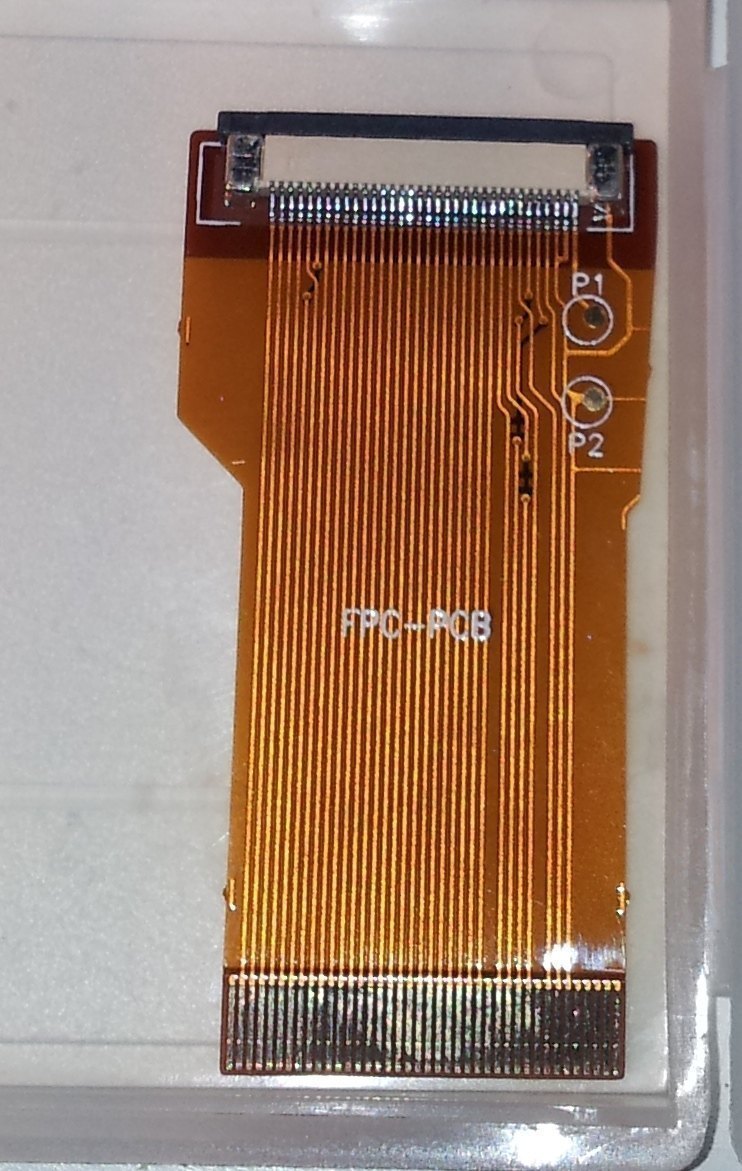

Hello everyone I'm about to try the AGS101 mod and I have a couple of questions, and I hope you can help me.
My GBA is a 40 pin one and thus I ordered the 40 pin cable.
Now I received a solderless one. I've heard the solderelss ones give a dimmer light than the ones with a soldering cable attacehed to it.
Is that true? If so, as I understand I need to solder a wire to the cable and to the GBA, just like I would've with the solder version.
But where exactly on the cable?
I've attached a picture of the cable I received.
Solder to the trace marked P1. If you look through the pictures in this thread, you can catch glimpses of other people's ribbons with the wire soldered to the P1 trace.
