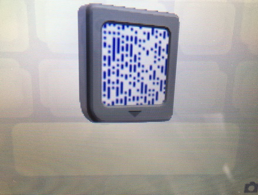

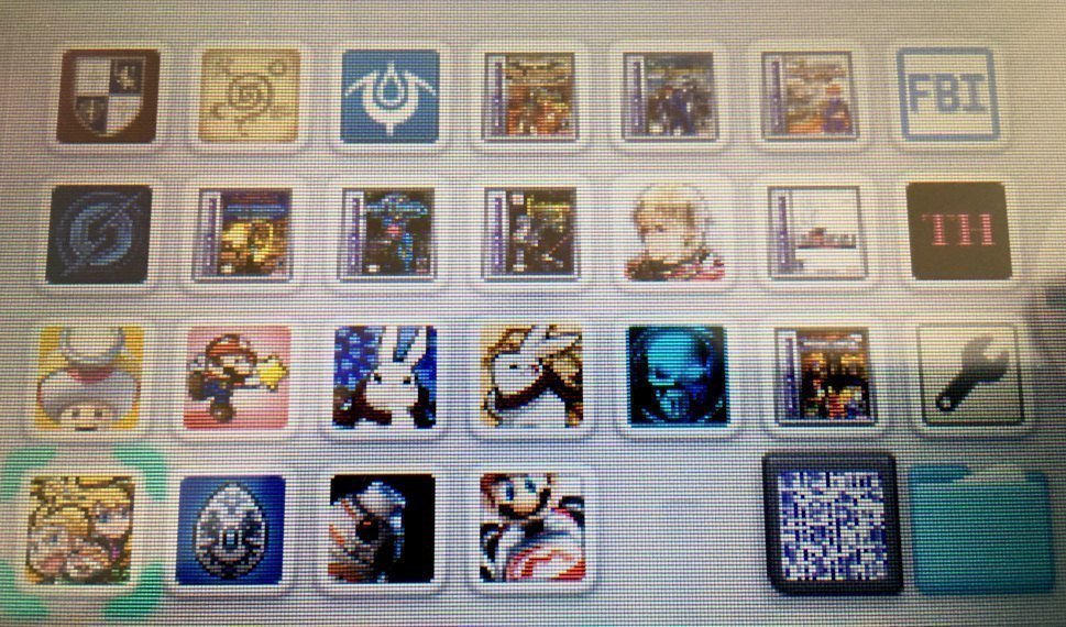

Yesterday, I decided to try some DS games and this is what I found:
It now shows an empty title box and instead of the Konami-game icon, it shows a wall of blue lines and dots over a white background. It is actually animated (Matrix-style), like the icons for DSi games.
According to what I have read, the icon of the flashcard does not change when flashing its firmware using ntrboot_flasher, but I tried three different firmware revisions anyway (A7, Plus and D.) All of them worked, but the icon and title box remained empty.
Just in case, I reformatted its micro SD card, tried a different micro SD card and even tried a different version of the Wood kernel. No changes.
Any ideas of what may cause the fuzzy icon?

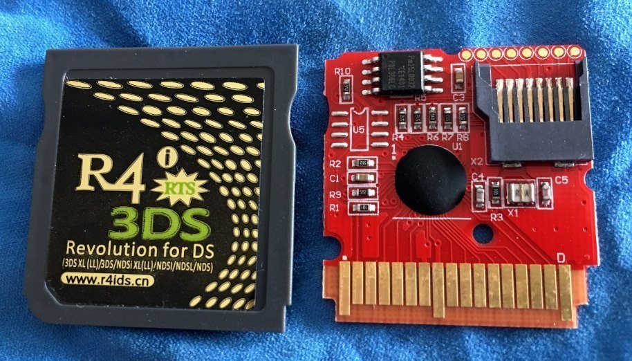

There are some contact issues with the pins, but nothing annoying. It always works after one or two retries. I do not know however if the problem is caused by the pins that connect the flashcard to the console or by the pins that read the micro SD card.
Here is a picture of my flashcard. According to ntrboot_flasher, it is HW Type b7db5bb5, Rev. a7a7a7a7. On the back, there is a "D" printed in the corner.
It is currently running the firmware HW A7 and Wood kernel 1.64.

TurdPooCharger, my man, I already tried re-flashing the flashcard. I actually installed three different firmware revisions yesterday, the 'problem' was that all of them worked but the icon remained messed up.
While reading about restoring the DSi function (what you suggested), I also read the section Clear Home Menu extdata. And since I had nothing to lose, I delete it. Boom! The flashcard icon was restored on the following boot.
Fuck it! It was way easier than searching for different firmware revisions, re-flashing the flashcard three times or re-formatting its micro SD card.
Cheers, mate. You pointed me in the right direction.
