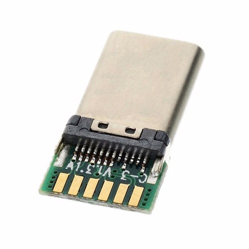

Could you, please, post a photo of your work? Would love to see where exactly you soldered the port.
i just soldered it to the usb pins, it was pretty straight forward.
for the usb-c board side with 6 pads the center two are D+ and D- and on the other side, the two pads are GND and VCC (5v) it's pretty straight forward

this is the link for the one i bought but i wouldn't recommend this seller as i bought the male connector and he sent me a female connector instead so i messaged him and he apologised and sent the male connector out so i was happy and after that i needed another one for a different project and thought i would give him another try and again he sent me a female connector instead but again i messaged him and he apologised and sent the right one out, i'm guessing he has someone new sending out the orders maybe but either way i got what i wanted and i suppose i did end up with two female connectors as well XD
anyway here's the link:
https://www.ebay.co.uk/itm/DIY-24pi...e=STRK:MEBIDX:IT&_trksid=p2057872.m2749.l2649
