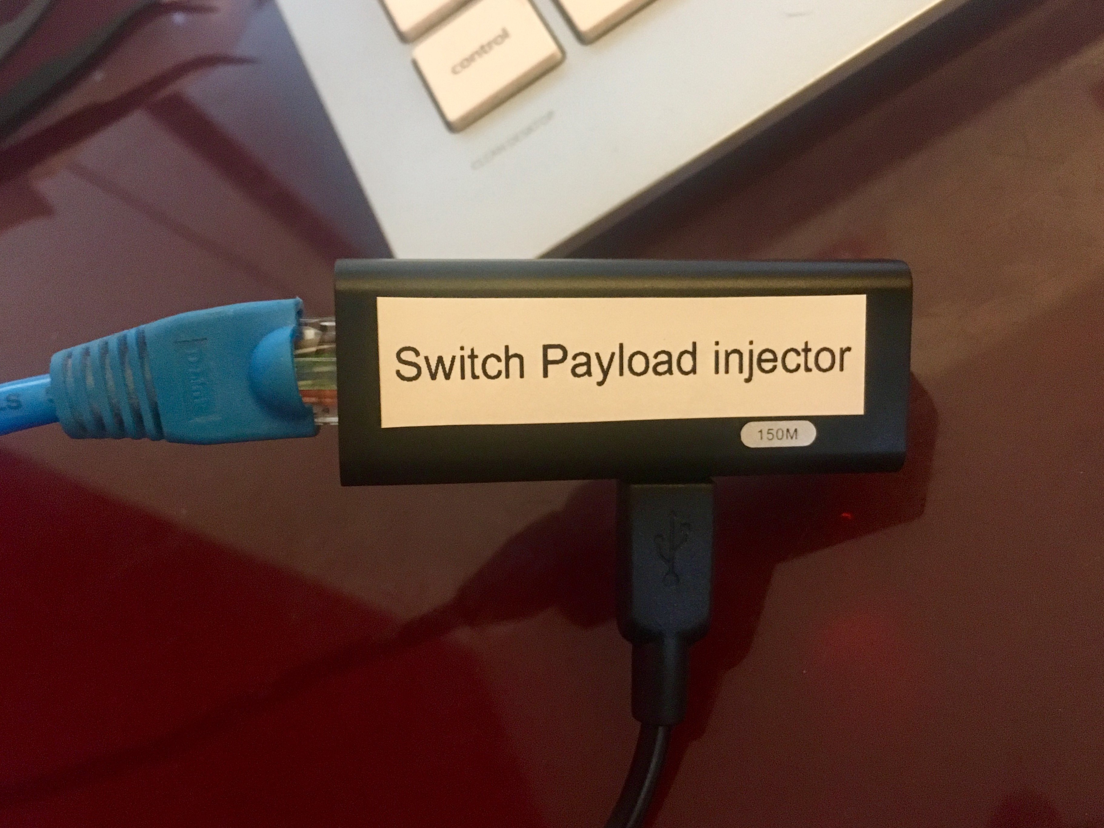

David Buchanan already explained his great work on this thread but it is now mixed up with other projects so i created this dedicated thread.
The router i bought is this one from AliExpress.
I followed David's instructions without any issues
Find attached the already compiled binary file (firmware.bin) for those who want to save some time on compiling.
The update method from the original router website failed (seems common), so i used the USB drive method explained here.
(Only difference was my USB Flash drive popped on /dev/sda and not /dev/sda1)
After rebooting it, the router IP is set to static as 192.168.1.1 so you may need to connect it with an ethernet cable to your computer and force its IP address to 192.168.1.2
Then using WinSCP to connect to the new IP of the router, you can edited /etc/config/network to change it back to DHCP :

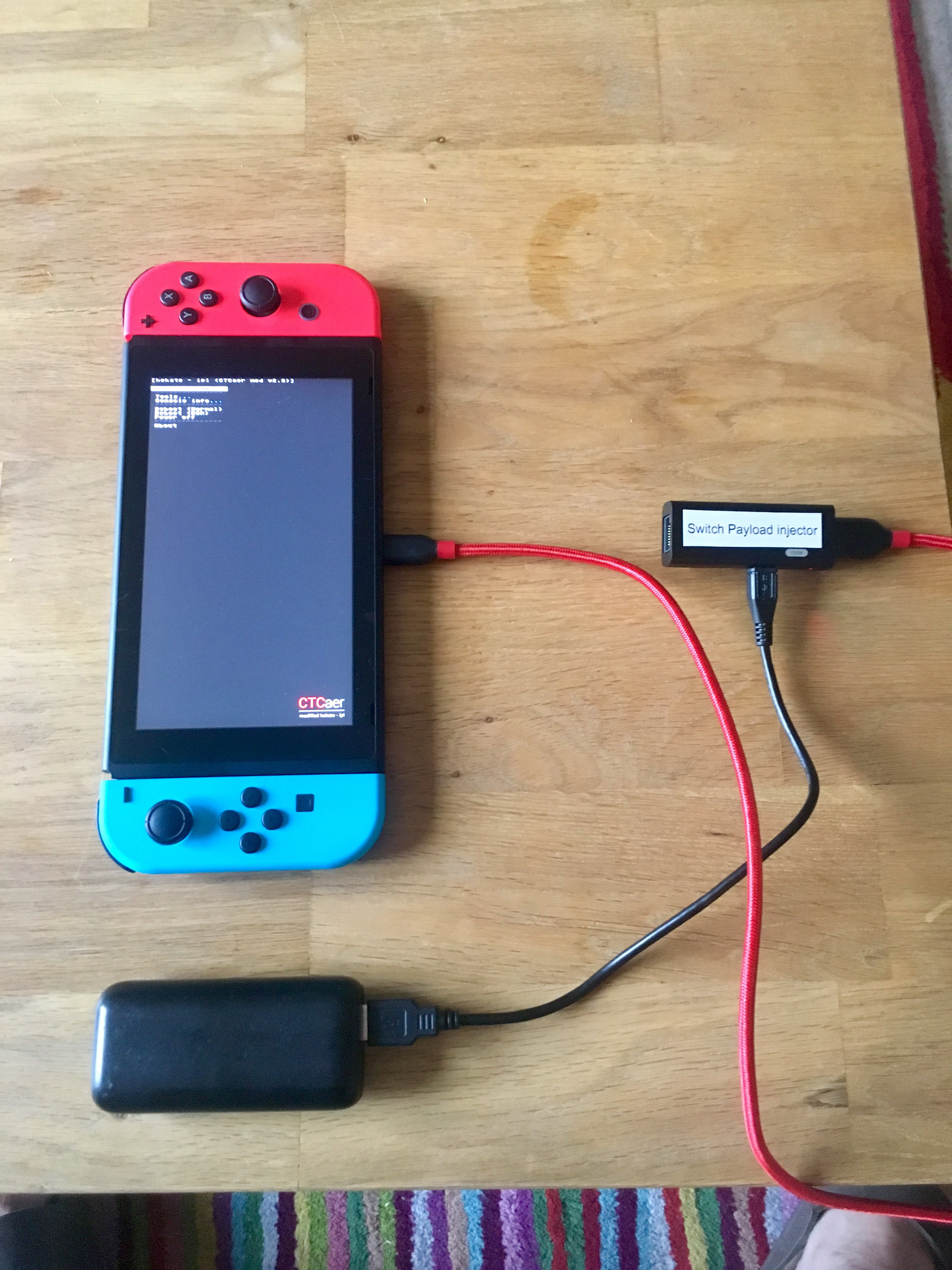

OMG it is alive now i see 3GWIFI_XXXX
what should i do next???
Great. :) Now you can put the payload.bin of your choice on the flash drive and insert it into the dongle while it's turned on, and it will install the payload for you. It will flash blue twice to indicate success. Then you're ready to use it on your switch.

Normally that should work. I guess it doesn't like something about your flash drive. The other way to update the payload is to connect to its wifi, use an SCP client like WinSCP, connect to 10.1.5.1 with the username 'root' and no password. Navigate to /usr/share/fusee-nano/ and put your new payload.bin there.
Reactions: KsAmJ
Thaaaaaaank Yoooooou soooooo much
i though i just bricked it with no hope to make it work
This is the best thing ever :yayswitch:
