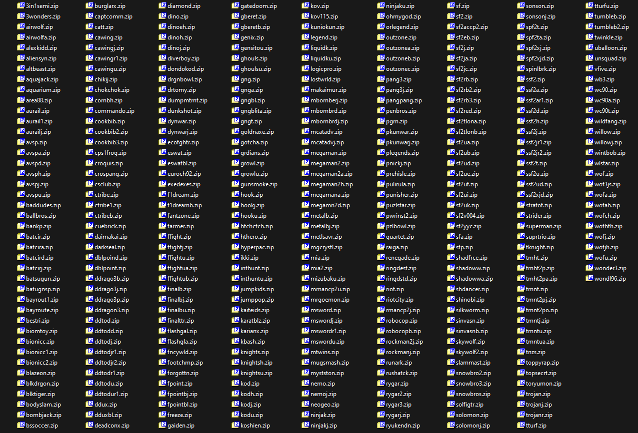

Here is the list of the working roms I've tested (275 games + 2 bioses):

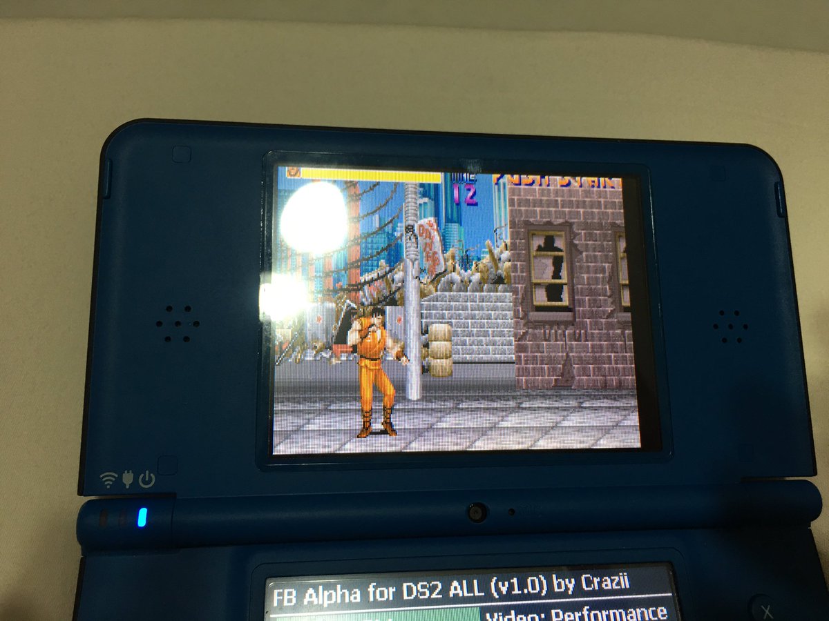

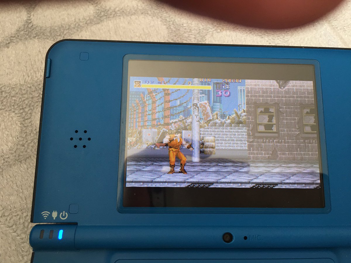

Anyone interested in better scaling for CPS core? Right now FBA4DSTWO scales preserving the aspect ratio 12:7 (384:224 is resolution for CPS games), this results in black borders on upper and lower parts of the screen. These games are meant to be played on 4:3 aspect ratio though (non-square pixels), which is native AR for DS/DSi (256:192). I edited it so that it scales the width from 384 to 256 (same as before), but cuts the upper and lower 16 pixels to make the height 224-32=192 to fit DS screen. Scaling might be tried too, but this way is faster and probably cleaner instead of scaling height from 256 to 192. A picture is worth thousand words i guess.
BTW this emu is much, much faster than the mame emu for DSTWO, thanks a lot crazii.
Here is the video in action:
The binary and the only changed file (SwapBuffer.S), compiled for CPS1 and CPS2 cores since the AR changes are hardcoded and will break scaling of other cores.
Use the Performance mode to see the new scaling method, you can change to Quality mode to see what was it like before i edited.
https://transfer.sh/Wz1cB/fba4dstwocps.zip
EDIT: New binary which will turn off lower screen when not in use. again only cps core but i created a pull request with the changes to author, so he/she might include them in main branch.
https://transfer.sh/qB7QW/fba4dstwo.plg
EDIT2: Sleep mode added and both the lower screen turn off patch and the sleep mode patch have been submitted to original author. Feel free to DM me if you want to test some binaries.
EDIT3: Getting the binary size reduced makes more games boot, for example i can boot Alien vs Predator CPS2 game with CPS core. There are a few more things to reduce the binary size. Hmm, let me see. BTW any devs/testers can contact me, i am not a great coder but at least i got a Supercard DSTWO sdk installed on my pc and i can mess with a few things.
EDIT4: Did a few more edits to my fork, i will also deliver binaries if asked. https://github.com/rereprep/fba4dstwo
EDIT5: Finally added the fast, purely in MIPS A68K core. CPS1/CPS2/neo geo games are already full speed. A caching mechanism for CPS2 and neo geo games is what this emu needs. unfortunately it is beyond my ability to add caching. I will still work on this emu some more though.

HI, I've done some test with your builds. The A68K version seems it's faster than the original version. And I like the fullscreen dispaly.
I think you dont have to cut upper and lower pixels, just scales the height from 224 to 192 to keep the right 4:3 aspect ratio. Because the DS screen's resolution is much smaller than CPS, you have to scale the width, the game can't be displayed pixel to pixel anyway. So why not keep the right aspect ratio at least?
