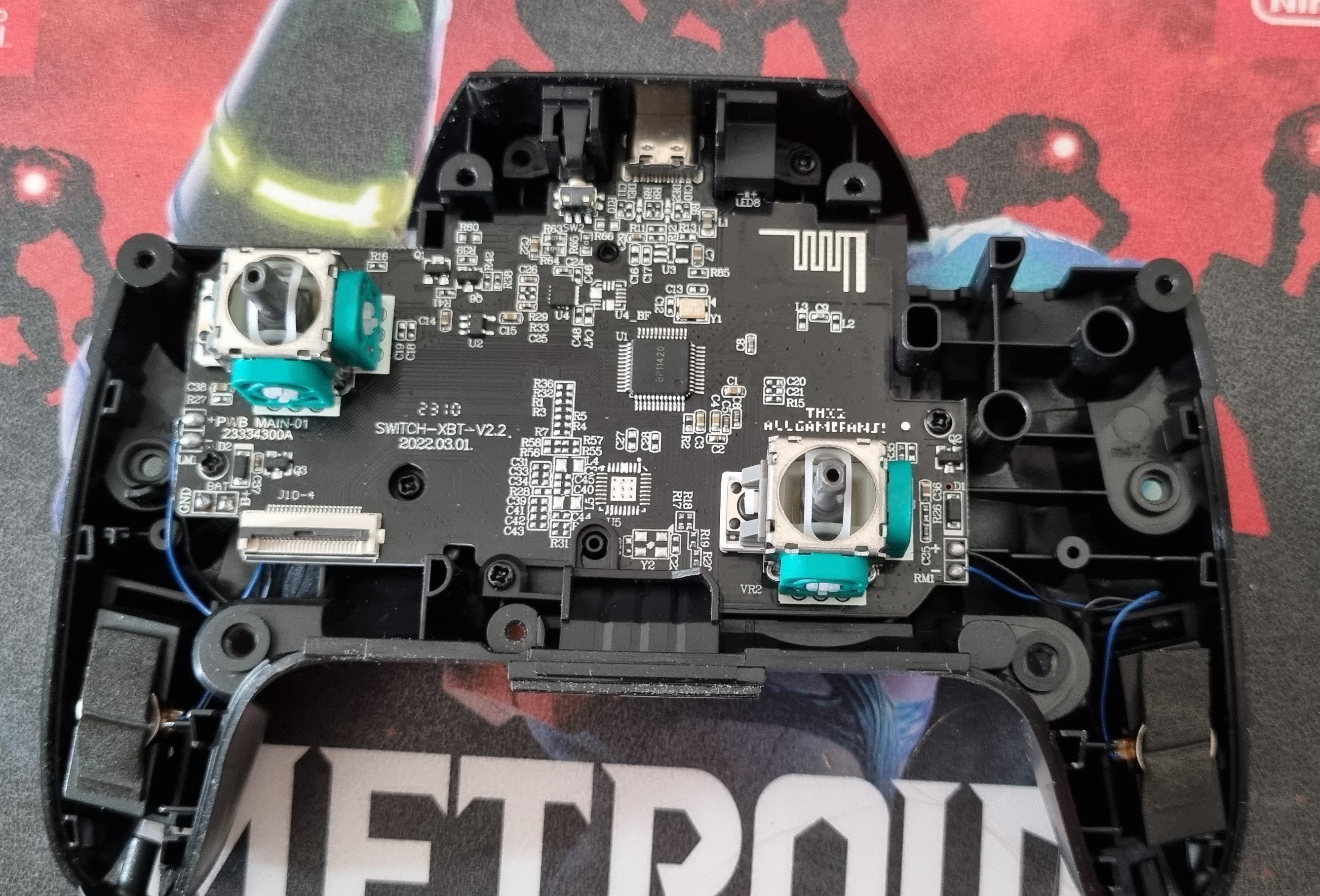

When I would not know that this is a fake then I would think it's original.
Outside seems legit and every hint like missing switch Logo is not there.
Even the Vibration and wake up or sync with cable is there.

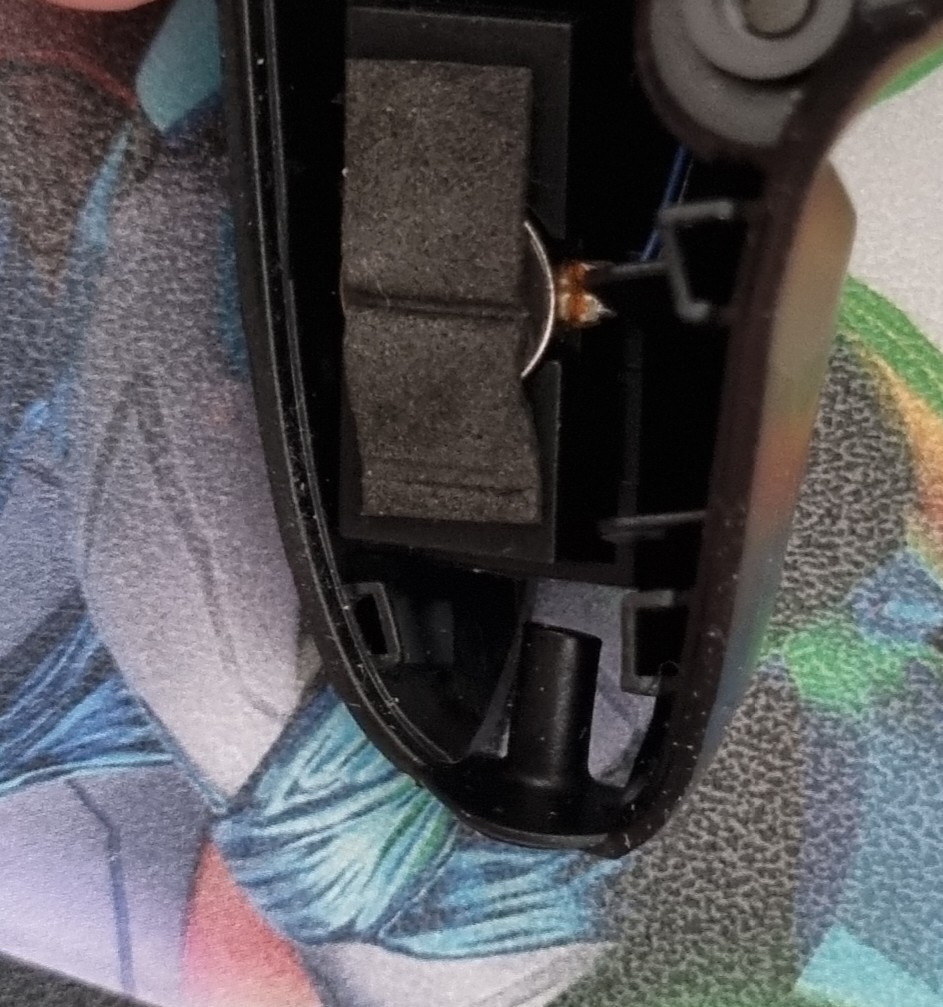

But inside is a Version 2.2 Board and Smartphone Vibration motors

The fake pro controller improve with the latest version!
The board is more like the original and no expoxid Chips.
Very clean and good Hardware.
All works normal and the motion Sensors works fine.
But No Nfc ( i dont need it) and normal rumble.
Normal analog sticks are inside that normal caps or xbox elite caps works.
The Notification LED is missing but There is no Use until now.
I think it can solder in Because the points and resistors points exist on the board.
The Plastik feels really good and i can say good Tool with that the Plastic is made.
PS. Thats my Job to make These Tool to Make Plastic parts.
I think they Use the Same Tools for it like nintendo but only without nintendo Insert.
Only the switch logo on top is missing and the nintendo Logo on the bottom.
The screw are the right too and they had the secret Message too.
All other imprints are There like Support.nintendo.com or made in germany. [emoji1787]
I will try to solder HD rumble on it to See what happens.
Cost 21€.

So I replace the old Vibration motors against these
Like in the newer clone and the are more natural and not loud
