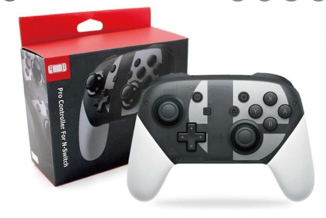

Hello I have a problem when updating my controller, the controller does not go into "update mode" when I press the HOME + X + Y buttons and nothing happens, the light stays as if you connect the controller normally to the pc, please I need help.
I tried with the other update pressing the L3 button before to connect in the pc and theres no lights in the controller when its connected but the "Update Firmware" stays off and I can't clikc on it,
My controller are the "Fake Pro controller" I have one Smash version and one normal black version, but both are "Fake" or "Clone" version, I hope your answer, thanks :cry:

I was referring to "update mode" pressing the HOME + X + Y buttons or pressing vertically the left stick because that what the roxas10 user wrote before, which is to update the controller and thus, the console would recognize it to be able to play.
this is a photo of my control that I mean :sad:
