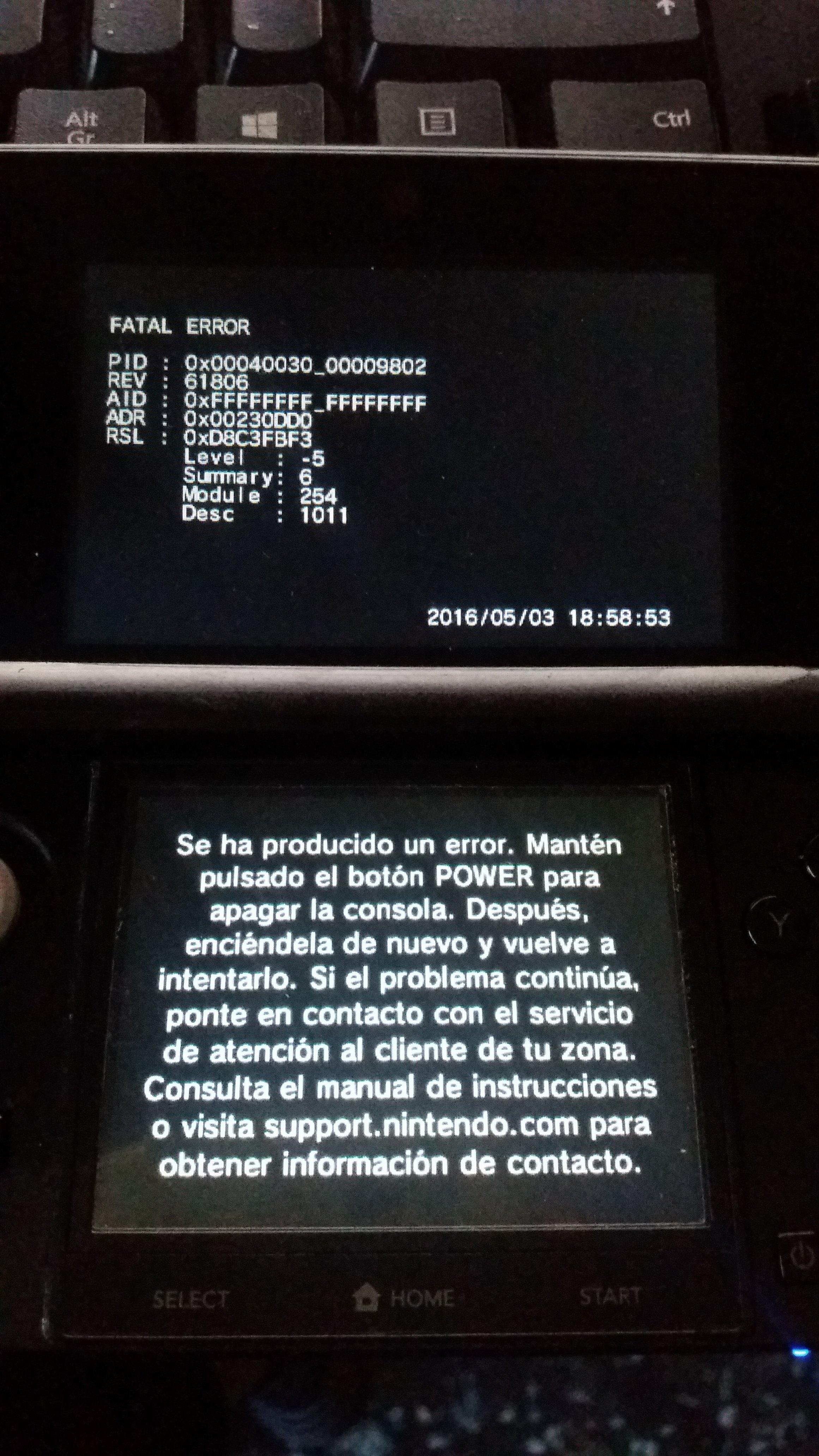

So recently, a ncch with TID: 0004000100000002 came into my hands. It is the factory NATIVE_FIRM. I extracted the FIRM partition from the exefs and checked for the hashes. They match! So we got a Factory firmware. I tried launching it with Luma3DS, but crashed with the attached crash dump. I also noticed that the block 0x920-0x11FF is filled with "FF" bytes :unsure:, that is strange as other firms doesn't have that block. So is this firm possible to launch with Luma3DS? (I can't share it because GBAtemp rules)

I already answered it on DSHack.org, but just so others can see it:
Level        LEVEL_PERMANENT (リトライできないプログラム エラーです。)
Summary        SUMMARY_NOT_SUPPORTED (対応していない操作です。)
Module        MODULE_APPLICATION
Description    DESCRIPTION_OUT_OF_MEMORY (1011)
Brief        メモリが足りません。
Long story short: Insufficient RAM.

Well, it is an intentional crash :P
