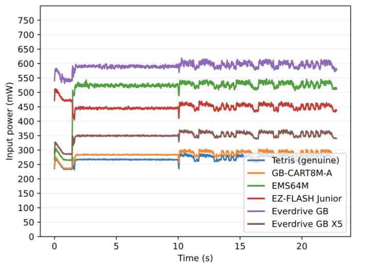

i dont like to read 63 pages. in case nobody posted the power comparison before, here it is: D117FF56-E5B2-4D00-8668-FE5A0D768746.jpeg
source: https://gekkio.fi/blog/2021/power-consumption-of-game-boy-flash-cartridges/
With my setup my battery lasts ~4h. (Pocket+EZ-Jr.+IPS+DK land in demo mode+1000mAh LiPo+full brightness).

How is the battery consumption of EDGB v4 compared to the ezflash jr? I'm playing Pokemon Yellow in a modded gbc with ips v5 and I'm facing some issues to load the save when the AA battery is low (after around 4 hours of play).
The EDGB is better. It's reportedly not as good as the official X series, but I can't confirm that personally.
I casually tested power consumption in Pokemon Red's title screen with a cheap USB ammeter and DC input adapter and got the following current measurements. The meter wasn't very precise so these are only ballpark figures.
Bootleg cartridgeEDGBEZ Flash Jr
Game Boy Pocket0.05A0.06A0.09A
Game Boy Color0.02A0.04A0.05A
EDIT: I'm curious, is your Pokemon Yellow an original cartridge? Some bootlegs are known to draw a lot more power than usual while they save.
The Everdrive clones are clones of the old Everdrive GB from before krikzz made the X series. They even use the old firmware files of the non-X EDs. Not sure if the chinese knockoffs improved anything since then but i would not trust them to have lower power consumption than the terrible, genuine one shown in the graph above.
The X7 is definitely very good but watch out for the microSD. I found that some microSD cards hog much more power than others. You can compare by how much the power LED of your Game Boy dims when the microSD is accessed.
