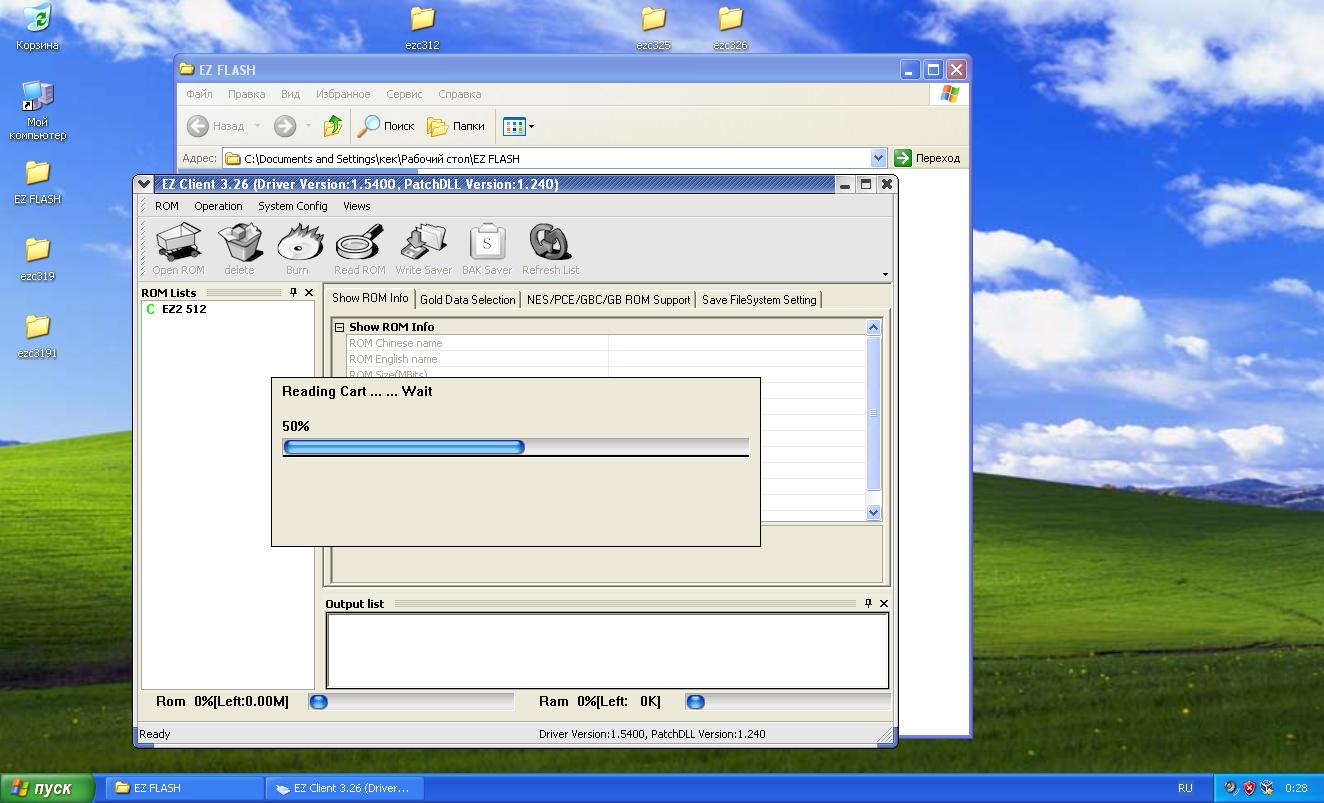

Hi everyone!
Have some issues with old one EZ-Flash 2 (512 Mb), which i try to use with VM (WinXP SP3). I've tried to burn some ROMs with EZClient 3.26 (driver version 1.540) but every time I'm pulling cart inside the linker it's just stuck on "Reading Cart. Wait" and its always 50%, nothing else.
I've tried to change diffirent drivers, different EZClients, but result is always the same. Light on linker is red when cart inside, and blinkin between orange and red when its outside.
Pls haaalp.
It appears to detect it as a 512 so there is at least that.
Have you tried cleaning the contacts?
Yeah a cotton bud and some kind of solvent that won't leave anything behind. If you have one of those fancy fibreglass pens then that is also good. Some also do OK with a pencil rubber (make sure to go with the pins rather than across lest you pull a trace up).
