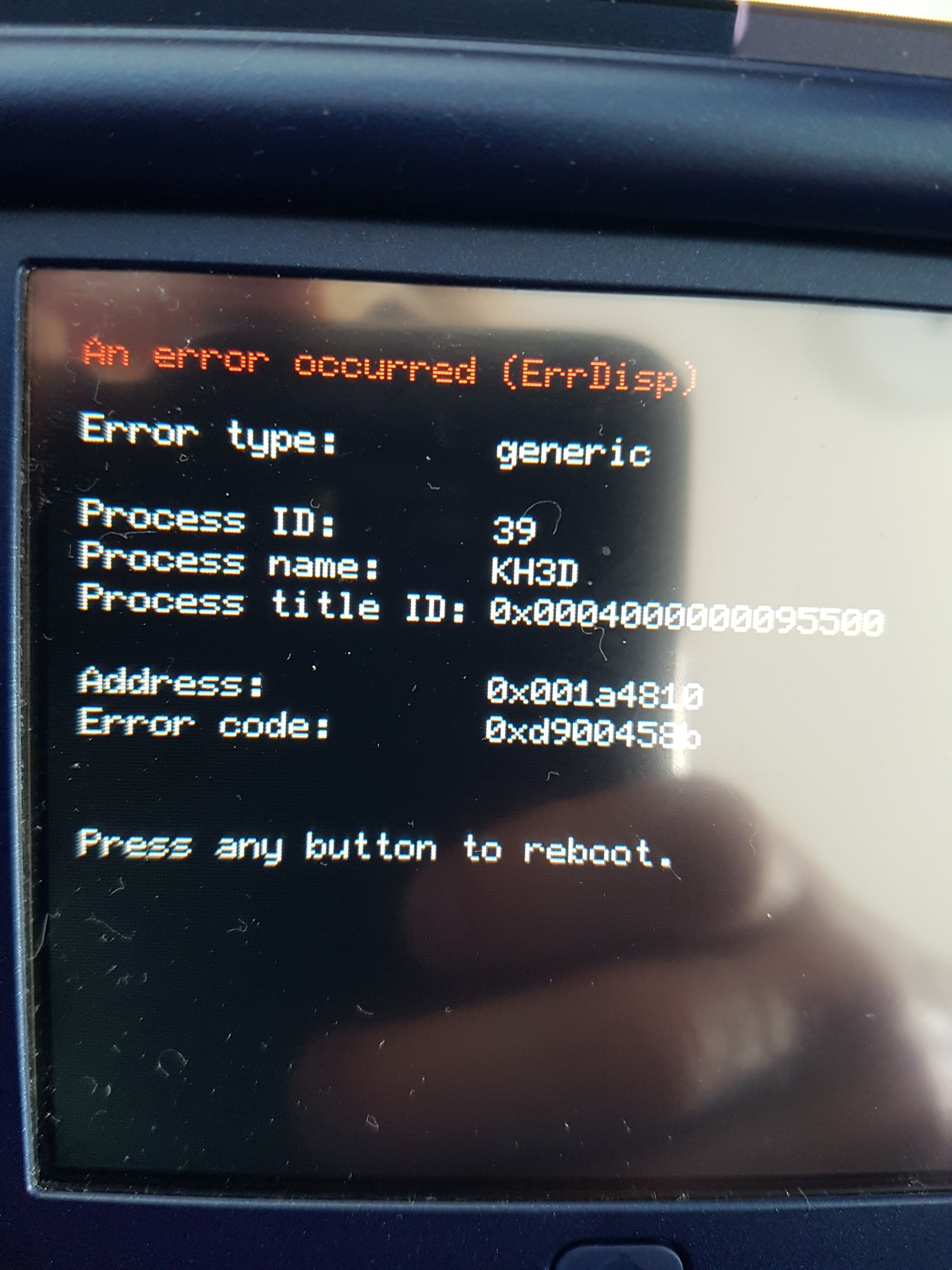

Hello.
When I use my 3DS, games frequently crash giving me a screen stating 'An error has occured (ErrDisp)' and 'Error code: 0xd900458b. I've tried to solve the problem through a lot of different method, without results. What does the error mean and how can it be solved?
Thanks in advance.

Could be a bad or corrupted SD card, where did you buy it?
What game did this error appear on?
The error appears on multiple games, but in this instance on Kingdom Hearts.

Try running Check Disk on it.
Could be a bad dump too. Did you get the games from NUS (using FreeShop, FunkyCIA etc) or elsewhere?
Reactions: ArviDroid
The error coresponds to invalid Romfs or savedata hash. It could be a corrupted sd card, or it could be files on the sd card itself...
I've thought about this and I've formatted my SD card and pasted back my files. If anything there's corrupted files on the SD card but I don't know how to determine which one(s).

I should mention that windows stopped working twice while moving files with the sd card a long time ago. Maybe some files got corrupted then?

copy everything off the SD card, make backups of your save games and extdata with Checkpoint and copy them off,
format the SD card and test it with https://www.heise.de/download/product/h2testw-50539
Maybe redownloading the games from FreeShop would help.
Also I assume you're on the latest Luma and firmware version?
I've redownloaded the games with the error. For some games the error always appear at a certain time and by redownloading I can get past the error. The problem is that it'll appear somewhere else/ randomly as I play instead... Yes, I have the latest luma.

Running h2testw like Hunter said might be a good idea then. But run Check Disk first.
Check disk said that there was nothing wrong!

I can't think of any other culprit than the SD card at this point. Windows has warned many times that the SD card was damaged and then has repaired(?) it. Also, I've formatted it, without the problem being resolved; perhaps a corruption can't always be resolved by formatting?
