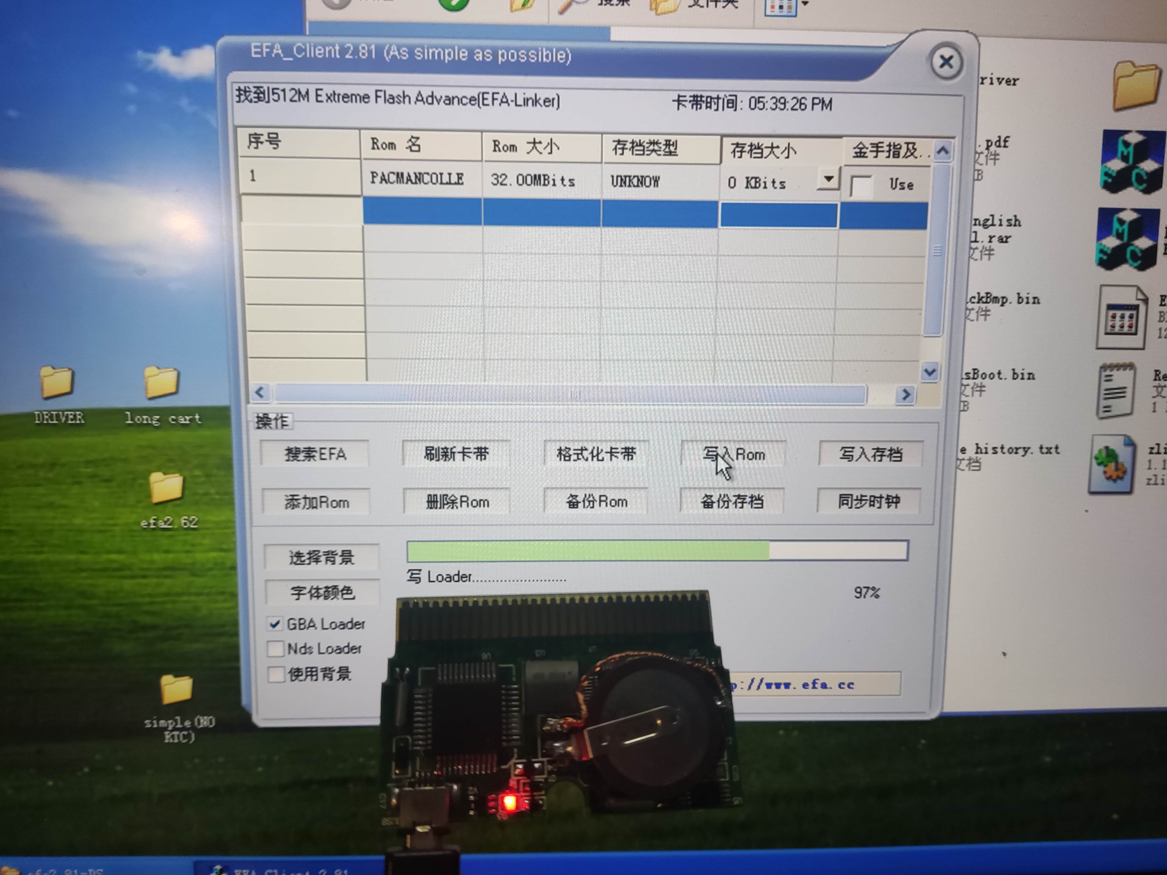

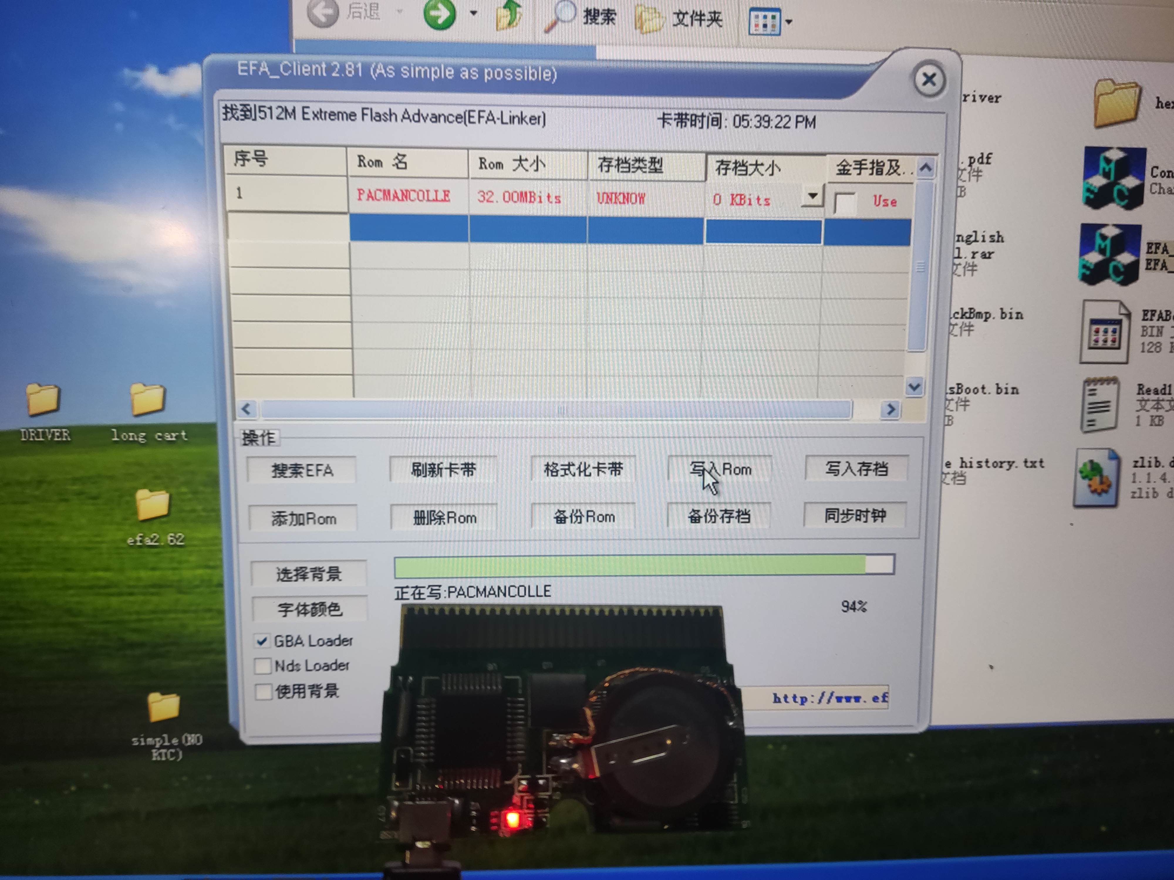

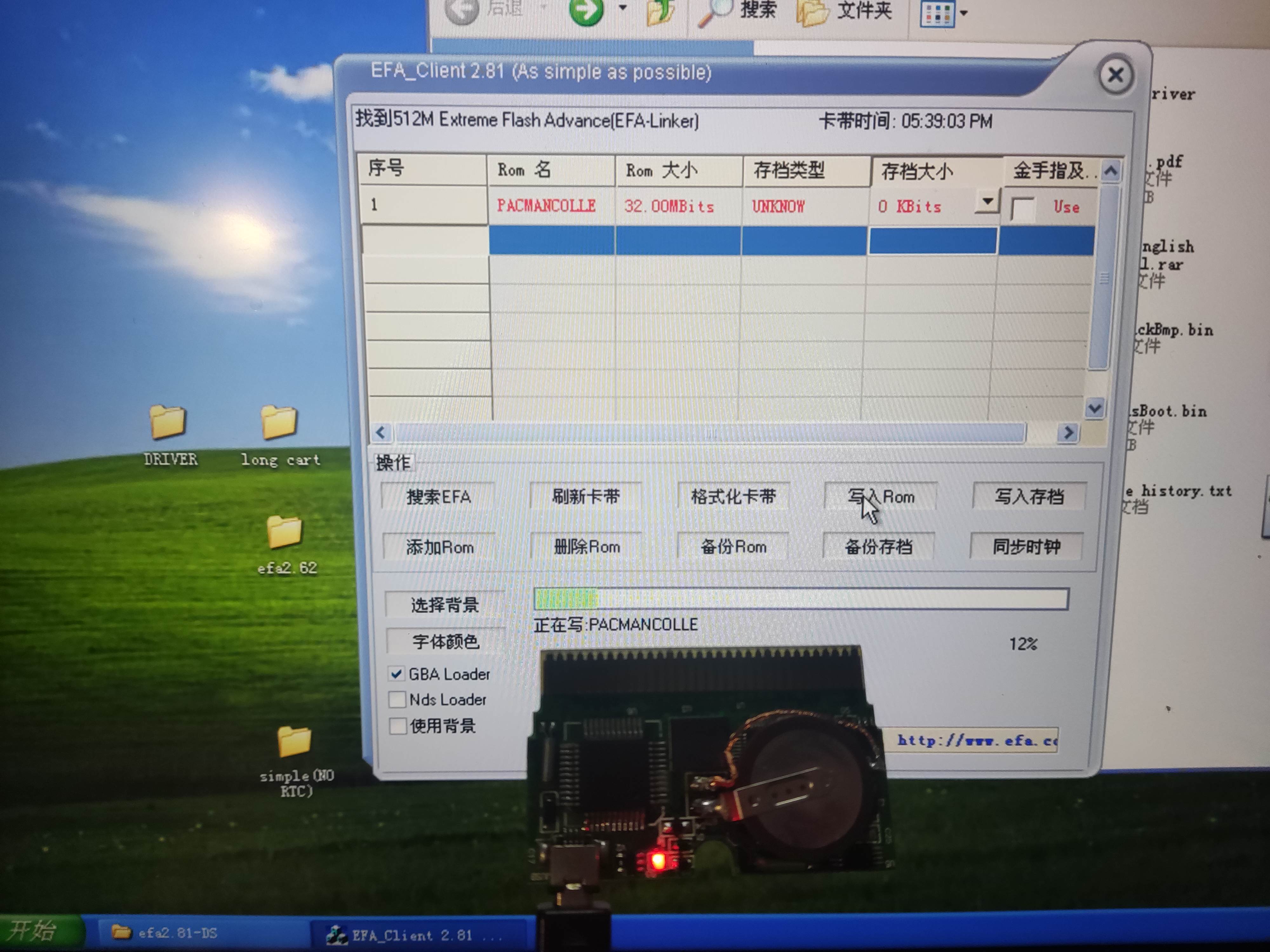

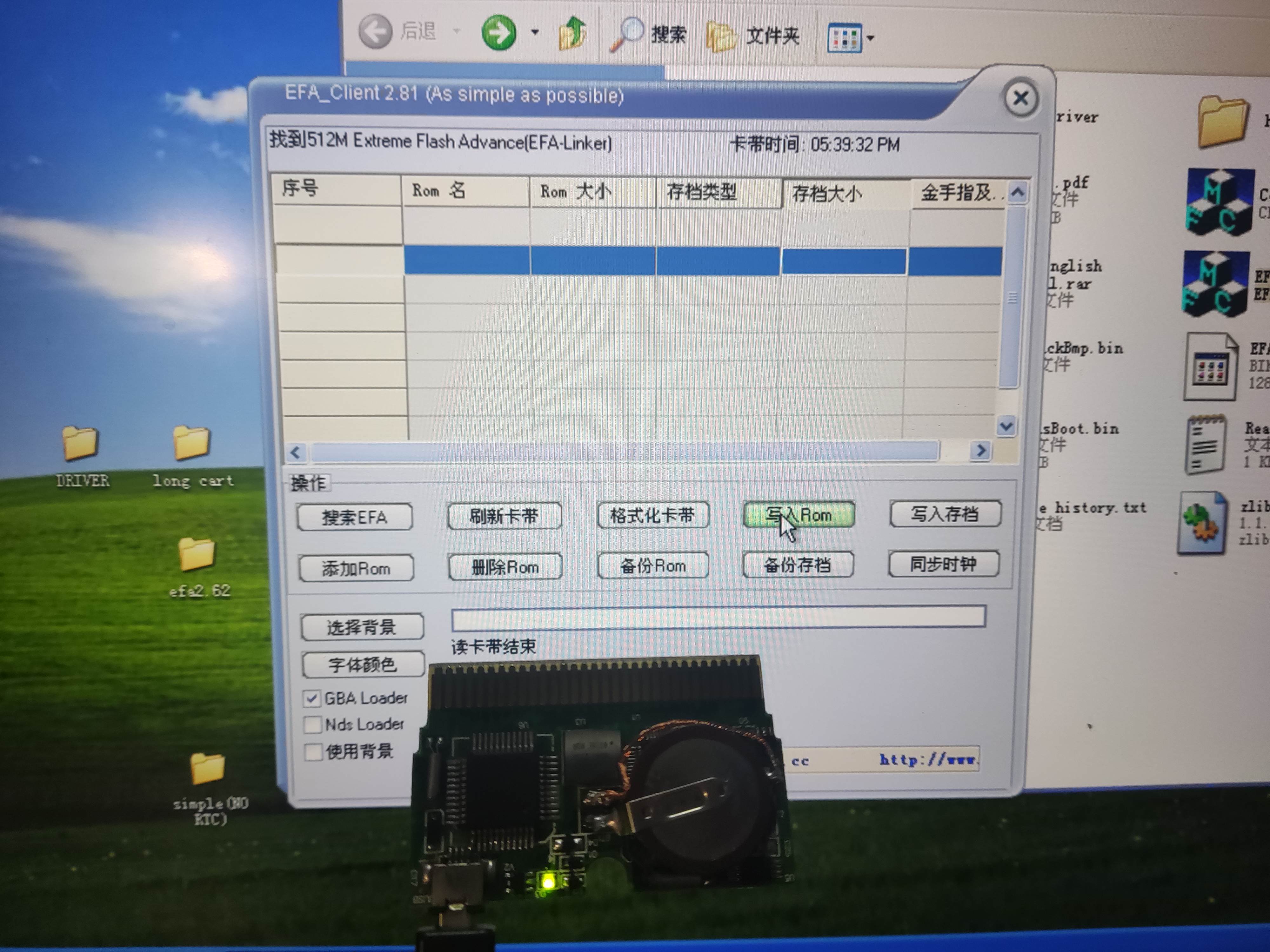

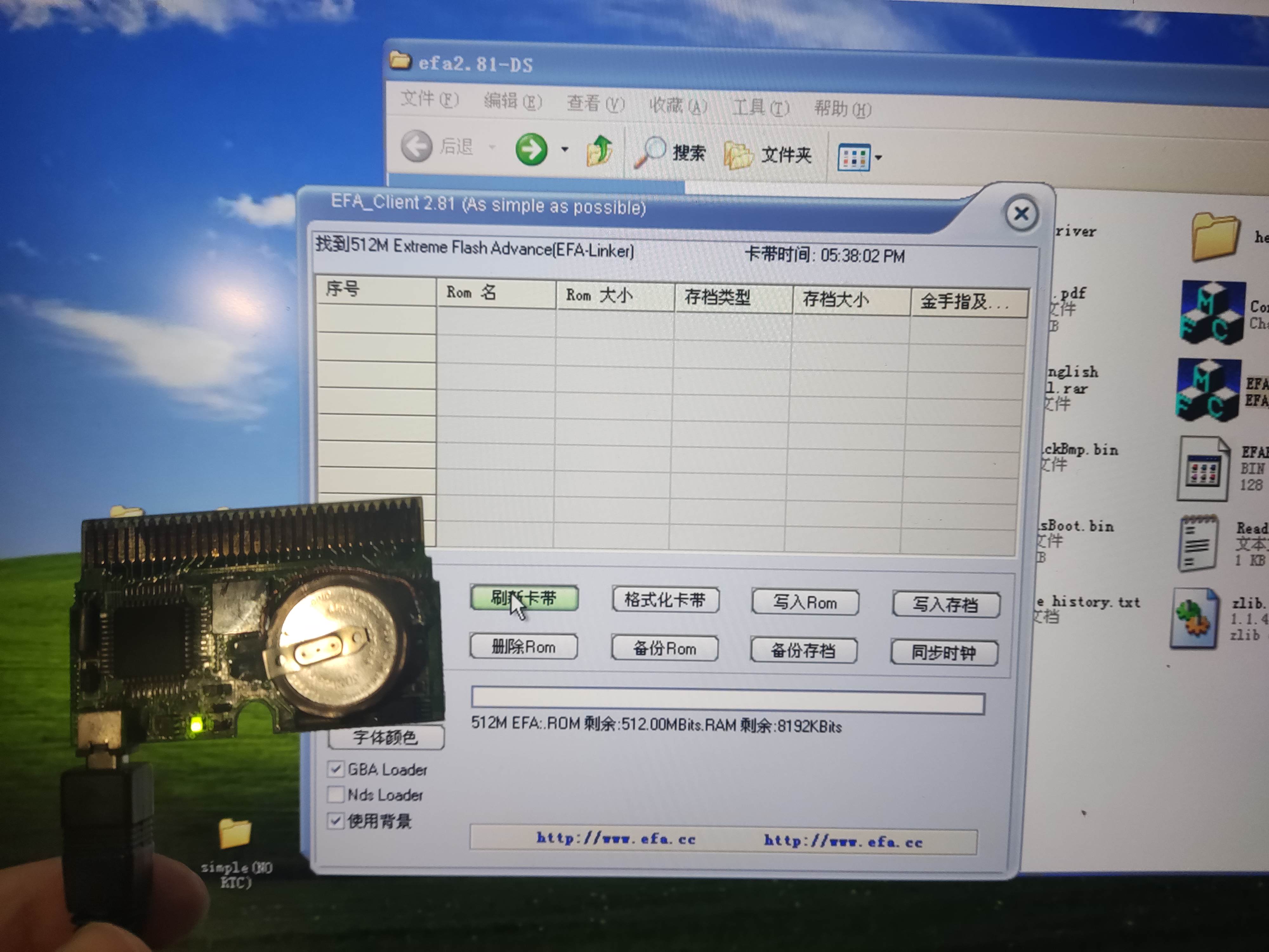

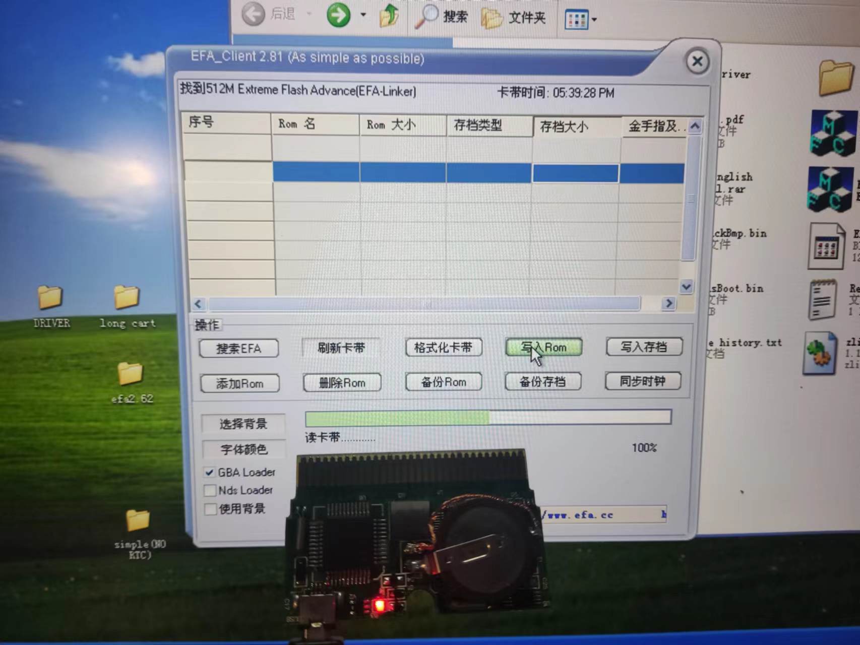

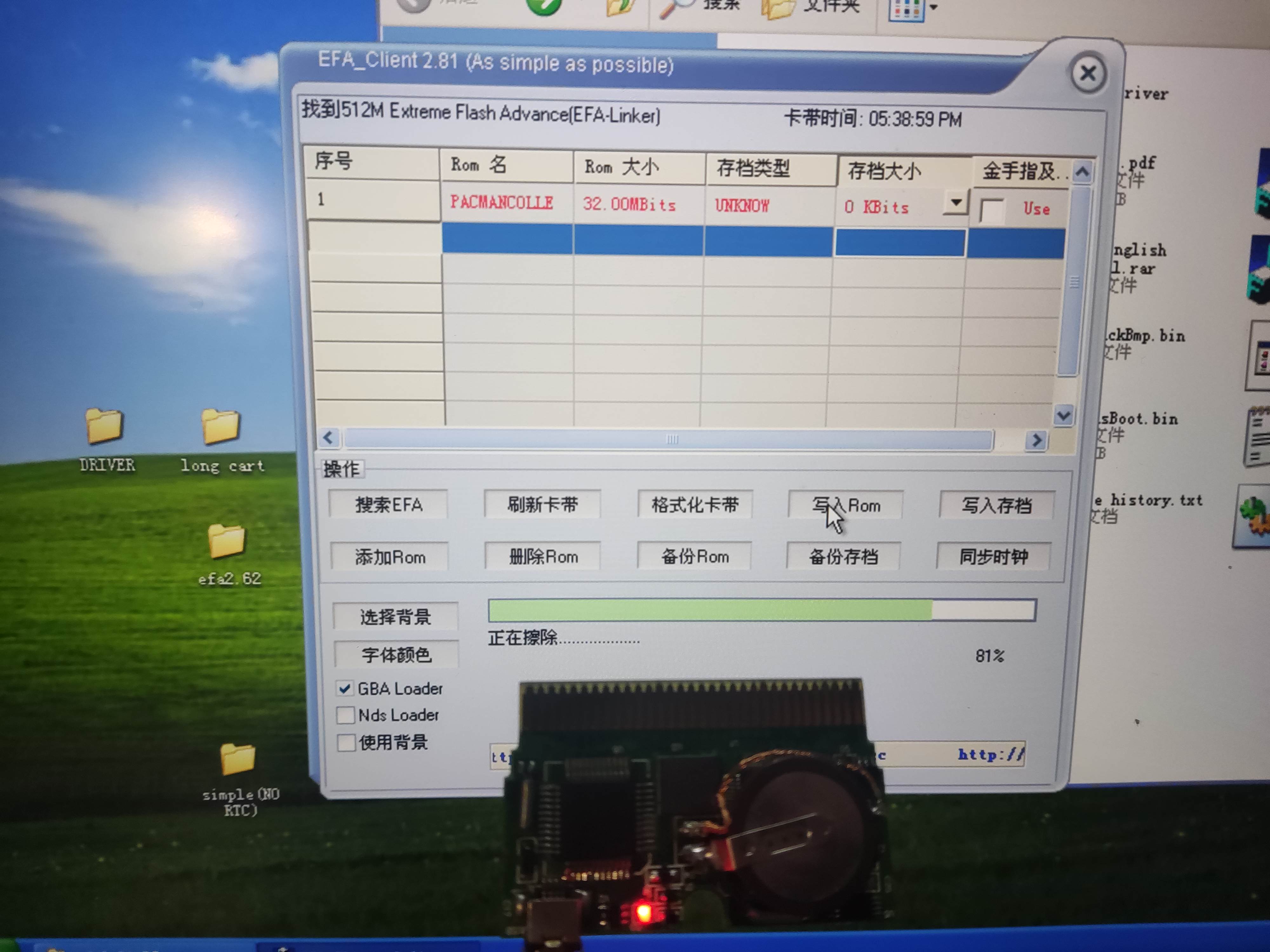

Here are some photos I took after I replaced the battery.
as you can see, I tried to write a small early rom into it by using 2.81 (I tried 2.83 later too)
I refresh, it's empty, I add rom, click write rom button, everthing seems going well, and bam, still empty:unsure:
