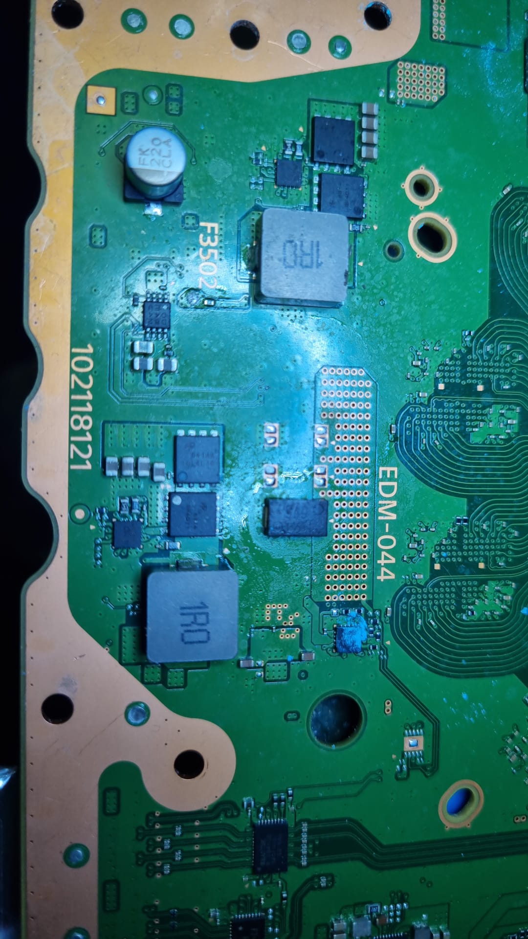

I have a short in this 336s MOSFET, but I can't find it anywhere by that part number. Can someone please help me? It's a PS5 Slim EDM-044.
I also need the value of F3501. Is it 10A? Because I can't find one in size 0402.
thanks
I already found the component of a donor plate, I don't have a short in that area but I still have the same error

I've checked all the phases, I have the 12V, but when I turn it on, I don't have the 0.90V that powers the processor. It doesn't even try to start when I press the power button. I replaced the XPDE chip just in case, but I'm still having the same problem. I lifted all the coils, but there's no short. With the thermal camera, I see that all the RAM modules power up, but not the APU. It seems like the APU is dead. Any ideas on what I can measure? I've been measuring and watching videos for over a week, but I can't find the short.
I've only noticed that in the area of the F3502, I only have 12V, and the 5V drops when I turn on the power
