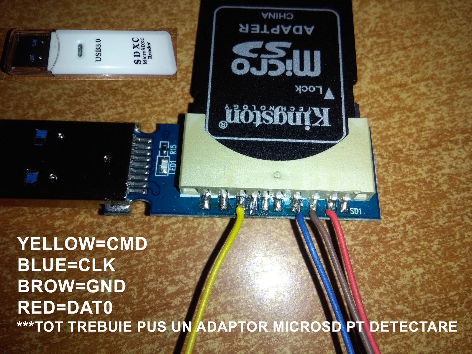

I used this card reader (the white one) and it worked:
https://www.aliexpress.com/item/MIN...044.html?spm=a2g0s.9042311.0.0.27424c4dKfdY0n
But every time i tried to open a micro sd adapter, the plastic broke. So I soldered the wires directly into the card reader (it still needs an empty micro sd adapter inserted for detection).
Thanks for the recommendation, that's the usb 3.0 version of the reader I used, ordered one as a backup. Pin 3 has two contacts so it can detect if a card is inserted, you can bridge them so you don't have to insert a card for it to work.
