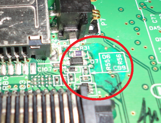

On the thread you posted a couple of pictures of a mark on the motherboard,
dsc021232-jpg.34101
Looking at that - it looks like it's had liquid spilt on it at some point, the problem is with liquid damage sometimes things start to have a mind of their own and will work sometimes but not others, so it could be any of those chips to the left side of the mark, sometimes turning a device on after it's been wet can short the circuits
this spot today looks like a "bubble ".. I think I can remove/break this easily like an egg (?) to see how it looks inside there but I'm afraid :v I really can't imagine how liquid entered there :v but coming from the owner of this... well idk XD
Looks like somebody installed ARM9loaderhax onto it! These things are notorious for being easily breakable if not handled properly/with care.
With that being just to the side of where the battery goes - the battery could have leaked ?
