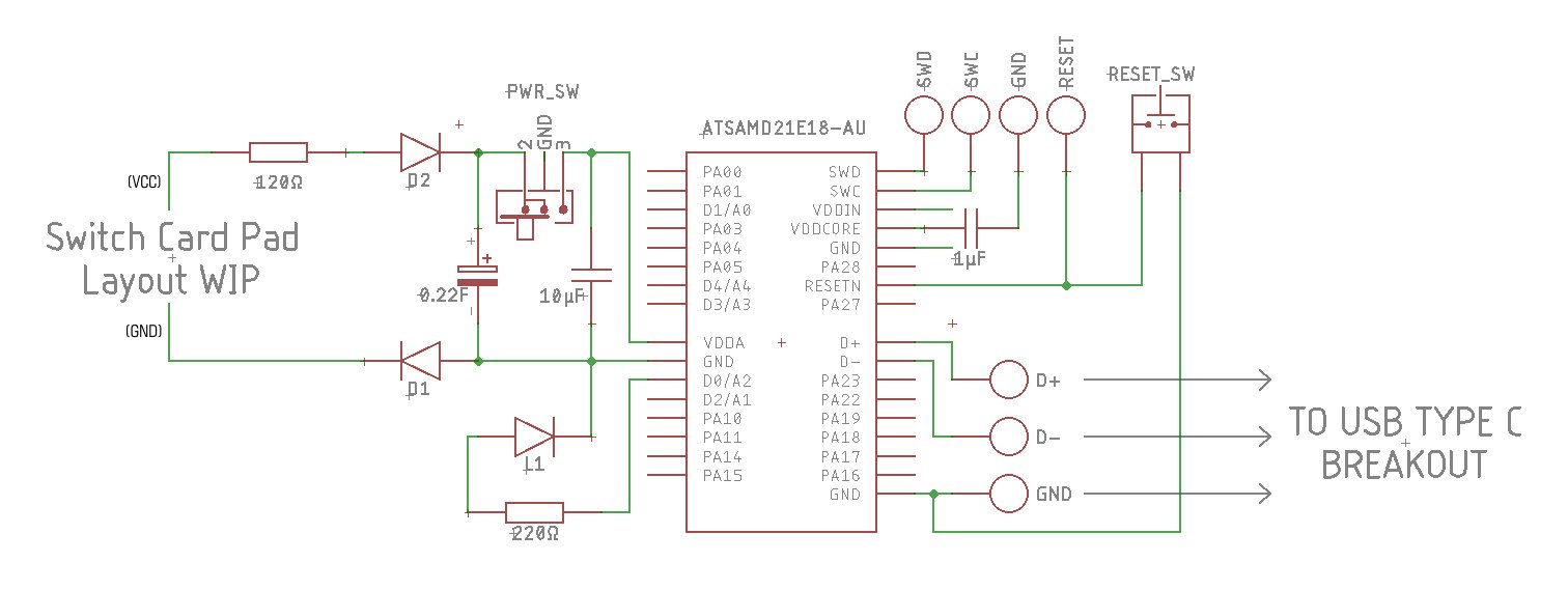

Update time.

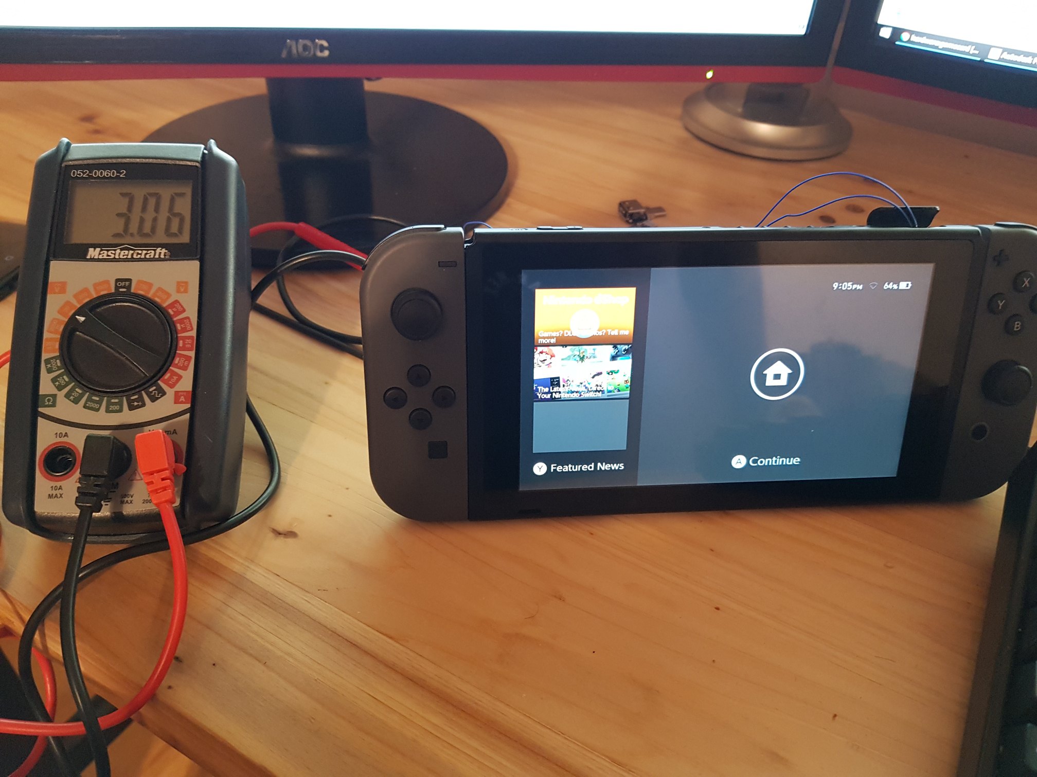

While the PCB designing and fab went well and I have a bunch on the way here right now, getting the case prototyped has so far been... unsuccessful. The issue is the miniscule amount of space and the details the case requires. I only had ~1mm extra to work with for length and width when designing the case, which meant a wall thickness of 0.5mm. This is fine (albeit just barely) for injection molded parts made of strong plastic, but for the prototype I've been poking local makers on 3DHubs who have SLA printers (UV cured liquid resin), since FDM printers like mine (that shmoo out hot plastic) aren't accurate enough for this. So far every attempt has resulted in a failure printing either the cover or the case due to that itty bitty wall thickness, and getting the board even this small was like playing entropy bingo for a day. Moving stuff a few mil at a time and seeing what that broke and then moving that new broken thing. Rinse, repeat. The board just isn't getting any smaller at this point with it's current assortment of components.
HOWEVER. Last night I committed the sin of dissecting the most revered game on the Switch, as currently as it's the only cart I own. I'm talking of course about the wonderful Aqua Motor Racing Utopia. I know this hurts us all, but remember, it was for science.
Anyways, I soldered up some magnet wire onto the 3.3V and GND pins, routed them out of the back of the cart, stuck the other ends across my multimeter and wrote down the behavior of the card slot under a variety of circumstances:
1) When the system is in sleep/standby mode, the 3.3V supply is OFF.
2) The slot is powered immediately when resuming from sleep mode. I measured a constant 3.06v.
3) When entering sleep mode, the game slot is powered down for around two seconds, then receives power again for around ten seconds for some reason. It then powers down for good until woken from sleep.
4) When turning off the console, the slot is powered down once the screen backlight turns off, with no resumption of power until the console is booted once more.
5) The card slot is NOT powered in RCM mode. The slot does not receive power until Horizon is loaded and you see the lockscreen appear.
So, there's good news and bad news here. The good news is that I can hijack the 3.3v for stuff when the Switch is on without fear of draining the battery when it's in standby mode or off. This means I can ditch the battery for a supercapacitor! The bad news is that there's no power in RCM mode. This means that AutoRCM would be a Really Bad Idea™, because if your dongle died you would have no way to boot the console to charge your dongle so you could boot the console to charge your dongle. My angle is that if your RCM jig is built into your dongle, you don't need RCM anyways. If I'm missing an important use case however please let me know.
Moving forward, it turns out that supercapacitors are actually pretty easy to charge and implement if you know your supply voltage will always be consistent. A simple resistor and a diode are all that are needed to limit the charging current and protect against reverse voltage discharge when your input voltage goes low. If anyone would like, I can break out the math, but the short of it is a cap that's about 2/3 the size of the CR1616 I'm using in the first board will work just as well. On a full charge it will last for over an hour with the dongle in sleep mode and be good for a couple dozen payload injections. I'm limiting the current the dongle can get from the Switch to 25mA and even at that miniscule amperage the cap should charge in just a few minutes. This should be well below the current a normal Switch cart needs. If you're wondering what effect 25mA will have on your battery life (remember that the card slot only gives power when the system running, current drain is 0 when in standby or off), the Switch has a 4310mAh battery pack @ 3.7v. 25 / 4310 is 0.058, or about half a percent of your battery life for every hour the Switch is running on battery.
So that leaves me where I am now, which is making a new PCB. The schematic is already done. Thanks to the supercap being substantially smaller than the battery, I should be able to add enough meat to make the case printable on an SLA (and possibly even FDM) printer. Day job runs long this week so it will likely be late Friday I'm back here with shiny renders of the new design.
Attached is the current WIP schematic for those interested as well as a picture of me violating my switch with magnet wire.
View attachment 137140 View attachment 137141
"So, there's good news and bad news here. The good news is that I can hijack the 3.3v for stuff when the Switch is on without fear of draining the battery when it's in standby mode or off. This means I can ditch the battery for a supercapacitor!"
yeah when i 1st saw this i was going to suggest you crack open and RE a SX pro dongle and use super caps
but from you post it looks like you are over complicating it by trying to add pins to your cart case to charge the super caps
i mean why not just do it the way that TX does and use the power from the USB C to charge the super caps ,this way less battery drainage while the switch is on and the card is in the slot.
Also i notice SW1 and SW 2, what is SW2 for exactly? is it like reset button for the board like on an arduino?
i get SW1 is for disconnecting the CR2032
of course TX dongle uses no switches and with supercaps there is no need for SW1 to disconnect the battery anyways so that frees up more precious real estate right there
guess SW2 would still be needed ,but seems like it would be easier to just charge the caps through the USB C and not from the cart slot IMHO
This would require you to have the dongle plugged into the USB Type C port on your Switch while gaming if you needed to charge the dongle on the go, which is not ideal. It would also mean you would have to charge it in a different piece of equipment while the Switch is docked, and then remember to take it with you each time you went out. It's actually quite simple to get the dongle to charge via the card slot so I see no reason not to. The pinout of the slot was known months ago and 30mA is more than enough to charge a small supercap.
That said, with the updated case I'm finishing up I had a good bit more room to work with and a rechargeable power source makes a higher current draw less of an issue. I've added the DotStar LED and the LDO back in as a result. This means we can charge from either the USB Type C port or the card slot, and it also means I don't have to fork the firmware already available.
The main reason I did this is because I realized it would be a pain to have a small window to update the dongle when plugged into your PC, as the supercap would drain in well under an hour with the MCU at full power. Now you can take your time updating the payload and it will charge at the same time. I will be posting another update tonight with the details of the new design.
SW2 is indeed a reset button, required to put the device into bootloader mode so you can load your payload or whatever code you wish. I don't have a TX dongle to reverse engineer, but the caps in the photos look significantly larger than would fit in a cartridge form factor so I doubt power is much of a concern for them. Based on the dimensions of the TX dongle, it's probably a pair of 1F 2.7v caps, which would have about 10x more life than the 0.22F cap I'm using. (Entertainingly, the press render they put out states the caps are 500F caps, which would make the dongle bigger than your Switch!) Most likely they are extending the life even more with a sleep cycle - something along the lines of powering up every few seconds and looking for an RCM Switch, then going back to sleep. I'd be interested to hear about the battery life of the SX dongle from anyone who has one, as well as if you notice a delay sometimes after you plug it in for the payload to go through.
Reactions: Darksabre72
"This would require you to have the dongle plugged into the USB Type C port on your Switch while gaming if you needed to charge the dongle on the go, which is not ideal. It would also mean you would have to charge it in a different piece of equipment while the Switch is docked,"
well i have a SX pro dongle but i have not even set it up yet
but from what i understand that is not how it works at all ,i thought that the dongle can charge itself through the switches USB C port
and that it can also be charged with the micro USB female connector on the dongle but that that is not really necessary since the dongle can charge itself through the switches USB C port in something like just under 3 seconds and have enough juice to dump the payload
i though i read that you can charge it from the female micro USB on the dongle and that will get you like 10 payload injections with having to wait the 2 or 3 seconds to charge the dongle from the USB C port on the switch
maybe i am wrong but i could swear this s what i read if anyone else who uses their can chime in and let us know
but i am almost positive that is how it works
so even if your caps are smaller that TX , TX caps and hold like 10 or 12 payload dumps worth of juice
you really only need enough for one , i mean who is really impatient enough to not be able to wait a few second upon rebooting their switch
didn't you say the cart slot delivers 3.3v ? the USB C will deliver 5v so wouldn't that get the caps charges faster? or rewqire more circuitry to lower the voltage?
Also i those pics of the SX pro donlge are only mockups so i would not put too much stock in them we dn't know what they are using in there
and the dongle is really small it fits in a game card pouch in my switch case
maybe there are actual photos now and maybe even tear down video i haven't checked lately
