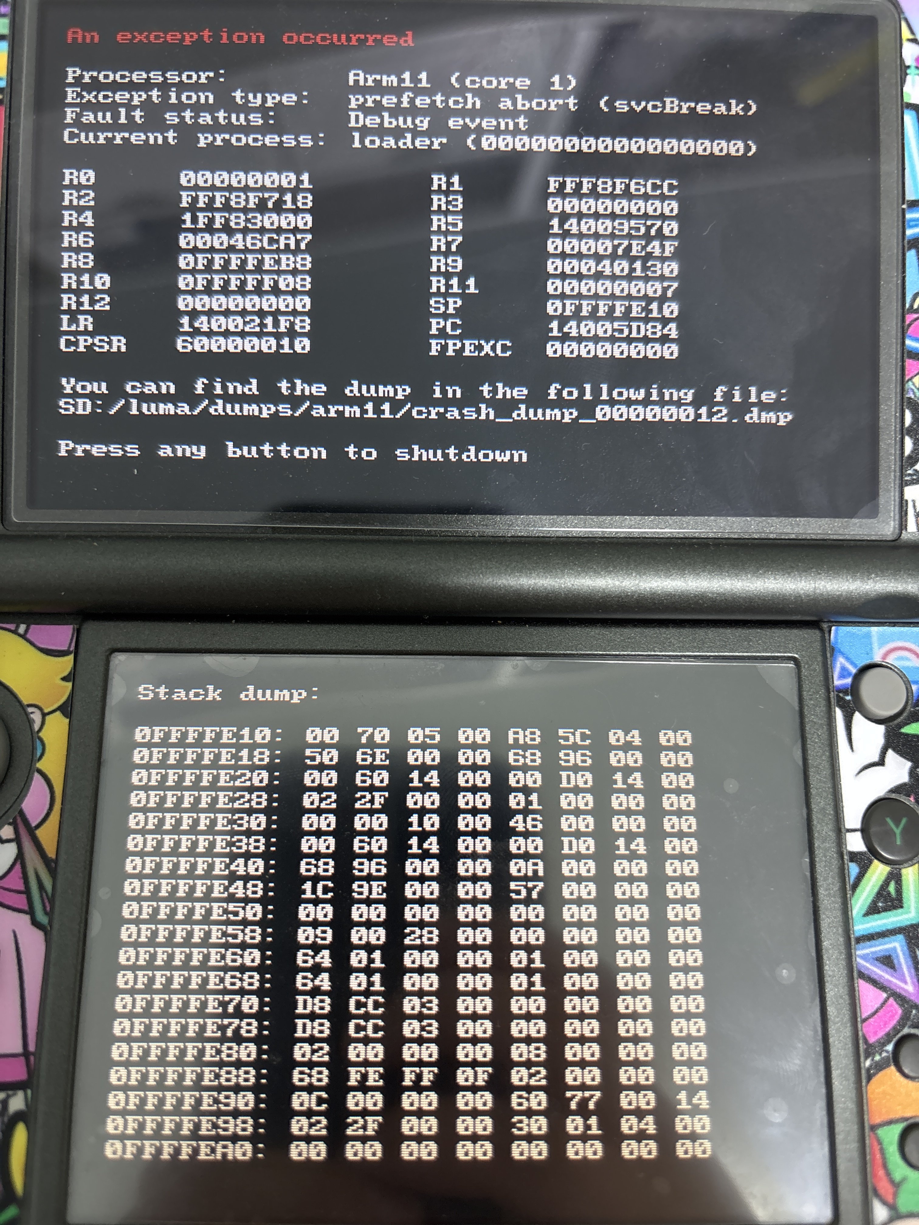

I don’t know why, but my third is stopped working after I wanted to install bax converter I saw the firms were an old version so I just updated them (boot nine strap) but still I keep getting an error message I hope I can fix it fast but here are some things that’s may help you I can put into my 3DS normally without my SD card and then insert it later, but I can’t put it with the card. I got Luma on my console so maybe that’s why. But still, strap nine. I don’t know.

It is very unclear exactly what you did.
Bax Converter is a Windows program, not a 3DS program.
The .firm files on your SD card are for Luma, not boot9strap.
Rename the boot.firm on your SD card, then copy boot.firm from the Luma .zip file at https://github.com/LumaTeam/Luma3DS/releases/latest to your SD card. See if it works then.

The BAX converter is for the 3ds, but it runs on windows.
Just do what @Kwyjor said:
Rename the boot.firm on your SD card, then copy boot.firm from the Luma .zip file at https://github.com/LumaTeam/Luma3DS/releases/latest to the root of your SD card. See if it works then.
If this works you do your thing with BAX, if you screw it up again: do what kwyjor said (again).

All right, some hb apps do not boot. after I updated them no change has been applied. for example when I tried to open hshop it black screened me
But now it works so….. maybe it’s because my date and time in my 3ds’s wasn’t calibrated I had experienced a resetting of the RTC lately when taking out the battery so fixed!
